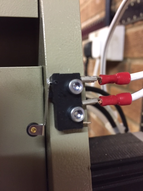

    Hi all, i'm having problems with the wiring of my home switches, mach 3 doesn't seem to recognise them in the diagnostic screen but they are working, but incorrectly, you have to press the the switch a couple of times before the axis stops. at the moment they are connected up open circuit, so when the switch is pressed it becomes live i have swapped the wires but to no avail. I have no idea whats going on and i'm not sure how to configure mach 3 with regard to the inputs and outputs etc
    The switch is a mechanical lever type as shown. any help would be most appreciated
    one wire goes to earth in the control box and the other is pin. pins used are X=13 Y=12 Z=11

    and how have you wired the switches ?
    it looks like you have wired the switches as normaly open
    ( if a wire breaks the control will never see a switch close ! )

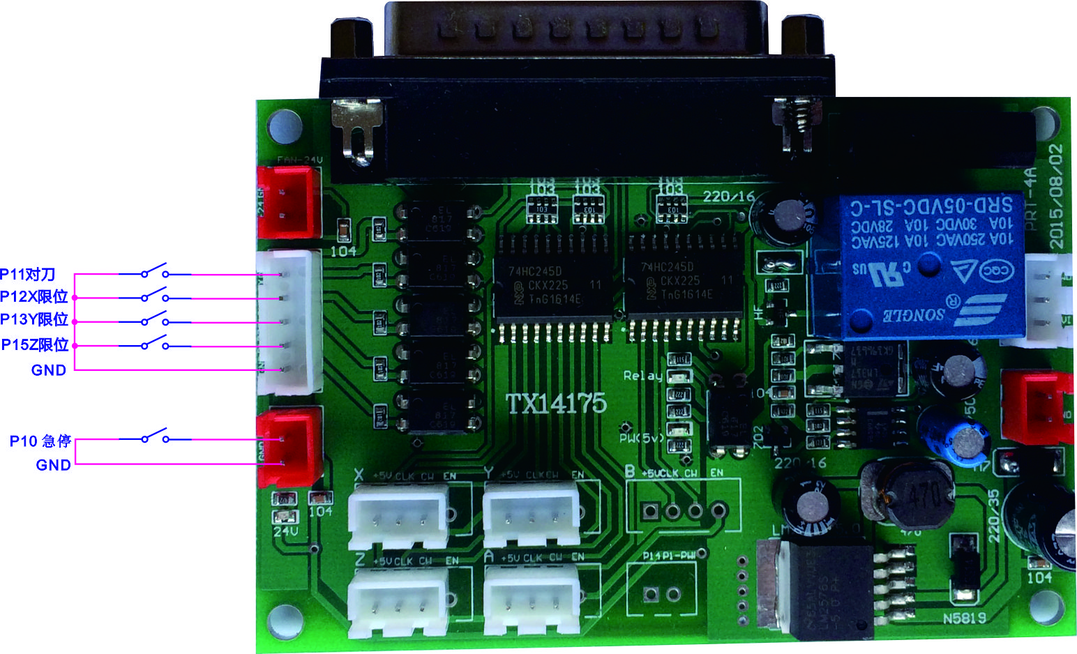

    Hi John the bob looks like this. I have tried both normally open and normally closed

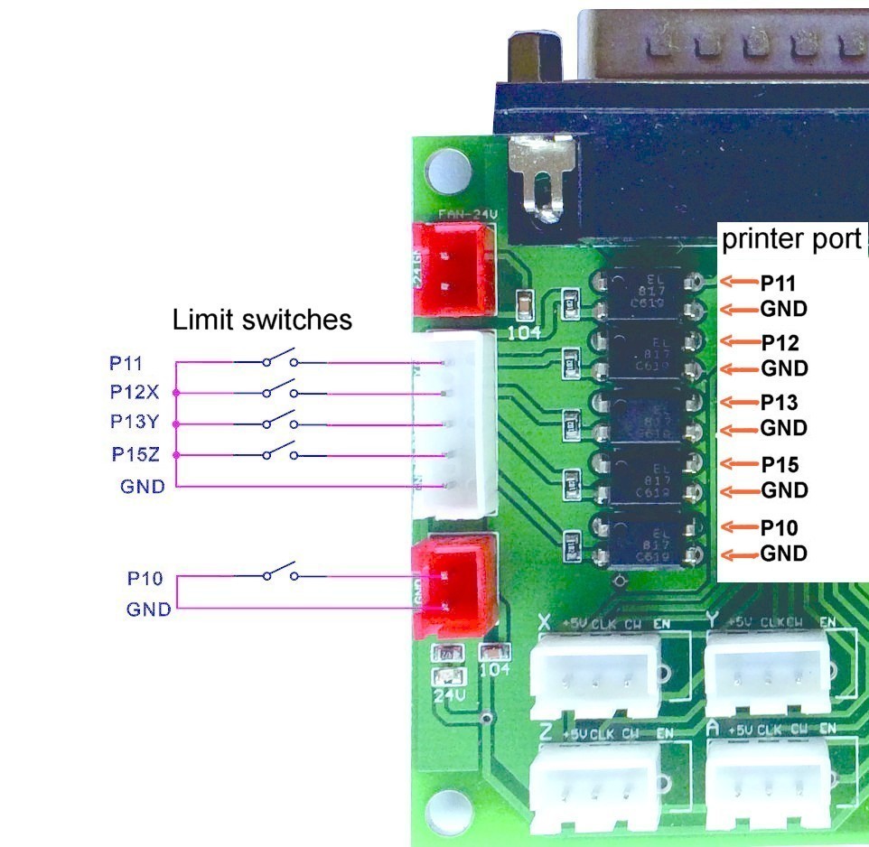

    looking at the breakout boards inputs
Name:	bob opto isolated input.jpg
    when the limit switch is closed, the EL817 opto isolator's NPN transistor will ground the printer ports input pin
    the breakout board does not have any pull up resistors to ensure a printer port input is at a valid logic high when the limit switch is open
    this can be a problem with PC's or laptops with 3.3V printer ports
    John

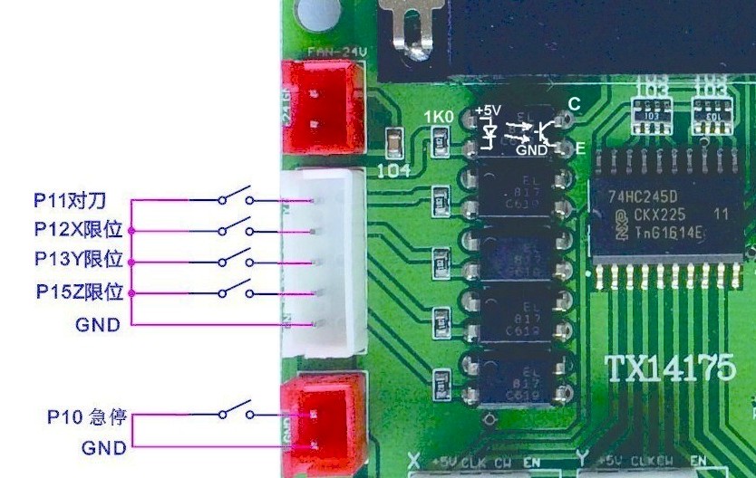

    Hi Kev
    your micro switches are connected to your PC/Laptop printerport via opto isolators
    (opto isolator part number EL817 - the terminal E goes to ground and C to the printer port input pin )
    do you have a multi-meter to measure the voltage change at the printer port input pin when the switch is operated ?

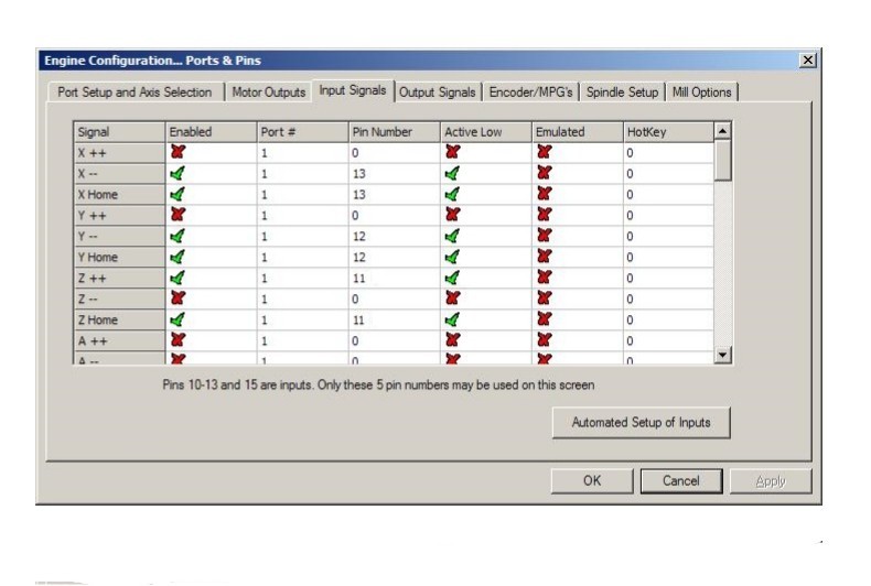

    how have you set up the switches in mach3's ports & pins ?
    any thing like this -
Name:	mach3 home switch  config.jpg
    John
    Yes I've set the ports & pins and I'll check the voltage tomorrow
