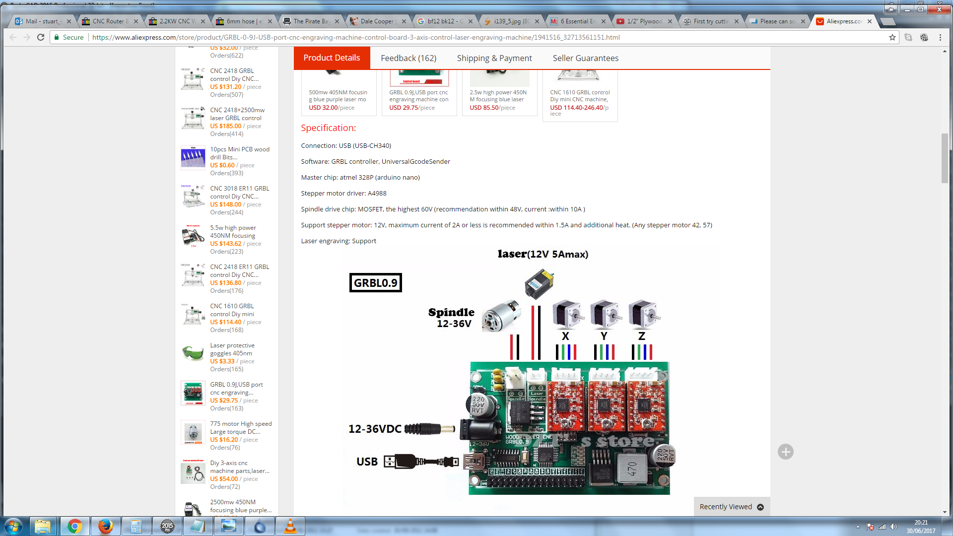

    Here's a link to the board; https://www.aliexpress.com/store/pro...713561151.html
    maybe you do a straight swap ?

    It's just an Arduino nano (Cut down Uno) with the same steppers but more expensive and not in the UK I'd go with the cncshield combo I linked to instead same software, same setup. The only hassle is mounting the board, it does support laser engraving so no features will be missing.
    Basically this board is a cheaper version of what I linked too but actually more expensive and less reliable.

    Before buying any new boards, I'd be trying to get the existing one working again.
    When did the existing board stop working? I.e. Just randomly after being powered on? While running a job? After changing a setting?
    Does the board still show as being connected to the computer? I.e. listed as a COM port in windows device manager?
    I've got no experience with GRBL, but I'd suggest trying to send some commands via a terminal to the board to see if it responds. For a terminal, it's probably easiest to download the Arduino software, as it includes a terminal, and you'll need the software anyway if you do need to reprogram anything.
    If there is no response, I'd then be trying to re-flash GRBL to the board, as something could of caused it to become corrupt, and re-flashing it may get things working again.

    Hi yeah I have checked with board and everything seems perfect with boards nothing is burnt and power is passing by. Only issue is that software has been wiped out from board. I have showed it to one of my mate and he confirmed that.

    Ok so I found out that board is all fine and none of the components burnt and power is passing by normally. Only and I guess main issue is that software been wiped out from its memory. My mate is trying to help me and he said to me that if we can somehow flash this board with software it came with, can do the trick.
    I'm gonna give it a go and if no luck then I will buy that cnc shield board.
    Anyone would have any idea to flash this damn thing? 😢

    You want the Arduino IDE
    https://www.arduino.cc/en/Main/Software
    there's a few guides on flashing grbl to the arduino follow any of them.

    https://github.com/gnea/grbl/wiki/Fl...-to-an-Arduino
    Were you supplied a pre-configured .hex file with the machine?
    V1.1 is the latest version, however I'm wondering why the PCB specifies 0.9. If you got sent a .hex file with the machine, I'd use that, as it's likely to be already configured for the machine.
    Older versions of GRBL can be downloaded by scrolling down this page a bit - https://github.com/grbl/grbl
