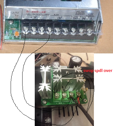

    Quote Originally Posted by ravihotwok View Post
    They say motor - &+ so I think I wired these up wrong, think these are supposed to go to the actual spindle?
    Yes those are supposed to go the spindle, no biggy just swap them to the correct terminals on the PCB.
    Do you know what the draw is of the spindle? I would advise against running that new PSU for the spindle through that On / Off switch, i would just power the Spindle PSU direct from the IEC / Kettle Plug, if you want to be able to turn it on & off away from using the wall plug, then get one of those additional IEC / Kettle Plug mounts from ebay like i linked.
    You need to wire that PCB to the Spindle PSU, just take 'Power -' on the PCB to a 'V-' terminal on the PSU and the same for 'Power +' to 'V+'.
    That should be all you need to do in terms of power.
    Alex
  2. Hello Alex mate,
    here is some info for the spindle:
    Brushless Spindle DC Motor:
    Working Voltage: 48V DC
    Rotation Speed: 12000r/min max
    Power: 400W
    Torque: 230mN.m
    Insulation Resistance: >2Megohm
    Dielectric Strength: 400V
    Diameter: 52mm
    Axis Collet Length: 48mm
    Diameter of Axis Collect Holder: 16mm
    ER11 Collect: 3.175mm
    Power supply (enough power for motor):
    Input: AC220V ±10%, 50Hz
    Output: DC48V, 10A
    Power: 480W
    Enthusiastic with CNC stuff but a proper novice so be gentle
    My build blog:
    Chinese 3020t Build
  3. Click image for larger version.
    Am i on the right track at last?

  4. #144
    Yeah based on the info you gave there i probably would not wire that PSU through those small wires & switch.
    Yeah your drawing looks good that is how it should be wired.
    Alex
