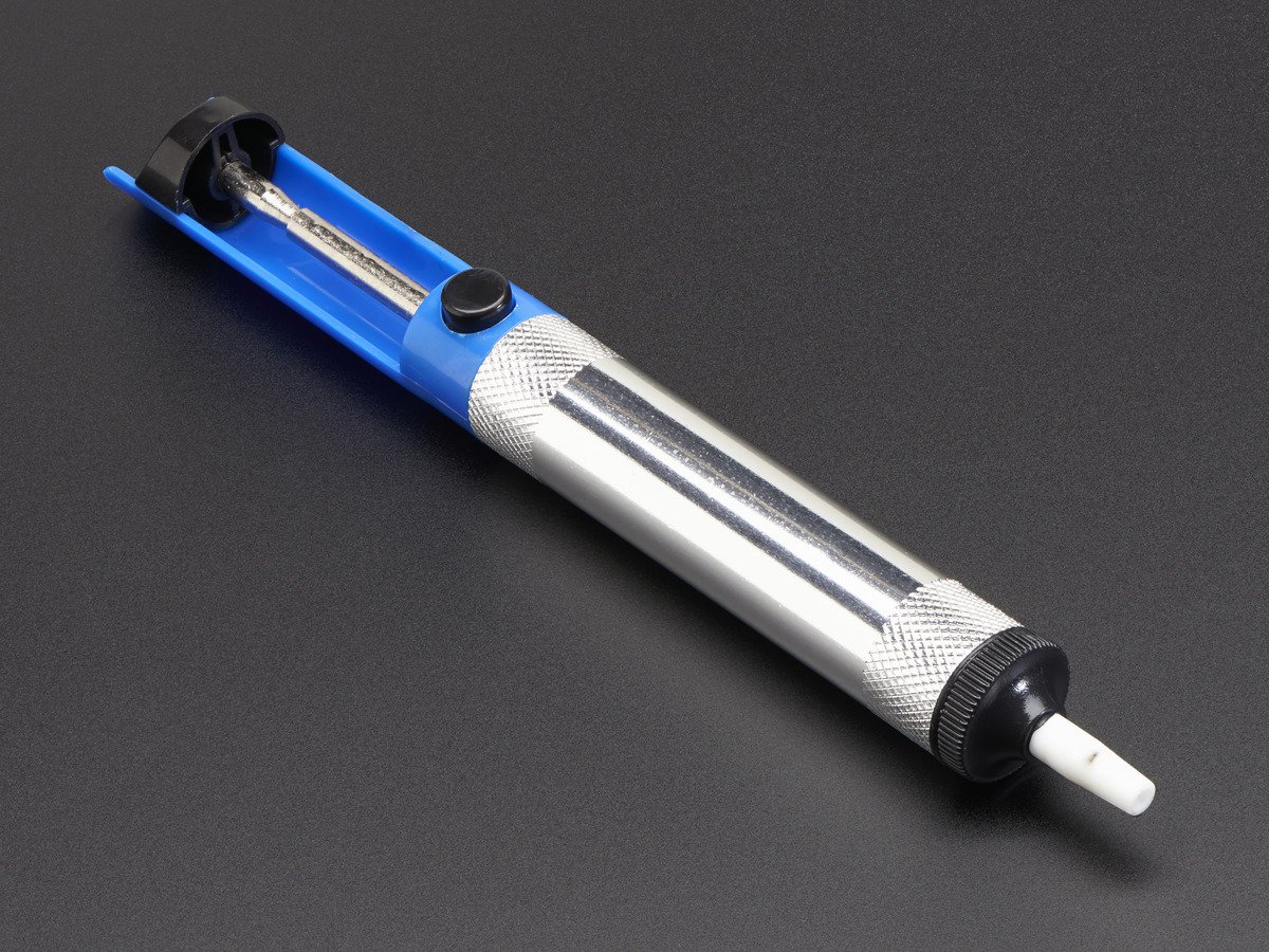

    Sorry, but all the soldering joints you made looks like really bad work. I would redo this. Get a solder sucker like this...
    ...remove every large clump, make sure your soldering iron is not too large but is designed for the purpose and that the solder wire is thin enough, quickly melting and floating well on the surface. The surface must be clean and the tip of the soldering iron must be kept clean using the wet sponge. I clean it after each and every soldering point.

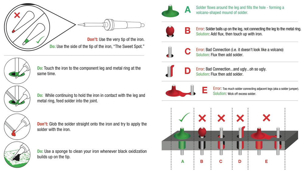

    Here are a few do:s and don't:s:
    You need to practice on something which is not going to be used, not something which you need later on for reliable operations. Get a magnifier and check/fix every point. You will get a lot of headache later on if you box this and start using. Even if it works now, it may fail at any time.

  5. solder sucker bought and arriving monday

    Quote Originally Posted by ravihotwok View Post
    Thanks mate, why are they bad? in the link you sent me it stated when the older balls at the top of the connection and doesnt make contact with the metal ring on the board it is bad, but the ones I have done which are balls but they are making perfect contact with the board rings? I will revist this though just want it clarifying so I fully understand mate
    I can't spend time marking every point, but like I said, get a good magnifying glass and have a look at each one of them. Unless they are not looking like the one marked A in that picture I posted above, you have to redo it. Most of the ones I have seen in your pictures (not only in the one I linked to) are bad. If you have a ball it means the solder wire did not melt and floated out, or there was dirt on the surface or the iron or you did not heat up the wire you solder AND the surface you solder it to and so on... Just google "how to solder" and you will find millions of answers regarding soldering with pictures and Youtube video, so I will not go into more details.
    Very good. Make good use of it, buy a few spare tip and filters also.

    Ravi,
    Just a couple of notes:
    1. There is to much solder on each one
    2. Get yourself some soldering flux, liquid preferable
    The flux and soldering go hand in hand, when the solder "flows" better (you'll see the diffrence) because of the flux, it just works and you'll see what I mean about there being to much on each joint.
    Flux isn't cheap depending on what you get, however if you get liquid flux you simply apply a very small amount, so it last's a long time.
    If you keep application to a minimum you wont need to do a lot of clean up, in fact look for no-clean flux, I like to use isopropanol alcohol to clean any soldering/pcb jobs I do.
    Links below for what I use, just dip your tip in the Kalafonia tin before each pass.
    ALCOHOL BASED SOLDERING LIQUID FLUX SMD/RMA REWORK, REFLOW, REBALL, NO CLEAN
    COLOPHONY/KALAFONIA Limited offer 40g for the price 20g tin Solid soldering flux
    IPA 100% | 1 LITRE | Lab/Pharma. Grade | Isopropyl Alcohol/Isopropanol (99%) 1L
    Look forward to seeing the rework :)
