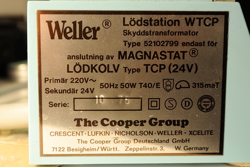

    Well, that's not very fair, is it? Did you not read post #53 and #56? That's all there is to it. Like you say, soldering is not rocket science, but needs some practice. He was given a google link but I did not pick any specific video, I think he should do that selection on his own.
    My iron is a 24v 50W Weller from 1978. It still works well. Of course, it does not have the fancy temperature regulator and display, but I never really felt any need for that.

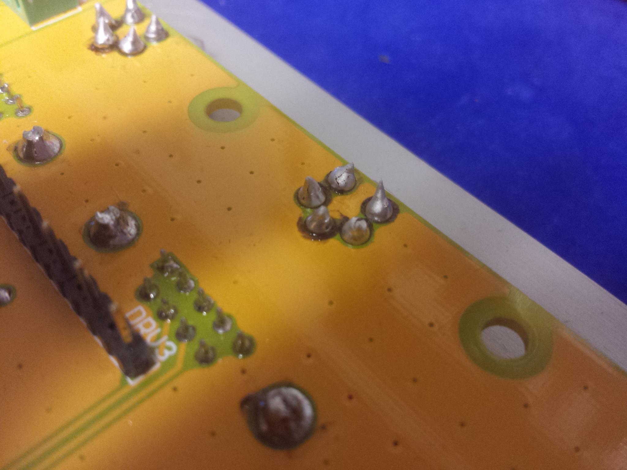

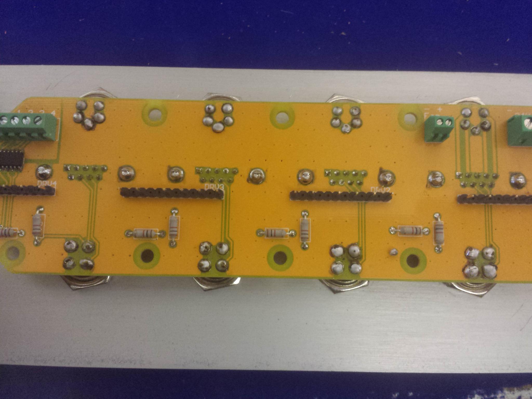

  10. Well I have redone the soldering, and im pretty happy with it. Its still balled up a little but the prongs stick out through the board a fair bit so didnt really have a choice as I wanted the whole of the prong covered in solder, they are very round and meet the metal contact on the board pretty much perfectly, plent of solder also flowed into the connection to begin with :-)
    Before
    After
    Enthusiastic with CNC stuff but a proper novice so be gentle
    My build blog:
    Chinese 3020t Build
  11. The Following User Says Thank You to ravihotwok For This Useful Post:
  12. singed the board coating a little but the solder had made a solid connection and like I say plent of solder has flowed into the conection
