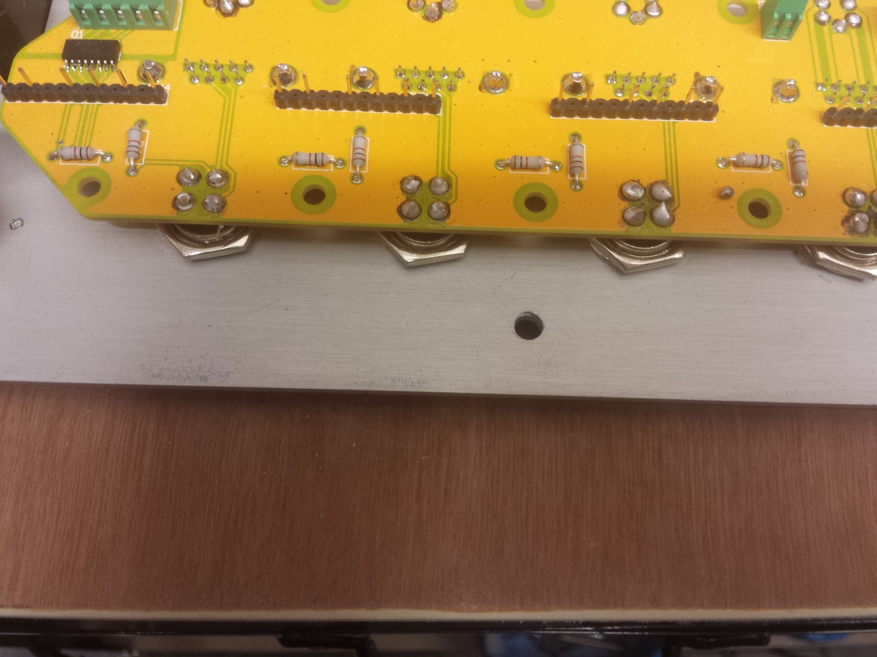

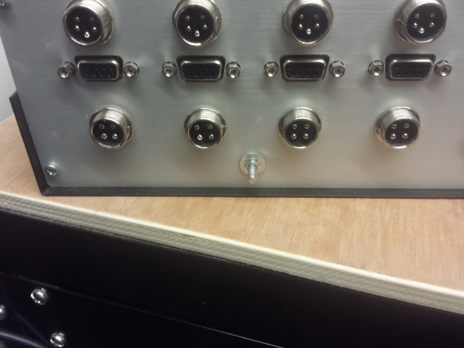

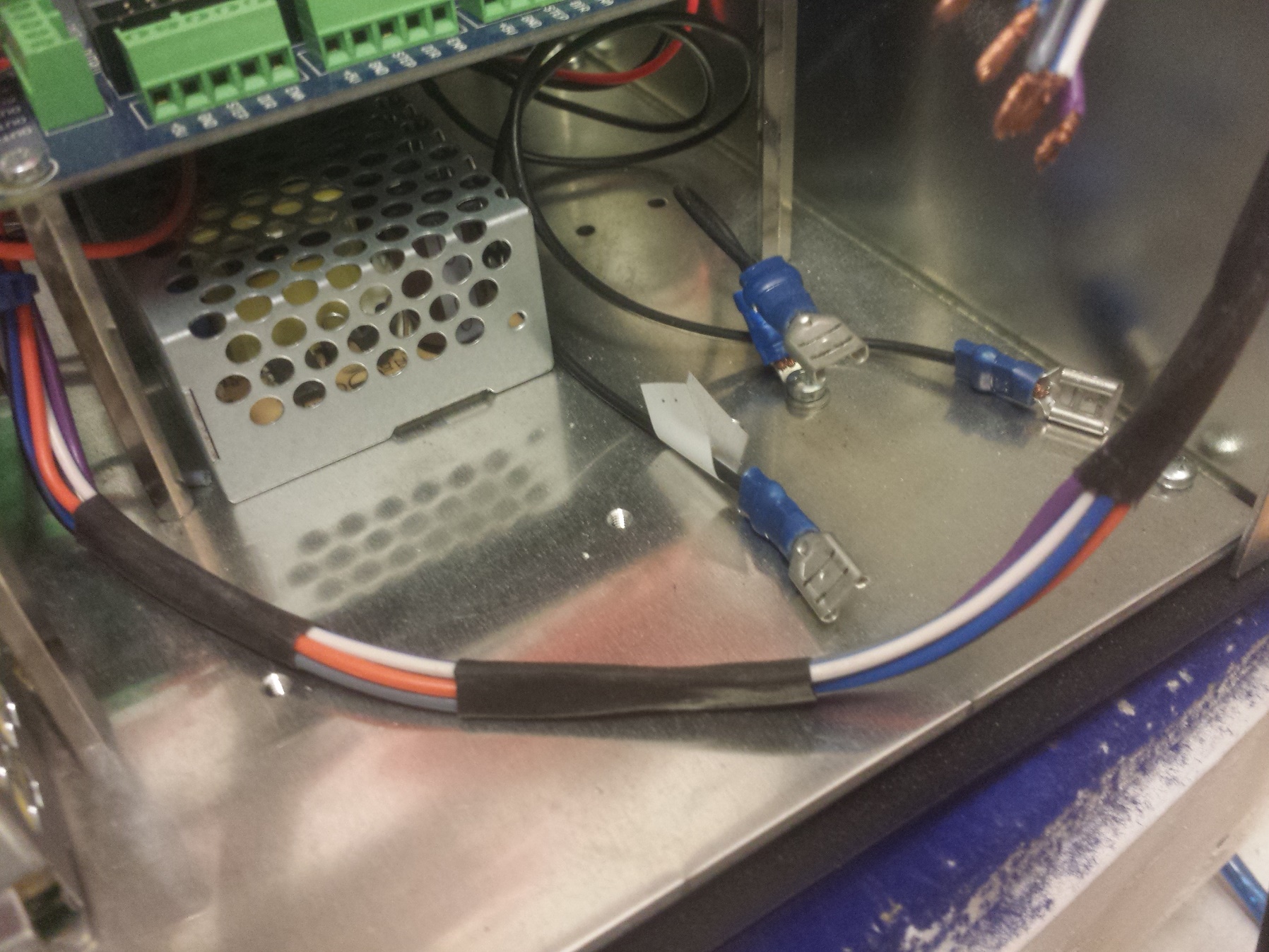

  1. After you all explained what a star was in the box it was obvious where it was when I opened it up. I have drilled a small hole near the motor connections and linked a bolt to the star so I can attached the earthed wires from the motor cable screens to it

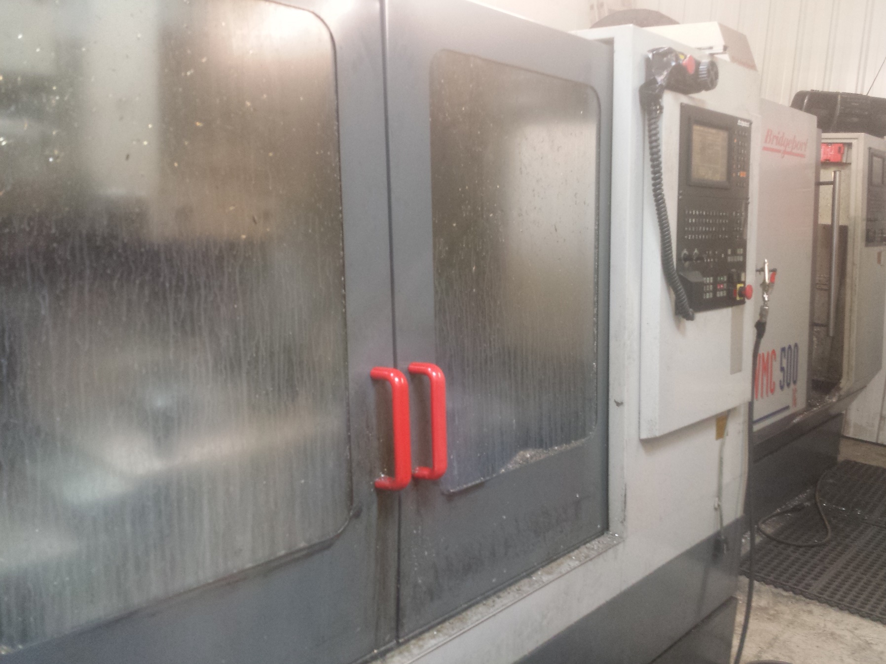

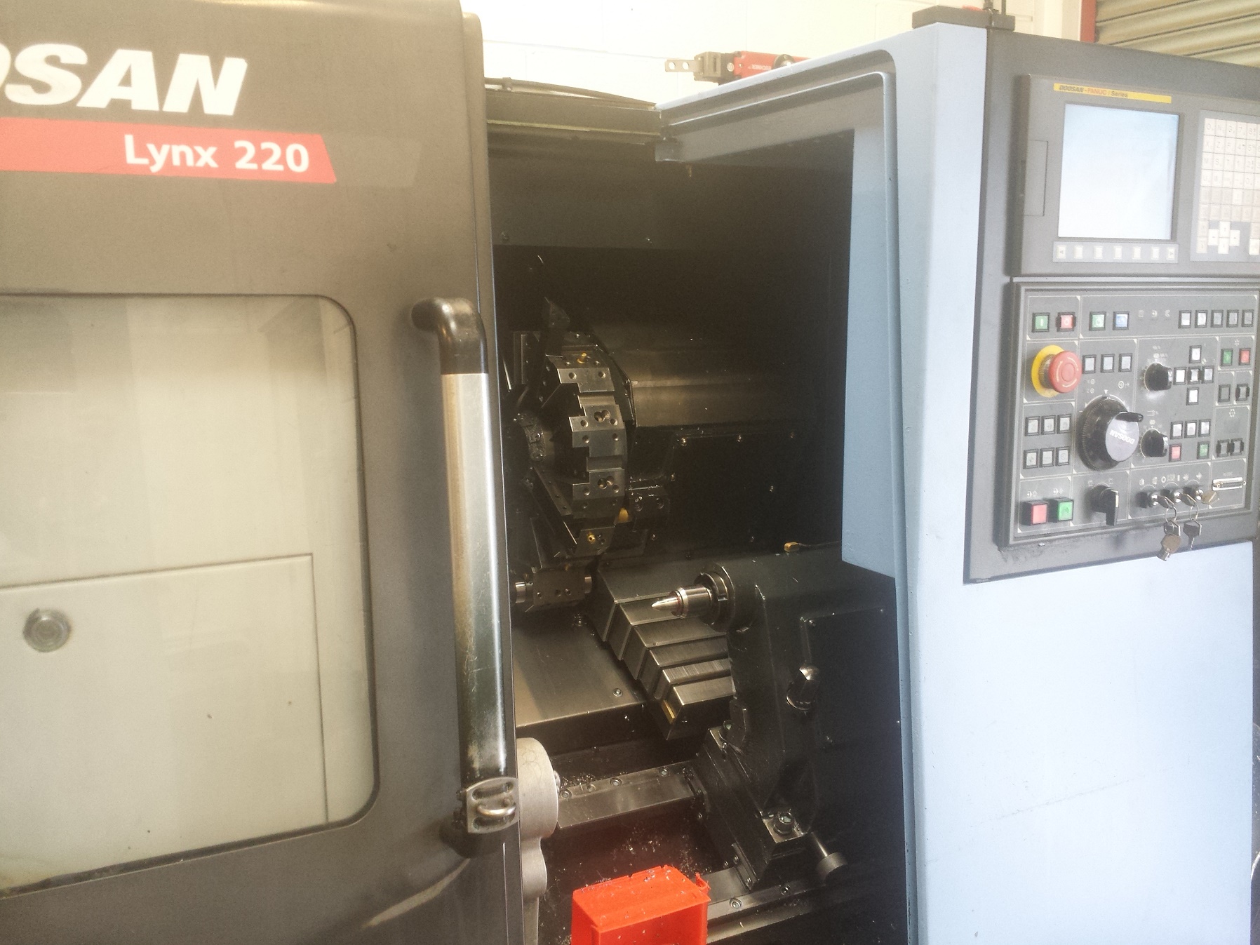

  3. also popped to my best mates workshop, he has a few little toys ;-)

    singed the board coating a little but the solder had made a solid connection and like I say plent of solder has flowed into the conection
    Yep looks much better, you can see now how they resemble the other original joints more, nice job.
    :) Mates with benefits a , your plan for the control box and the earthing looks to be ok.
  5. thanks very much lee, still a bit iffy but the main thing is I now know the theory behind it.
    Yeah my mate does a lot of contracting to a few aerospace firms and has helped me out a fair bit with advice, nearly pissed himself when I showed him my 4 axis machine lol

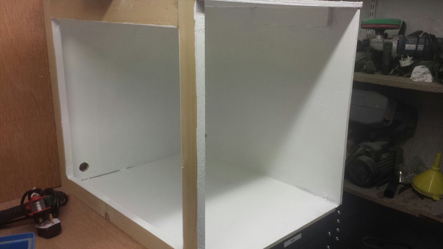

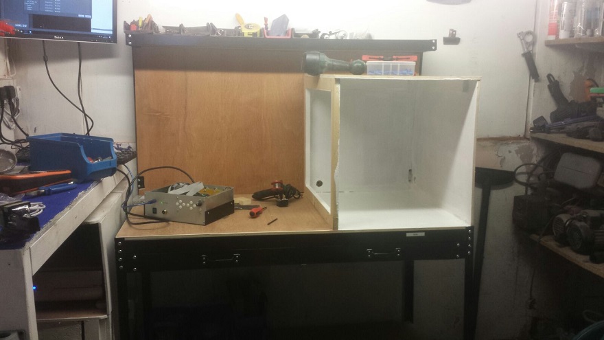

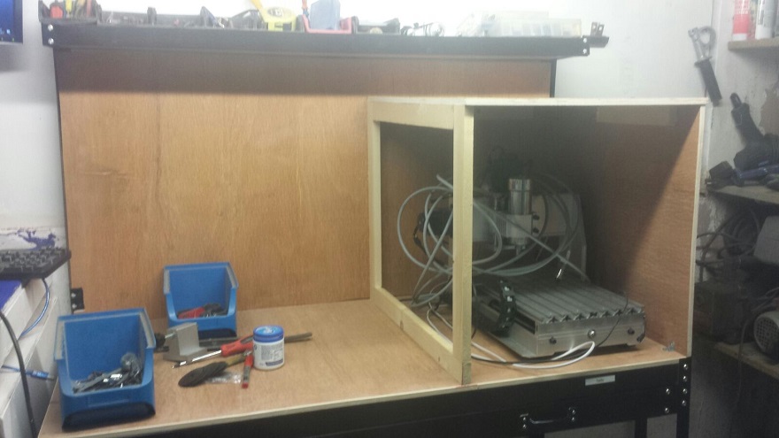

  6. Work has been crazy busy at the moment so only been able to do a little bit on the build. I have started to create an enclosure for the machine, this will consist of a sealed unit with 2 led strip light running at the top of the enclosure front to back each side. One side of the enclosure will be perspex and and front will be a hinged perspex door. There will be an extraction system installed on the side opposite the perspex. Its a very make-shift idea but it will serve a purpose I think and help keep the area as clean as possible.
    I have replaced all the wood on the workbench from cheap thin mdf to 12mm thick ply wood for stability, weight and strength.
    Now I have added a few coats of paint to the inside of the enclosure to aid lighting

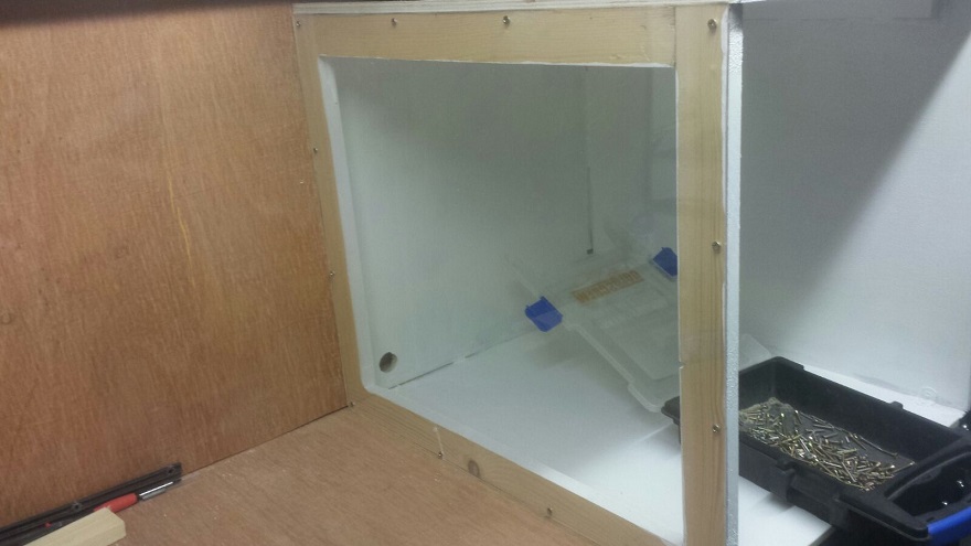

    And here is the side perspex screen installed

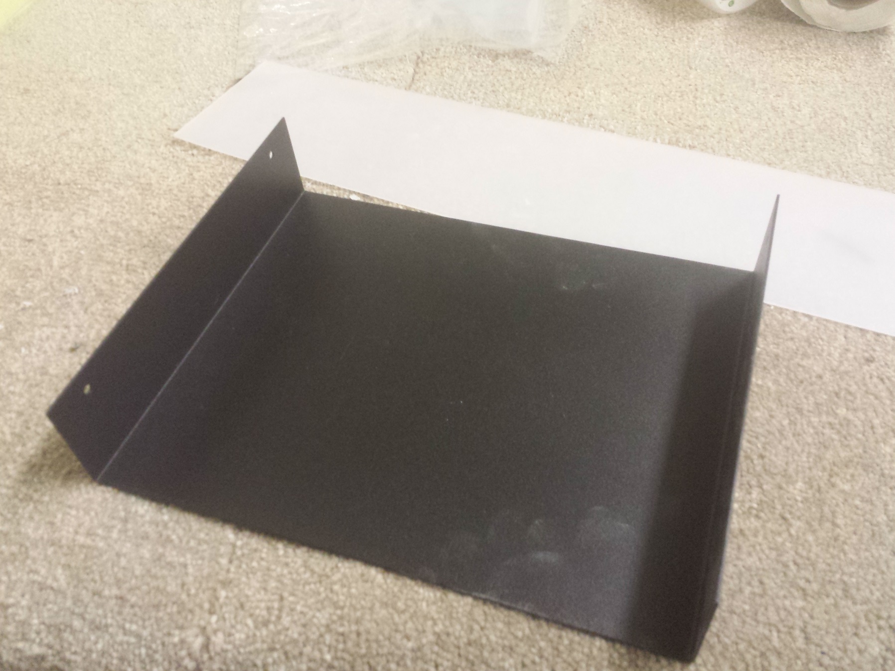

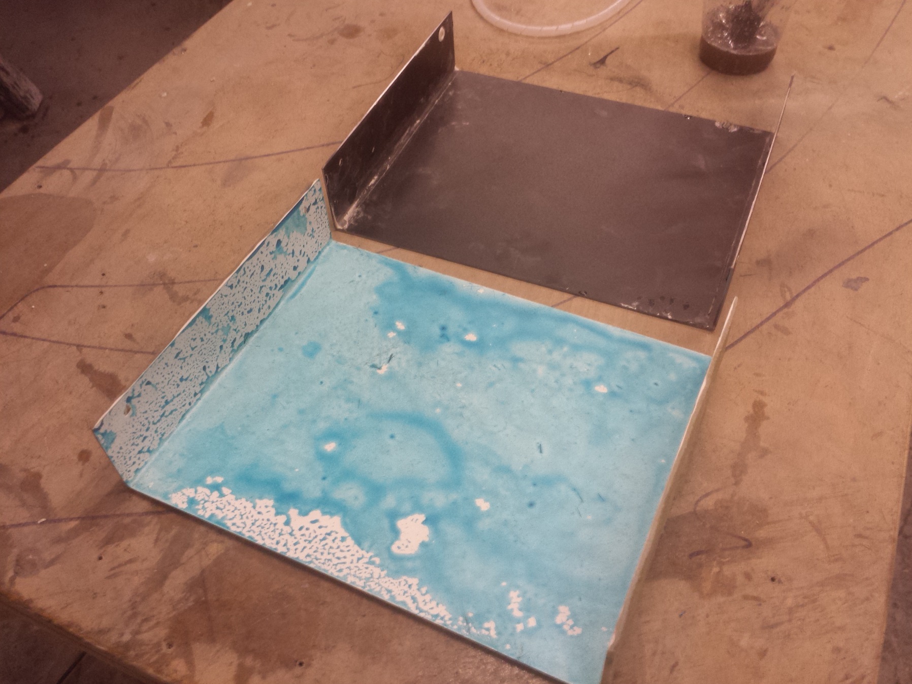

  9. One other issue I have is that I now have a additional power supply/controller for my 600w spindle which wont fit within my planet control box. I have decided to fabricate another box lid which will fit and attach to the top of the existing planet box. Here is the grp mould I have made so far to achieve this

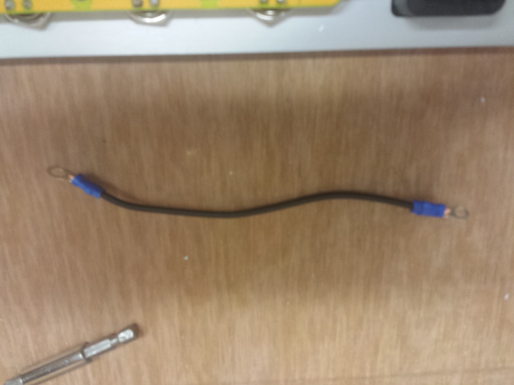

    waiting on some more cable track to feed the limit switch cables through, also need to solder the earths onto the motor cables, trying to run the cables as separate as possible hence the additional cable track, once the enclosure is finished I can work out the exact length of the cable so they are as short as possible.

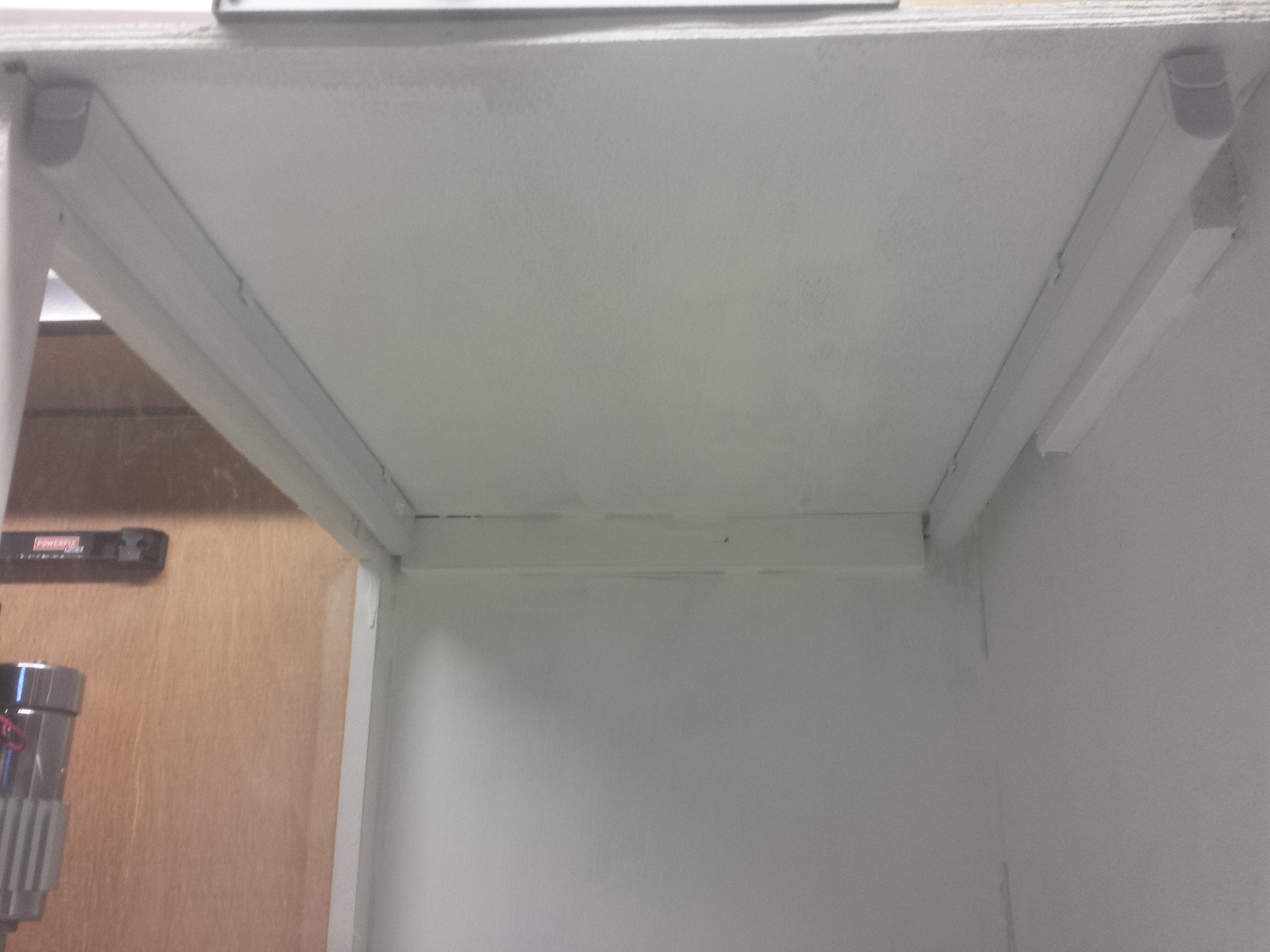

  12. Spent a few mins last night installing the new LED strip lights inside the enclosure, just need to sort a switch out then they will be fully functional.
