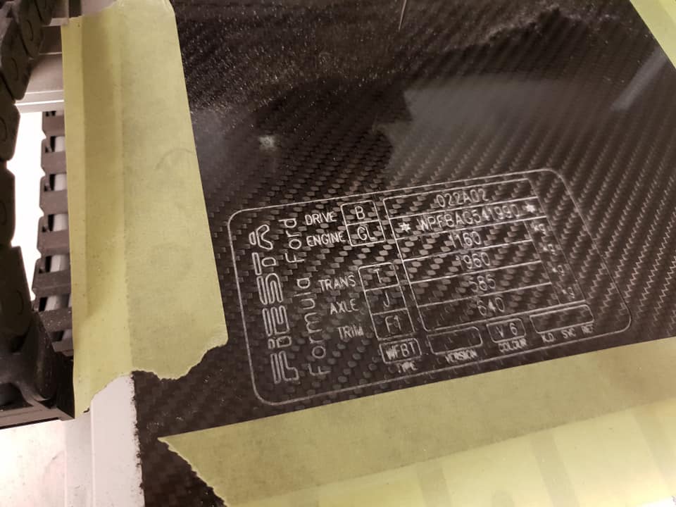

  5. Right chaps,
    had a bit more time playing with the machine, ive got the motion speed set pretty low, feed rate set at 200. But it seems to be struggling with right angles and sharp points, it seems to add a small radius in these areas even though on the preview on the software there are clear points.
    Any ideas?

  6. #166
    Doddy's Avatar
    Lives in Preston, United Kingdom. Last Activity: 4 Weeks Ago Has been a member for 9-10 years. Has a total post count of 1,364. Received thanks 188 times, giving thanks to others 66 times. Referred 1 members to the community.
    Google Mach3 Constant Velocity
  8. Just had a quick read, ive now changed the motor speeds in my planet software from 500 to 200
    seems to have sorted it i think, bloody slow now though lol

  9. #168
    Doddy's Avatar
    Quote Originally Posted by ravihotwok View Post
    Sorry, missed that you was using Planet CNC software. Check this out http://forum.planet-cnc.com/viewtopic.php?f=5&t=1271 (no promises!)
  10. managed to speed up the motors to 500, but changed the blend value to 0. Machining fine now, but a bit stop start on curves

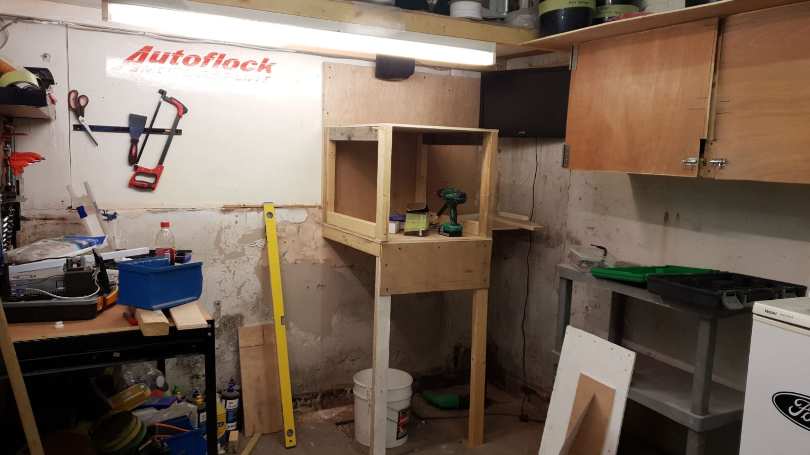

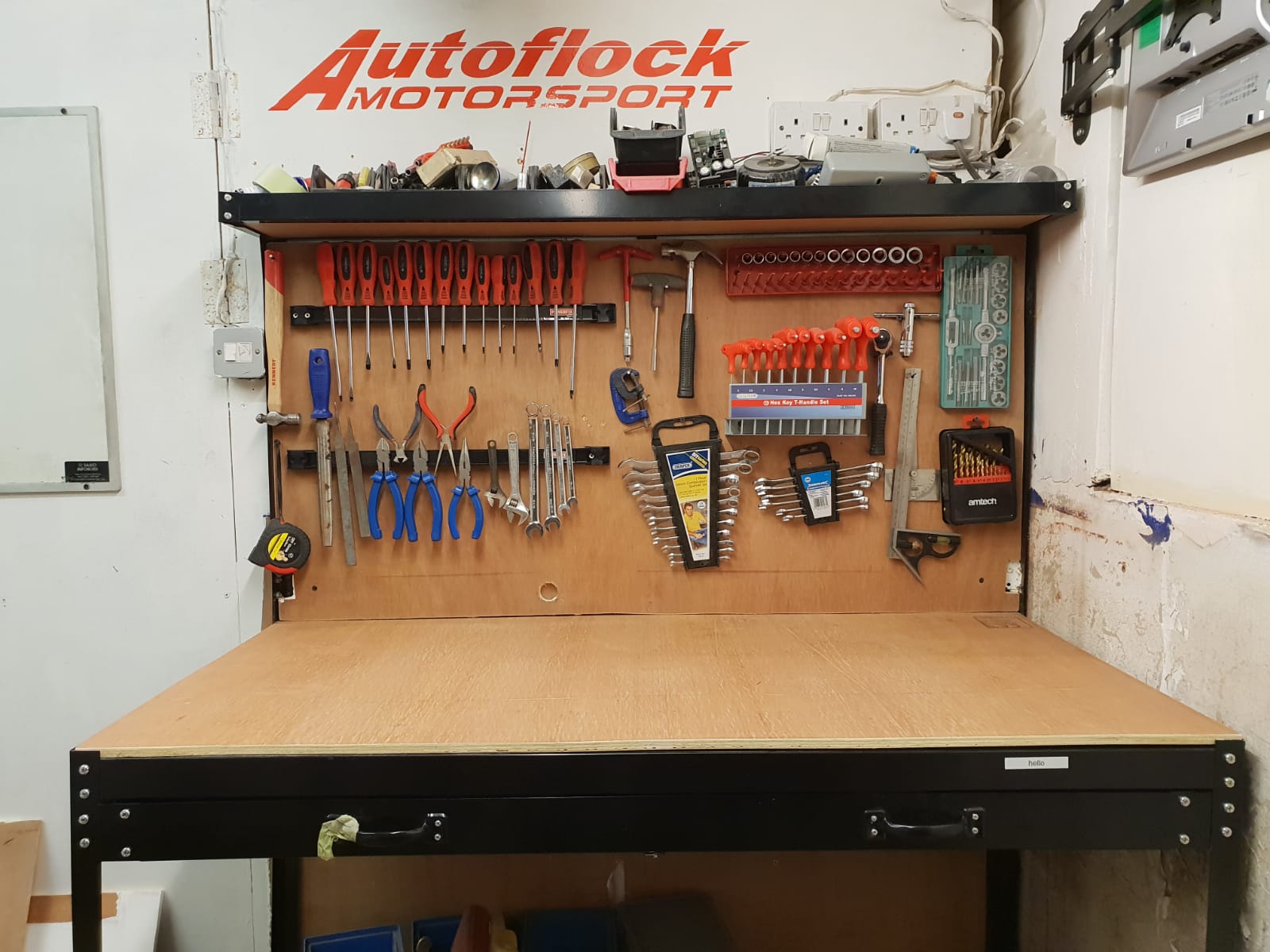

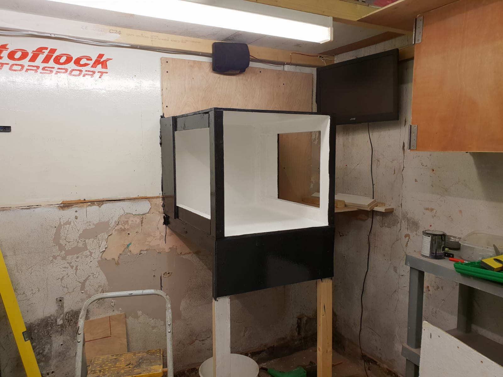

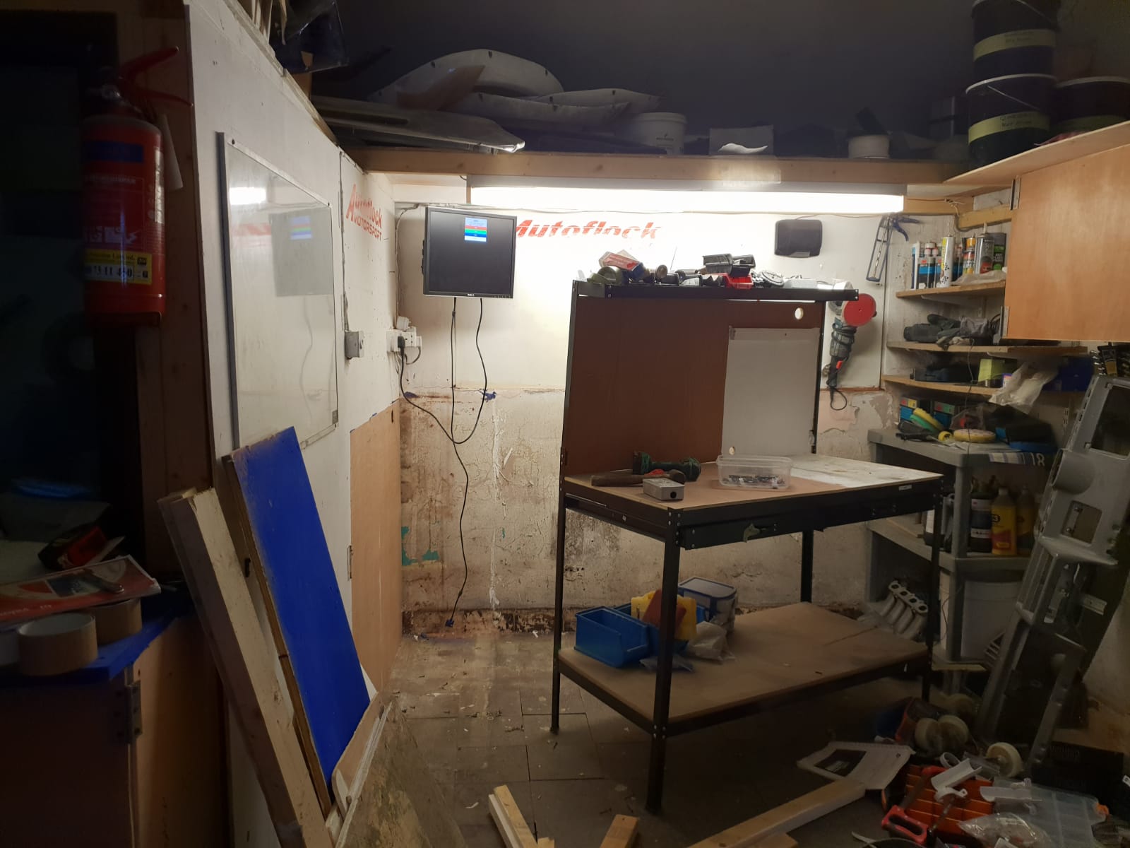

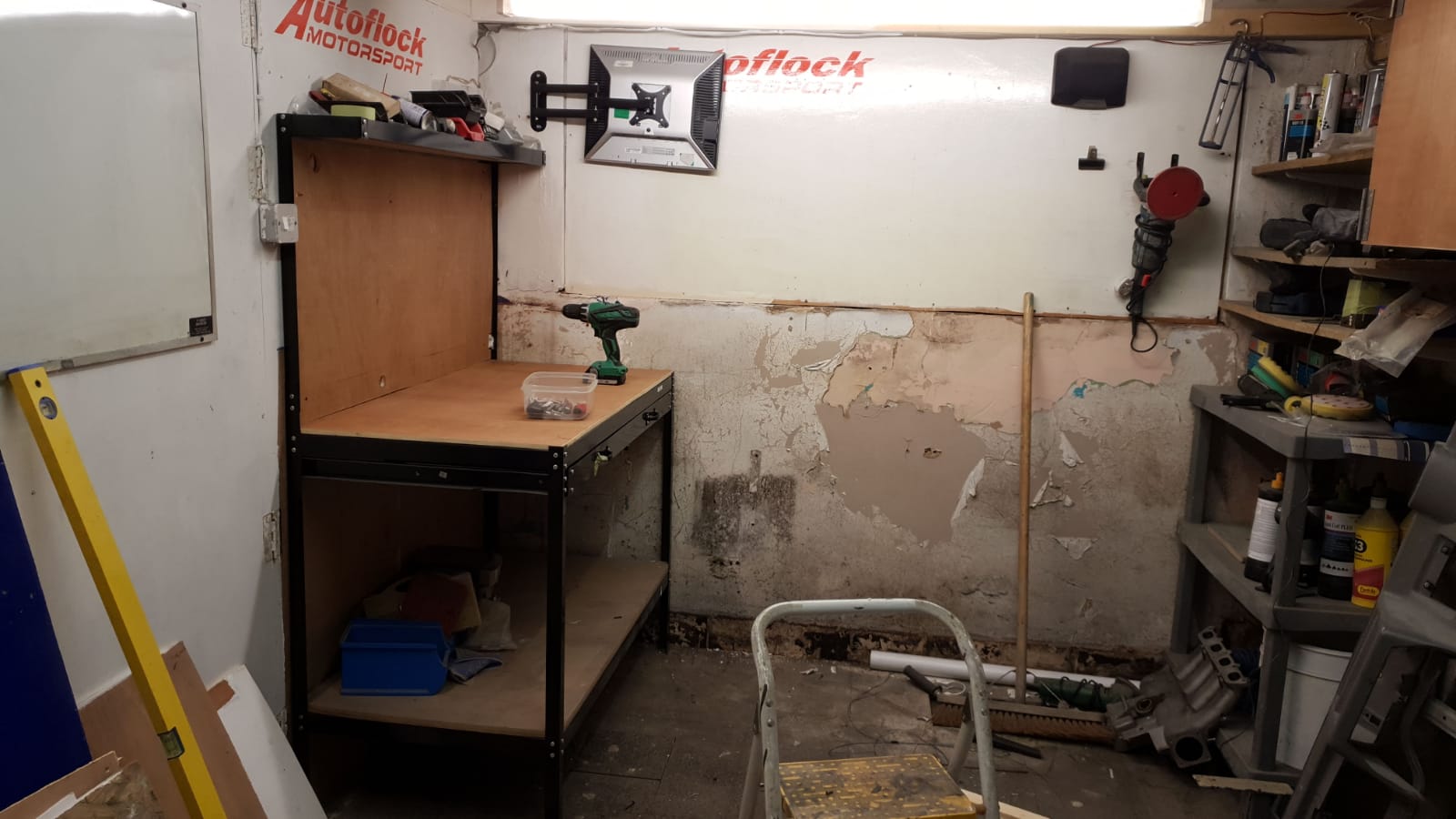

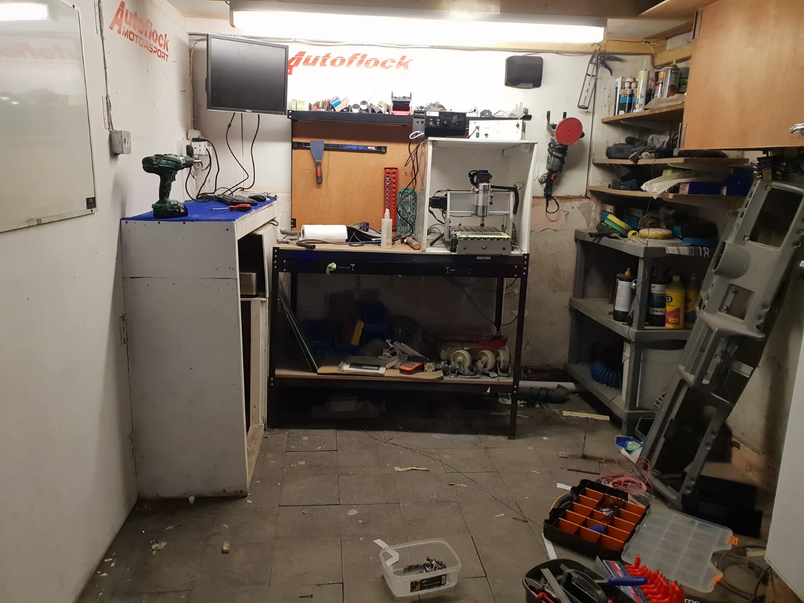

  11. not much of an update but ive begun sourcing parts for the new extraction system and also the new enclosure. Ive tidied up my tool bench and moved it from the back wall against my booth which has free'd up some more space. Also got a big screen dedicated to the cnc stuff

    I have made some small holes for the machine wires to drop neatly through the base of the enclosure so it is nice and neat, will be going to screwfix later to pick up some odds and sods for the extraction system. Im happy with the setup so far :-)
