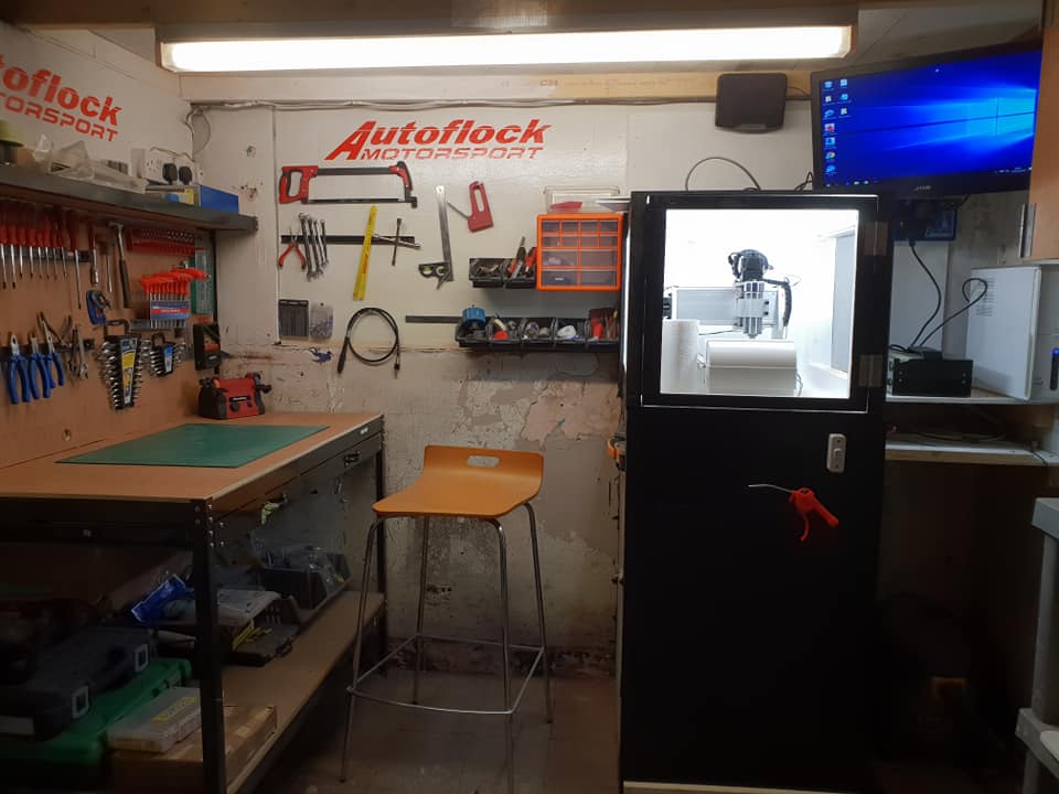

  2. small update with the new setup, extraction system is all done, just sorting the power supply to the rear fans, I bought a transformer but its ac - ac instead of dc so need to get another one then that will be able to power the fans via a variable speed controller. small progress but starting to look the part

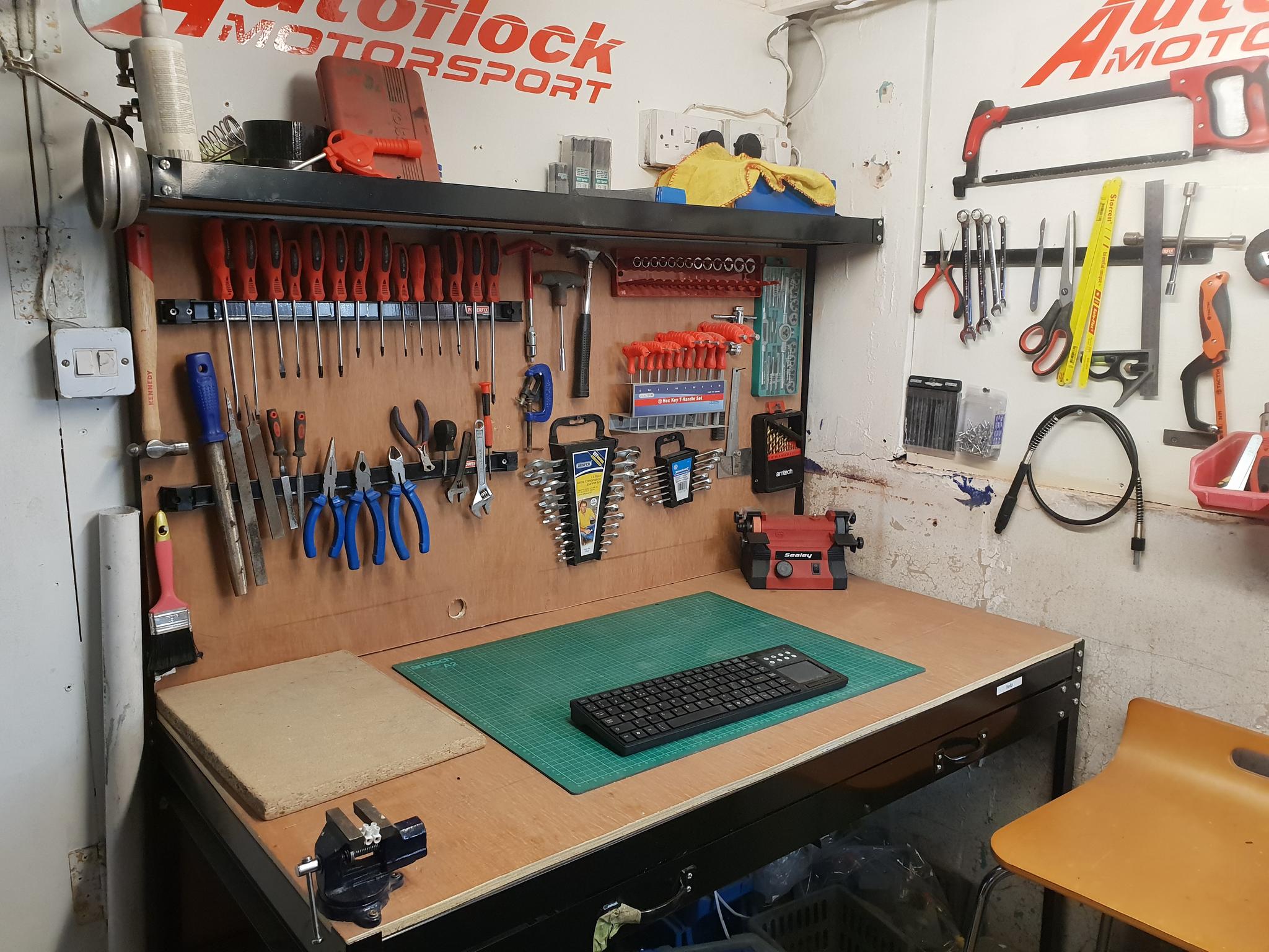

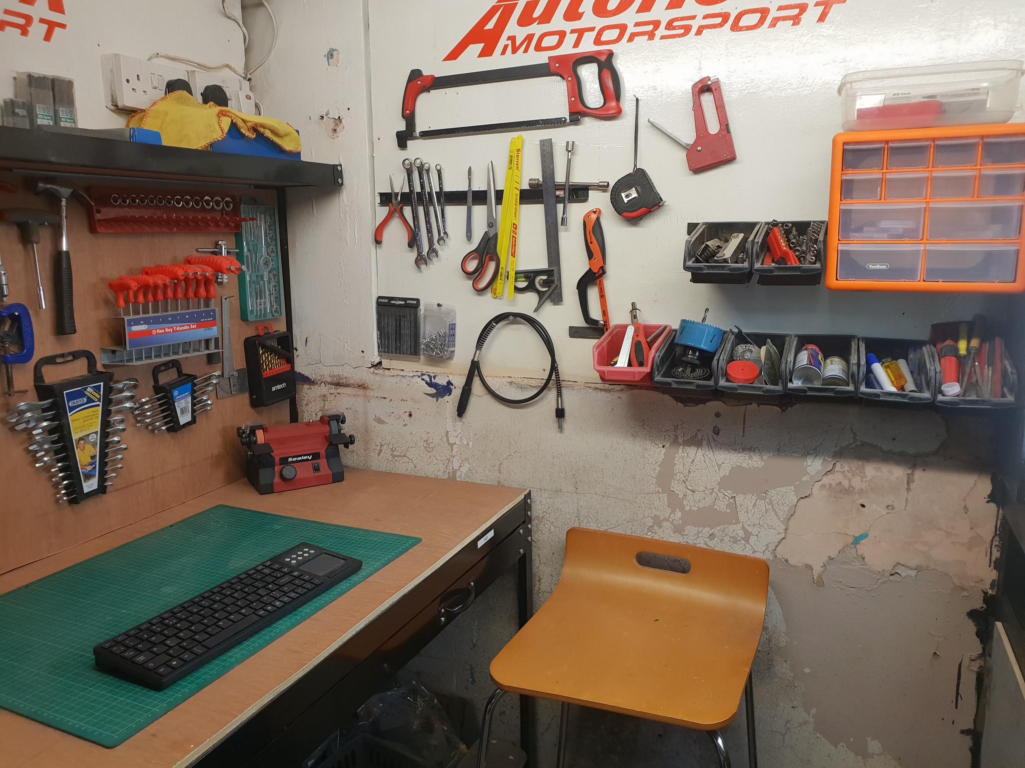

  9. And here is how my setup has finished off with the enclosure fully panelled with perspec and a latch on the front door, only thing left is to swop the desktop pc with a docking station for my small laptop, just need to swop and register all the software im using, im pretty happy with the setup, would like to hear your thoughts on what you lot think. Its only a small workshop so I have tried to be as efficient with space as possible.
