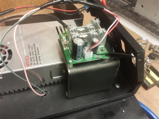

  10. Well bit of an update. I sent rhe pcd back to planet nd they emailed me back the day they received it saying there was a faulty bit of soldering on rhe board which they have rectified and tested. It is now back with me and I have re fitted it. This all took 3 days fir play to them foe sorting it quickly. Anyway I have been stripping the old control box to now house the stuff for the spindle motor
  11. Here is the old box, I stripped it and sprayed it the same as the new control box as I want to mount the 2 together.

    Now I mounted the power supply thing and bolted it now, I spaced it about 5mm up off the deck to help air flow, not sure if it is needed but though as there are vents on the underside it would make sense.

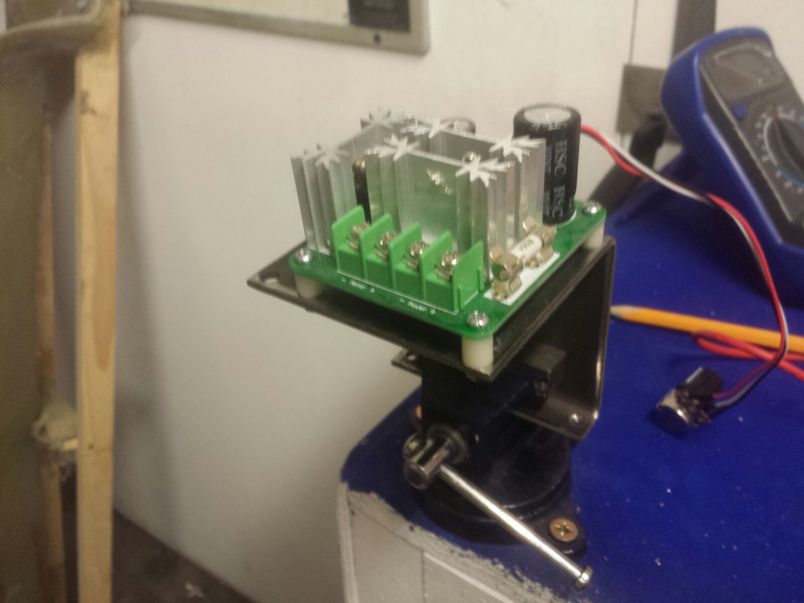

  12. Now I have to find a place to fit the small pcb which has the speed control dial plugged into it

    Is it ok to mount this box directly ontop of my new box so it is nice and neat? I think the power will go from one box to another so it would be much neater if the cables were kept internal hence linking the boxes?

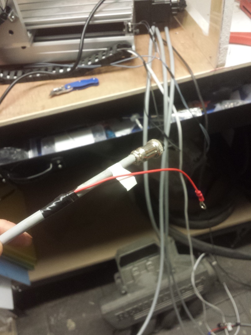

  13. Well another update,
    I have rewired the limit switches correctly as I did it wrong the first time, I have also added ground wires to the shielding on the motor wires to connect to the star on the box I made. With the new diy motor power box I have made that is not fitted to the top of the planet box and I have begun wiring it into the planet cnc controller, just waiting on some confirmation off Planet CNC that I have wired it in correctly. I have soldered and heatshrunk the wires. Also installed a e-stopClick image for larger version.

ID:	22949 button but need to work out how the hell that gets wired in lol. One job at a time
