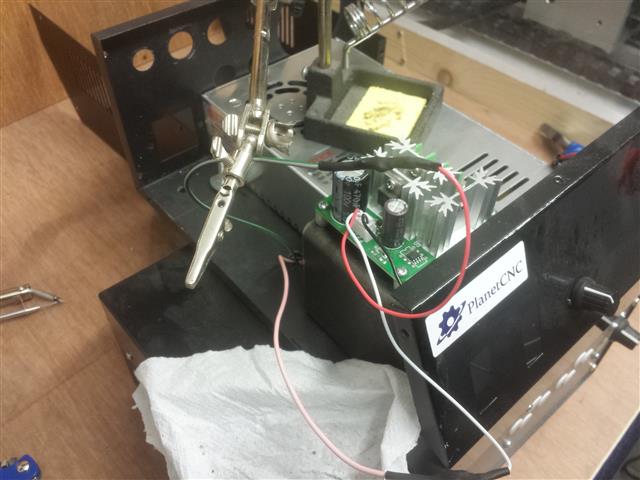

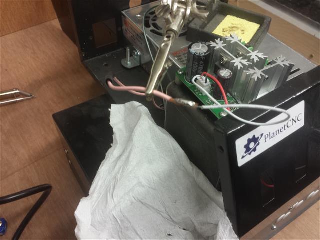

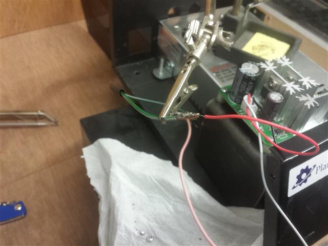

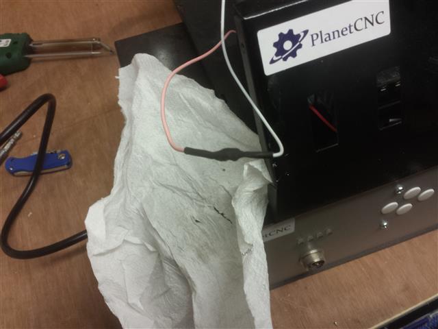

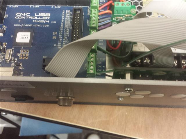

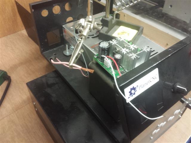

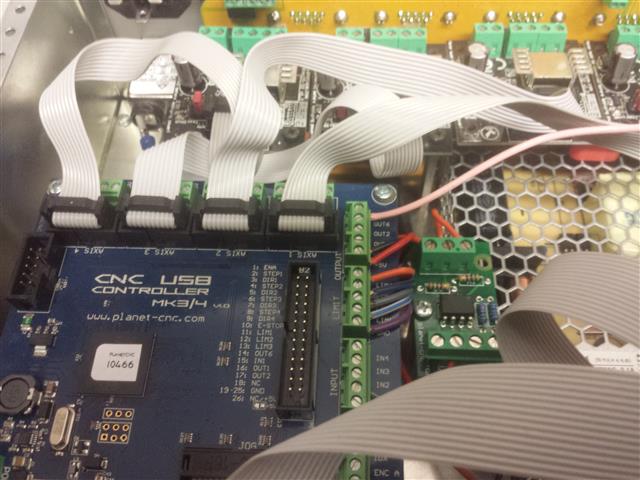

  4. Right chaps I need some help. I have Wired the spindle control board up to my planet cnc enclosure box as instructed by Planet themselves. However I am having difficulty in getting advice on how to get power to the spindle power pack.
    Here is what I have done so far:
    I have removed the potentiometer, capped off one wire and wired the 0-5v and gnd to the pin6 and gnd on the planet board. I have soldered the wires and heat shrunk them

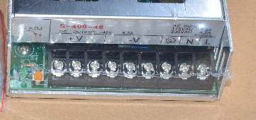

  5. I just dont know how to supply power from the enclosure box to the large silver power pack which is mounted on top for the spindle.
    It has these connections on it:

  6. #125
    Hi there, could you explain a bit more what you mean when you say power pack on top for the spindle?
    The photo you have there is a typical Chinese power supply, it will need to be wired to 230v AC - Mains.
    Alex
  7. #126
    Quote Originally Posted by ravihotwok View Post
    I don't understand the question. You connect the mains to the L and N, the Earth to the one beside N and the spindle to the + (normally red wire) and the - (normally black or blue wire). If you have a regulator to adjust RPM then you connect that in between the power supply + and - and the motor + and - terminals. The PWM module should have some kind of documentation describing this, or printed on the PC board there should be clear markings.

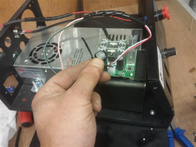

  8. hi mate, basically I have wired the small pcb that came with the spindle to the controller from planet cnc. However I dont know how to supply power to the silver power pack which is for the spindle. Been trying to get documentation for the spindle stuff but the ebay seller is not playing ball at the mo

  10. #129
    hello alex,
    sorry didnt see your reply, yes thats the box im trying to supply power to, but not sure how to tap of the power going to the controller box
    Hi Ravi,
    You need to connect that Power Supply you have to 230v AC - Mains Voltage.
    Looking at the PSU you have the far right three terminals: Earth, Live, Neutral.
    Get a common Kettle Plug (For a PC or a PC Monitor etc), cut end off and use it to power the PSU.
    USUALLY - in a typical plug it is as follows:
    Blue - Neutral
    Brown - Live
    Green / Yellow - Earth
    If you want to be neat about it then you can get one of these: Click Me
    That will you mean you can just plug it in and have it modular.
    Once you have the PSU live, you just need to (I assume - I do not know what you have been supplied to control the spindle), power the PCB using 48v DC from the PSU using any of the remaining terminals. You have 3 sets of -V & +V on the left hand side of the PSU.
    Alex
