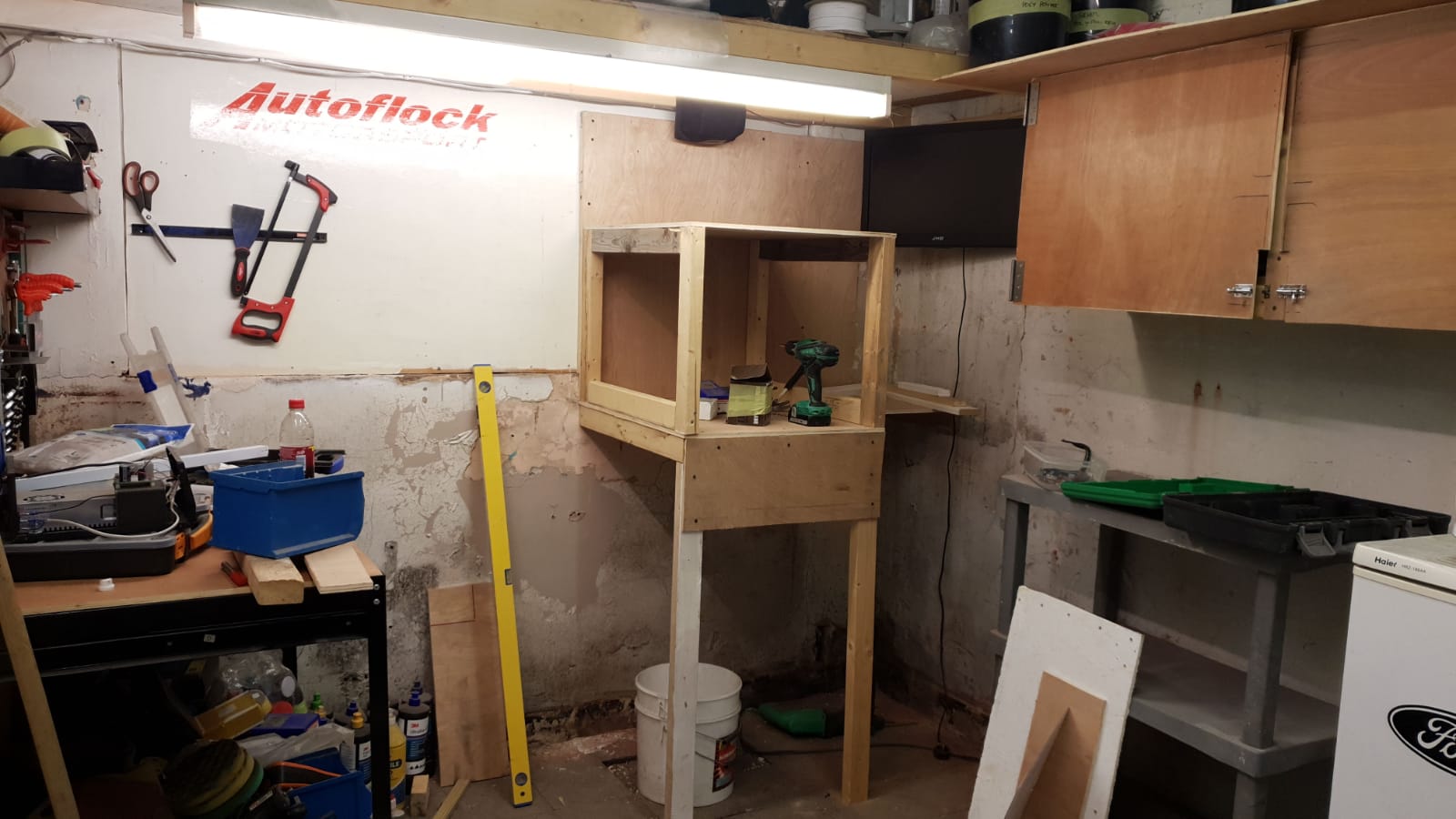

  11. not much of an update but ive begun sourcing parts for the new extraction system and also the new enclosure. Ive tidied up my tool bench and moved it from the back wall against my booth which has free'd up some more space. Also got a big screen dedicated to the cnc stuff

    I have made some small holes for the machine wires to drop neatly through the base of the enclosure so it is nice and neat, will be going to screwfix later to pick up some odds and sods for the extraction system. Im happy with the setup so far :-)
