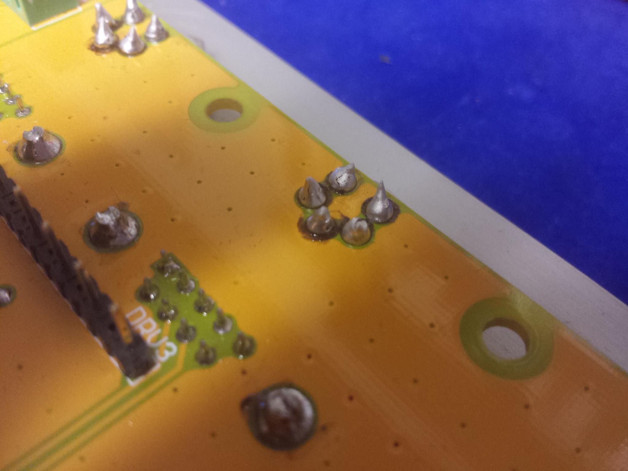

    So far the only advice he's had is to get a solder sucker and start again, clearly there is more going on than that and he needs more experienced input, let's give him that instead shall we.
    Flux cored or not something isn't right and it's probably a combination of things, additional Flux I think will help Ravi along in getting better joints, additional flux has been used in the SMD and rework/reflow arena's for years and for a very good reason!
    What solder wire are you using?
    Ravi, using additional flux cannot hinder the soldering process and can only assist you in doing a nice/better job, don't tell anyone this but that is the reason they put it in solder wire in the first place :).
    Your soldering iron needs to be hot enough, balling up like that can come from the iron being too hot or cold, I'm betting yours is to cold, some lower end irons heat up but they don't do very well at staying hot once you start using them, this happens with low power irons too at around the 25w range, when you are trying to solder bigger components.
    However my go to for most jobs is now a 12w Weller SP12, I inherited it along with technique from my grandfather who was a British telecom engineer, the iron is from around the 80-90's and still has the original tip, it along with a combination of technique, additional flux and a solder wire appropriately sized gets everything I solder just right for me - every time...Thanks Granddad!
    40-60w is an average range on what allot of irons will be rated at, my other iron is a 25w similar to the Weller, I also have two gas soldering irons for mobile work. The bigger of the gas irons is handy with the tip removed as its basically a mini blow torch and works excellent on heat shrink and those jobs where you need a small flame with a bit more power.
    What iron are you using ?
    The tip of your iron needs to be "on point" Ravi, the problem comes from oxidation and not keeping your tip clean, once your tip becomes oxidized the solder will no longer want to flow or stick to it properly and this is a problem. Don't clean your tip in flux or water, this shocks the tip and damages the Iron and Chromium plating, just dip the tip in some pure Rosin after each joint and that should be good enough for the tips life time.
    Solder to the tip of your iron and then to the area/joint to be soldered, your transferring the solder from one to the other, try and do this with as minimal amount of heat going into your component as you can and your now doing it correctly.
    Soldering isn't rocket science Ravi, there are lots of options in terms of tools and technique but a few fundamentals need to be right for it to be successful, if left those balls of solder you've done so far could come lose and as such cause arcing, arcing not only damages components and equipment but it can cause fires too !!!!

    Well, that's not very fair, is it? Did you not read post #53 and #56? That's all there is to it. Like you say, soldering is not rocket science, but needs some practice. He was given a google link but I did not pick any specific video, I think he should do that selection on his own.
    My iron is a 24v 50W Weller from 1978. It still works well. Of course, it does not have the fancy temperature regulator and display, but I never really felt any need for that.
    I have used up several tips and also have different type, depending on the purpose, I change when necessary. I would not use a high voltage type of iron, which the 12W you have been given is, on any electronics, but I know many people use tools which are not suitable. Anyway, while it may have a nostalgic value for you, I personally would only keep it as a memory.
    Regarding flux, I stand by what I have said. It is waste of money. On electronics one should not use any other type of soldering wire than the one with flux in the core of the wire. As a matter of fact, too much flux can also cause problems, so it is not true that using flux can not hurt. Flux fluid is used only in industrial soldering, where the PCB is travelling through a flux foam first and then through the melted soldering wave.
    Manual soldering of electronics don't need any flux foam or liquid.
    My experience is that if there are balls then it is enough to heat them well up, until completely melted and either suck it up or in many case it will float out because there is normally enough flux around the points. If if does not float out and look like figure A in the picture I provided then there is nothing else to do than suck it out and apply new solder.
    Takes a 15 minutes to half an hour practising and that's it. Really very simple.

    You are correct, I owe you and anyone I have offended an apology, I did read post #53 but I unintentionally skipped over the paragraph that starts with "...remove every large clump" as I was more attracted to the do's and don'ts picture. I also totally missed post #56 entirely.
    I'm very sorry to you and anyone else I offended, at the time I felt it was a fair comment to make however I was wrong so I'm sorry about.
    I understand.
    Ok well now you've got your wires crossed because flux is not a waste of money at all, it helps and there is no questioning that. It is used extensively in the repair/rework arena by many and my own real life experience is that it does help with non SMD soldering too, especially when you're dealing with old pcb's. If you've got it handy there is no reason not to use it in my opinion and that is how I solder.
    I stand by what I said and think it will help Ravi along with his soldering.
    No one said it did, however they put it in the solder core for a reason. Exactly, in your experience...
    Camera, I'm just offering Ravi what I can from my own understanding and experience, earned from actually doing it and experimenting myself. I do not proclaim to be some kind of authority on soldering.

  10. Well I have redone the soldering, and im pretty happy with it. Its still balled up a little but the prongs stick out through the board a fair bit so didnt really have a choice as I wanted the whole of the prong covered in solder, they are very round and meet the metal contact on the board pretty much perfectly, plent of solder also flowed into the connection to begin with :-)
    Before
    After

  12. singed the board coating a little but the solder had made a solid connection and like I say plent of solder has flowed into the conection
