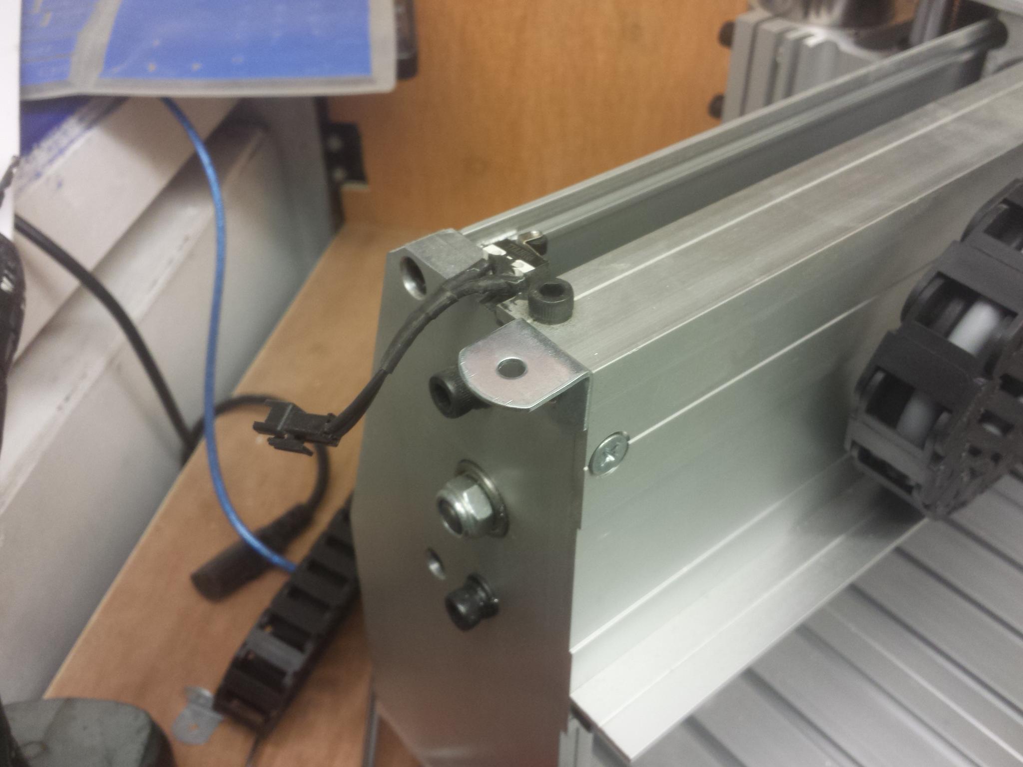

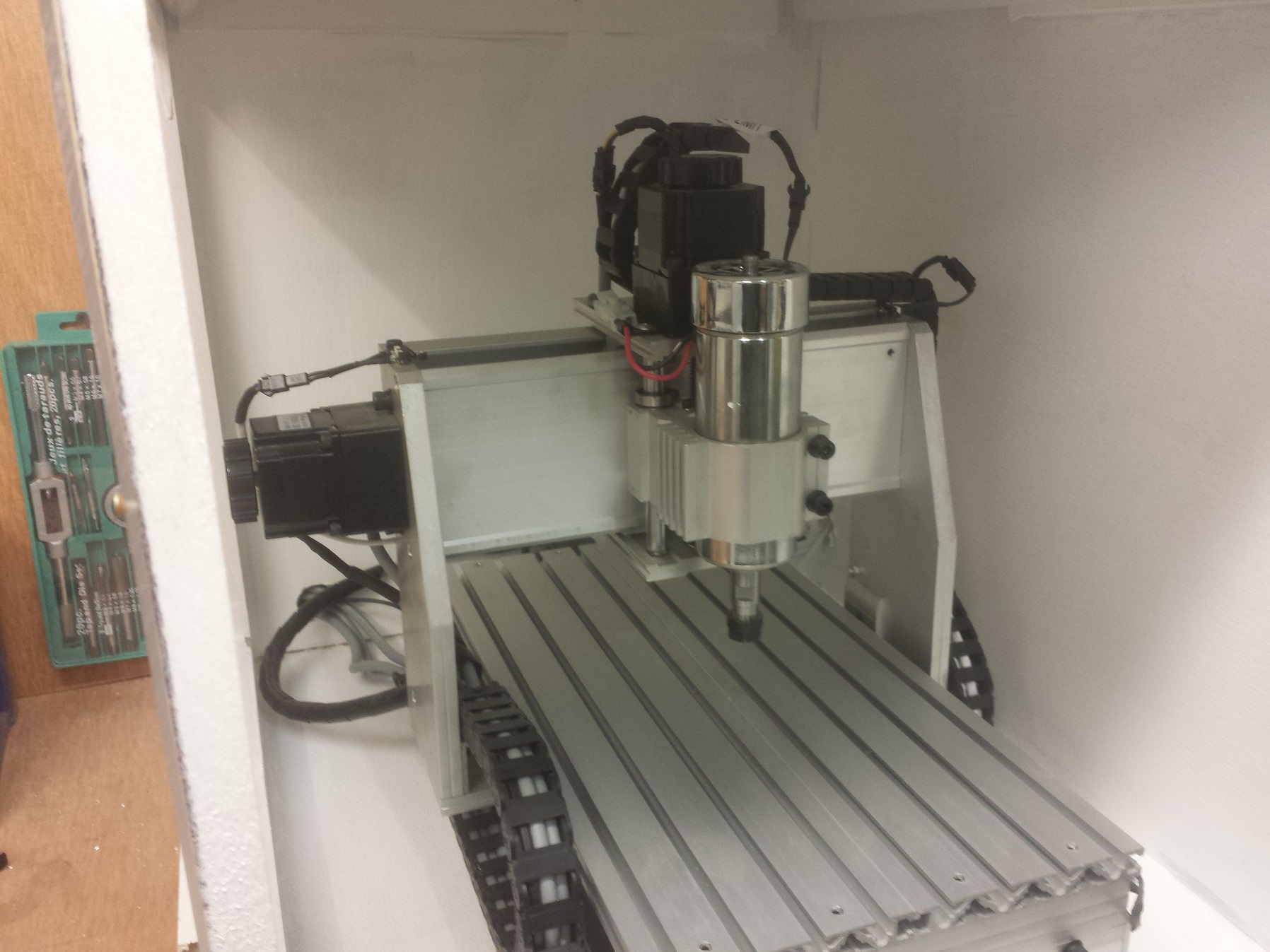

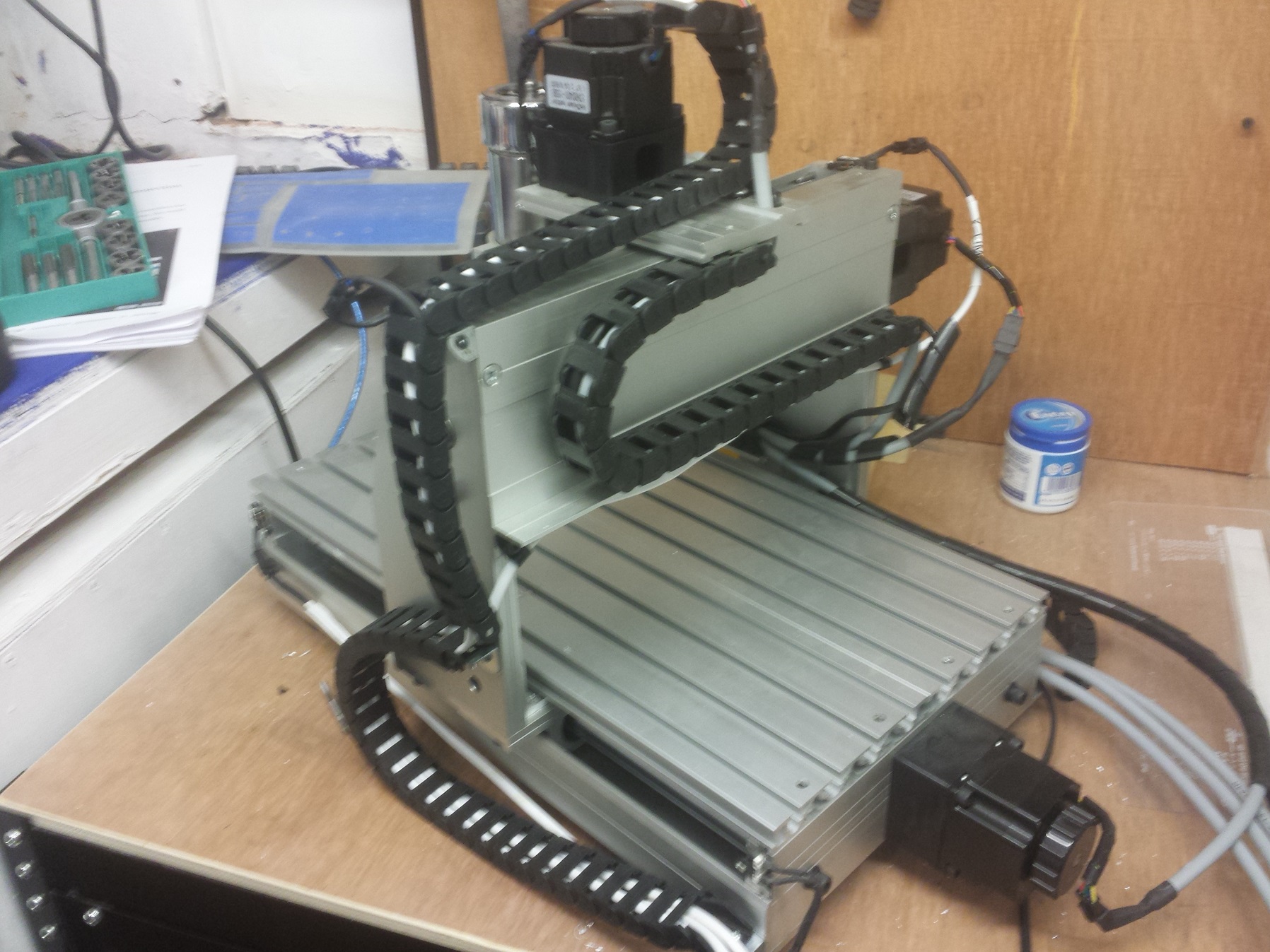

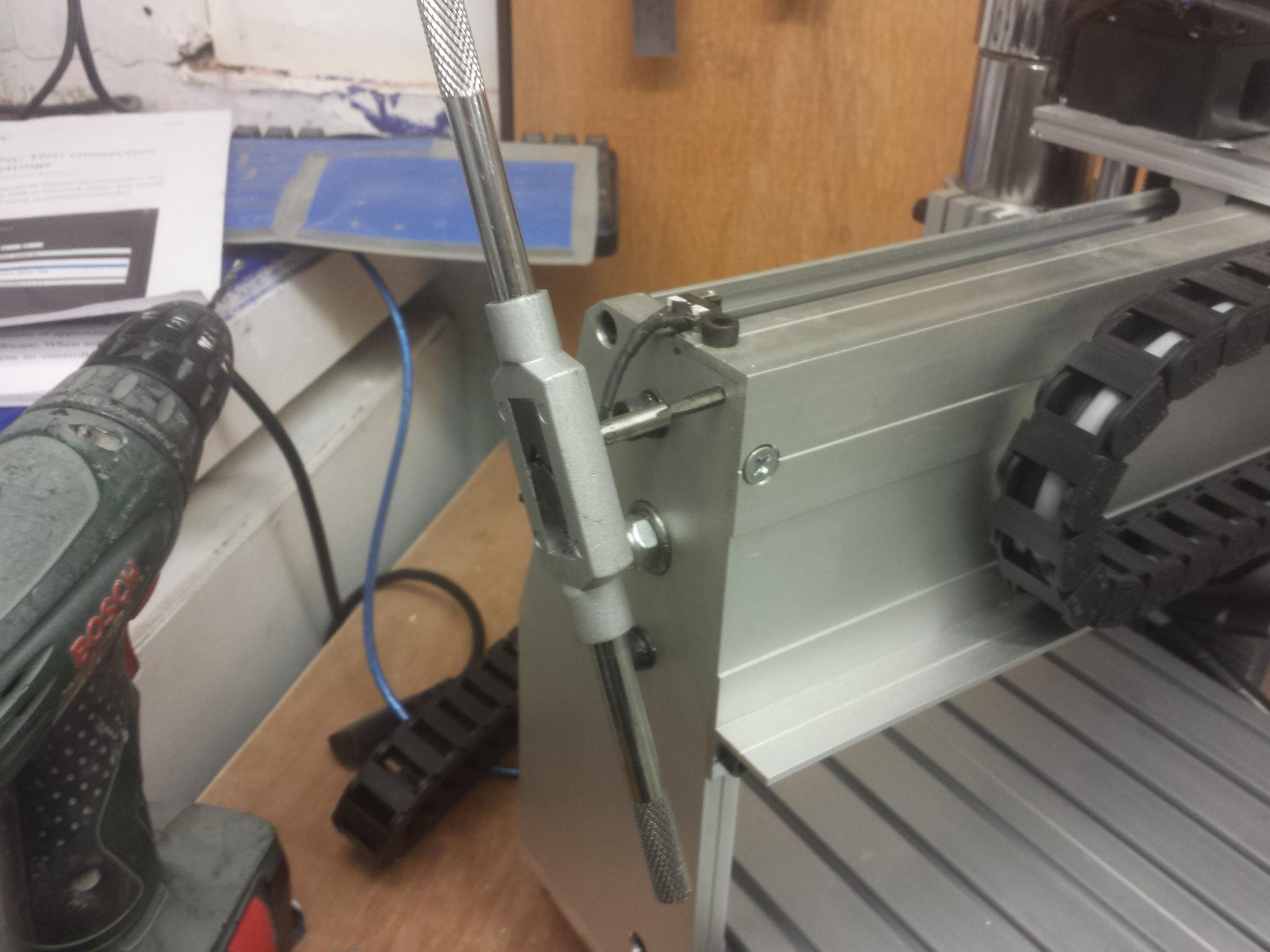

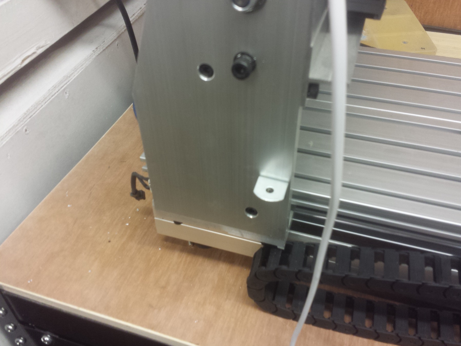

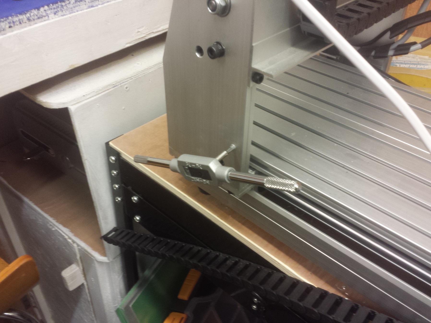

  1. Managed to find a quick hour to do a bit on the machine with not the best results :-(.
    Anyway I have wired up the limit switches and installed a second cable track on the opposite side to the motor cables to try and keep them separate. I have also drilled and tapped some holes to help clip the cables nice and neat

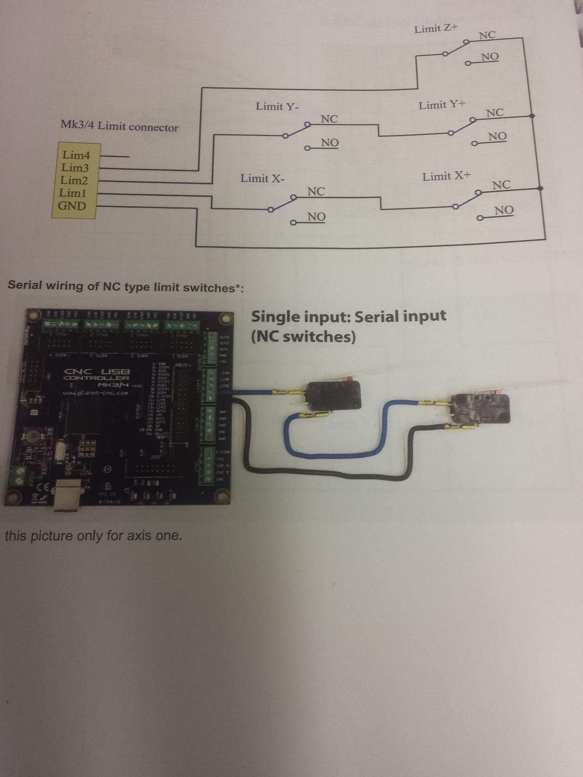

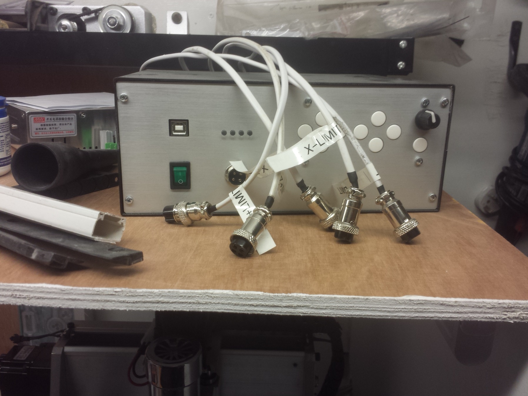

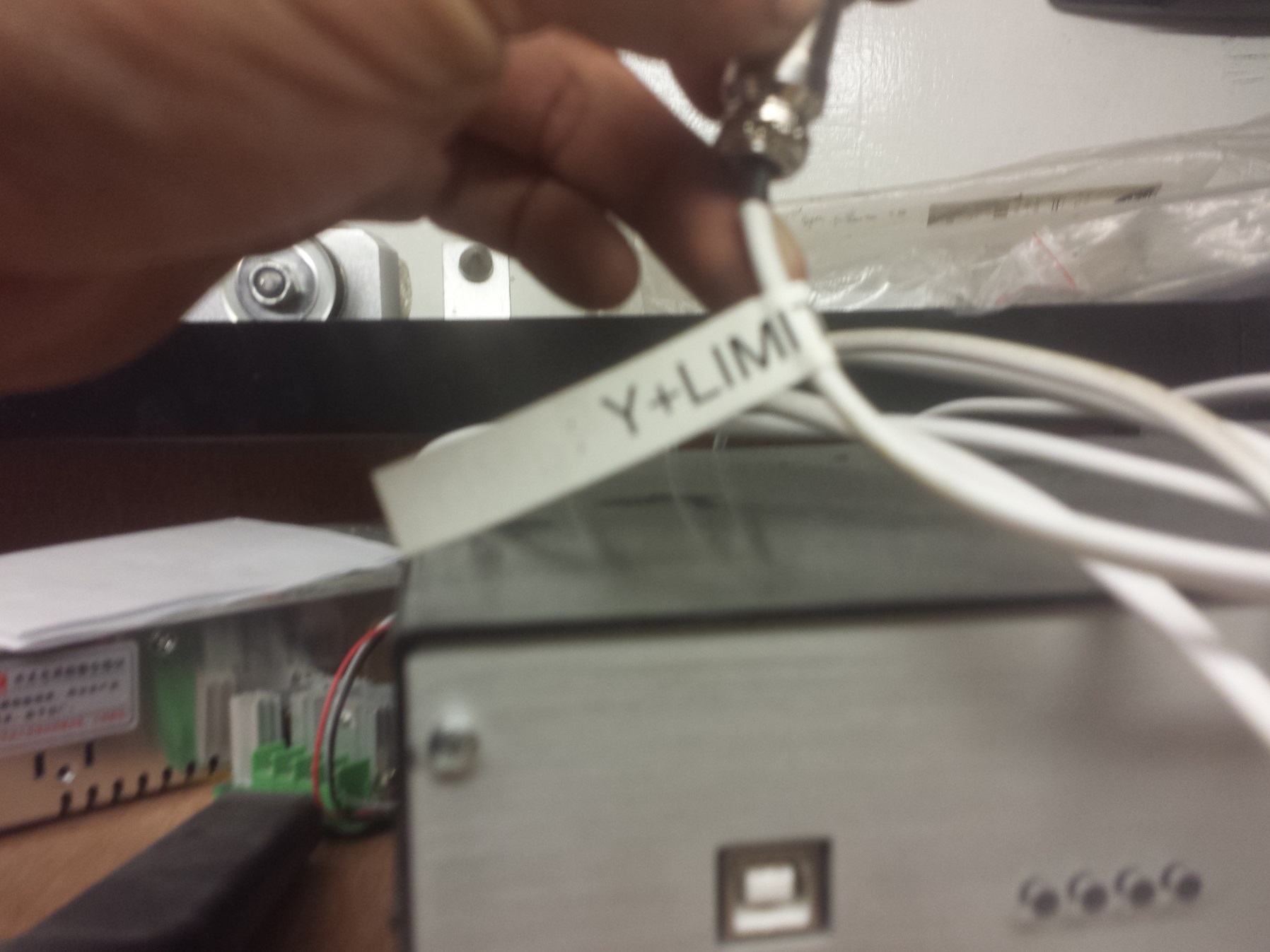

  3. I labelled each of the limit switch cables only to find I did the wrong lol, only need one cable per axis (2 switches)
    Plugged it all in but its still not working correctly, motors seem to stop intermittently and something up with the y limit plug socket in the box.
    I have not done anything to the settings apart from set the units per step which seem to be working now (when the motors don't stop)
    I have sent an email to planet cnc and will do some more investigating tonight. Very frustrating as its starting to look really neat, just got to make sure the hardware has been assembled correctly
    All a learning curve , be it a VERY frustrating one lol
