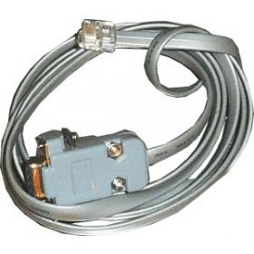

    Would anyone know if the RS232 cable needed to connect the driver to use Pro-tuner software, could I connect using a RS232 to USB please.

    I believe you can get a usb to serial adaptor you might have to reverse the tx and rx connections on the lead.
    Thanks Clive,
    Had not seen the thread, this is what I can get and would like to connect it to a laptop

    That looks like a RJ11 to DB9 you would also need something like https://www.amazon.co.uk/USB-RS232-C.../dp/B00077DJIQ
    or similar make sure you get a driver disc with it
    edit you might have to reverse the tx and rx wires as I said in the last post

    As Clive said, you need both the cable you are showing, and a USB to RS232 adapter to plug it in to.
