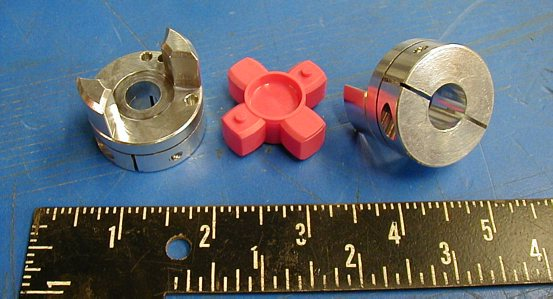

    Just measured the back-lash at 0.03mm on each axis. I'm a little surprised by this since I can't push/pull either axis by more than 0.01mm. The motors are coupled to the screws with flexible star-type couplings (see pic) - which are original and in good condition, but I have to say I've always been suspicious of. Now they are robbing me of precious microns!
    Seriously though I can live with 0.03mm.

    I think You have one of the best manual tools of this type (c frame small mills) ever produced.
    Your explorations/experiences/results are similar to mine, on a decent-rigidity heavy chicom 12x" lathe.
    Except that mine is about 10x worse in terms of fit, finish, quality in general, of course.
    I would opine, while never having seen a Fehlmann in person (is a tour available if I happen to be in Your country ..?),
    - repeatability to about 1 micron is very achievable
    - resolution to much better than 1 micron is available to You, and probably relatively easy to do
    My experience for 0.03 € (I need to make a profit, You know..):

    1. Go to servos.
    2. Go direct drive. There must be a reason all manufacturers use direct drive.
    3. Use a bigger coupler.
    4. Make anything used in the motion-control train very very heavy in steel.
    5. Use highest-resolution servos you can, while being relatively economical, and having sufficient speed in khz/mhz for your controller.
