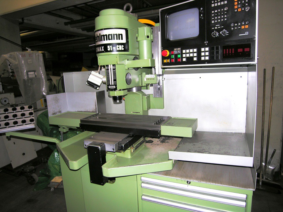

    Hi Hanermo2 and thanks for your very comprehensive and convincing post on your experience of servos. I'm coming to the same conclusion. Steppers are fine for hobby machines, but for anything a bit more industrial a servo is the way to go. Fehlmann certainly dropped steppers within a couple of years and went to servos.
    The Fehlmann is a slightly odd machine in that it's a drilling machine with milling capability - so despite it's industrial specification in terms of mass, the design is a compromise, with milling, and then CNC, as an afterthought. With that said they sold well in their home market. The latest generation of Fehlmann machining centres are built round a conventional square slide-way for the Z axis, but they still produce a manual and semi-cnc/manual version of the Picomax: http://www.fehlmann.com/en/products/...picomaxr-21-m/
    I was interested in what you mentioned about direct drive. When Fehlmann switched to servos (see pic) they mounted the motors remotely - not sure if it's a belt or gear drive, but suspect belt. The latest semi-cnc/manual of the drill mill that I have also has remote servos - I'm not sure about their machining centres.
    Having reassembled the ball-screw, replacing it proved interesting since the nuts, or rather the keys in the nuts, didn't want to go into the key-way. The key-way or the keys were obviously minutely out of line with each other. A rub over a stone got them to slide in, but the results from the screw were disappointing - still not sure why. It could be an alignment issue - which seems strange given the precision nature of the table and the screw, but it's the sort of thing I've regularly encountered with precision machine tools - a lot of fettling takes place when these things are built. Anyway, I decide to but the nuts on the in the original orientation which seems better, but I can't get the backlash better than 0.01 without sacrificing the smoothness of the screw. I will tinker some more today.
    I've had 20 years experience rebuilding machine tools and generally I've found that even if a bearing's tracks look good through a loupe they may well be slightly rough when under load. This is sometimes due to poor fitting (hammering the inner) and tiny imperfections are left on the bearing tracks which will only show up under a microscope. I suspect that the ball-screw and nut assembly have similar issues. I'm not about to replace them so will live with the 10 microns of backlash.
    Thanks for your offer of the Kluber Isoflex. This is a product I'm familiar which since it's specified by some of the manufacturers I deal with. I actually use an SKF LGMT2 which has a similar specification and was more readily available at the time I needed it. In fact the Fehlmann's central lubrication system covers everything from the spindle bearings through to the ball-screws and everything in-between. The Vaseline used was just to get the balls to stick to the nut during assembly - it will soon wash out.

    Spent the evening trying different permutations of the ball-nut assembly and the best I can achieve on both axes is 10 microns. If this were a conventional manual machine I'd be overjoyed with 4 tenths of a thou! In fact the very expensive Swiss machines that I sell have a backlash from new of around 0.01-0.02 mm.
    Anyway, the machine is running very nicely and the back-lash compensation on Mach3 is working well.
    As I frequently say to my customers "it's a metal cutting machine not a grinding machine" so I don't expect nor want to machine to tolerances better than +/- 0.005. I certainly don't think it will be a problem in respect of climb milling.
    More soon...

    Swiss backlash 0.01 mm new ??
    I would have expected your picomax to have zero to 0-1-2 microns backlash.
    I suspect the bs fixed end bearings are not properly adjusted/preloaded, or ..
    .. your ballnut is loose/failed somehow and has no preload.
    Easy enough to test.
    Dti screw end, while loading back/forth with a prybar of some type, separately on screw end and on nut end/assy.
    One should have a major deviation vs the other.
    Quote Originally Posted by Agathon View Post
    More soon...
  8. #58
    I've checked everything and it's all correctly adjusted - first thing I thought of was movement in the pillow-block bearings but there's no movement here. If I take the ball-nut preload one increment higher on the vernier the screws become notchy. It's probably just down to wear and tear. We'll see what the performance is like in practice.
  9. #59
    You are being very vague, is this sprung or a simple crush?
  10. #60
    Crush.
