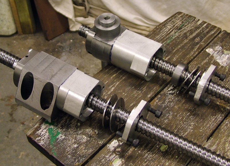

    It was a bit of a bodge springing mine, I added a spacer and 2 Belleville washers. Well 6 spacers and 12 washers to do all the bearings and nuts. But the reward was out of all proportion to the effort.

    So, if I'm interpreting that correctly, you have a double ball-nut set-up like my machine?
    I could do something like this although it would mean making a new retaining flange. I have to say that apart from grinding spindles, I'm not a fan of spring-loaded solutions. I'm also not convinced that backlash of 0.01 is much of an issue. My conventional mill has about 0.25 backlash and it's only a problem with heavy climb-milling or slot milling and then it can be overcome by reducing the feed rate and the depth of cut. Mind you the table and slide alone must way 200kg - mass helps, as do well adjusted gibs.

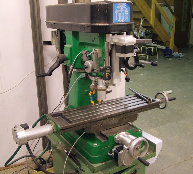

    I meant to have asked what the rest of you mill consists of Robin - got any pics?
  3. #63
    I don't have a recent pic, here's an old one...

    Very neat, especially the Z axis. Wouldn't mind seeing some details of this as I'm sure I'm going to have to go down this route eventually.
    What sort of backlash have you achieved on the x and y?

    There's a build log from many years ago, I will try and link it...
    http://www.mycncuk.com/threads/651-W...ht=Warco+Major
    I fitted zero backlash double nuts, big disappointment, so I sprung them and it was like magic.
    The springs mean that I have no backlash up to 1/4 ton but if I ever pass that loading presumably everything will go horribly wrong.
    I do get some sideways slop in the quill if I forget to pack it out with thick, icky grease. Open to suggestions.

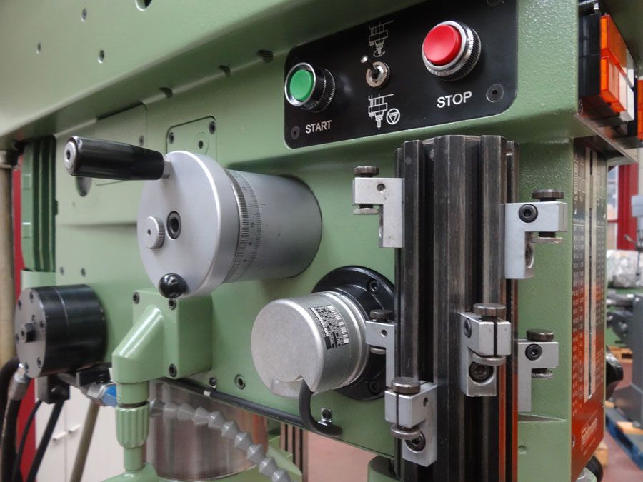

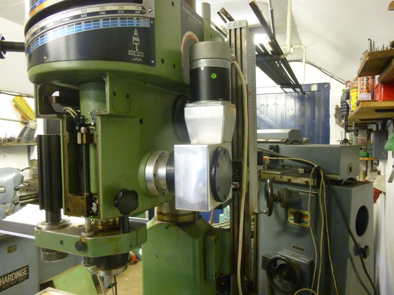

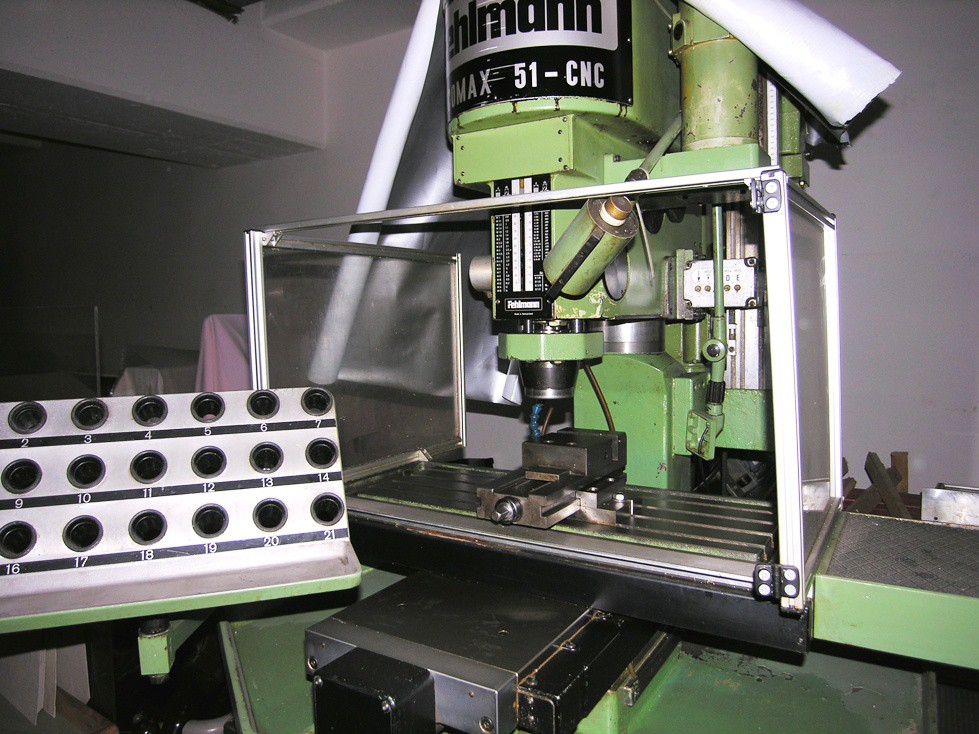

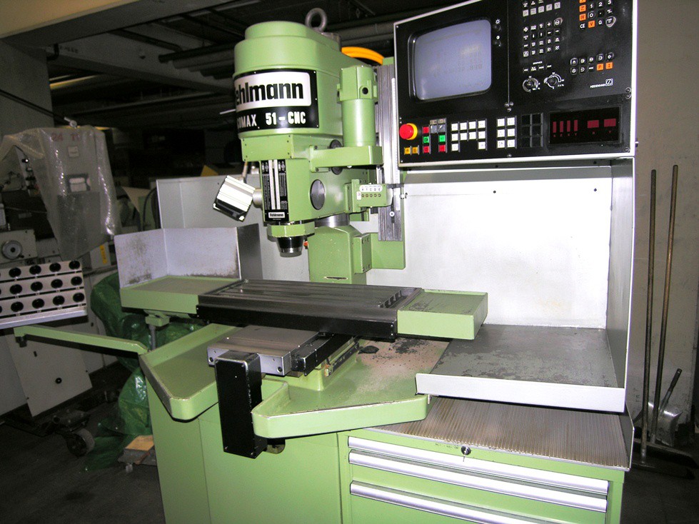

    I've only just started working on the old Fehlmann again after a couple of years of inactivity. My machine is a pain as it was originally only two axis. The Picomax 100 was a three axis machine that used the quill rack and pinion driven from a worm and wheel belt driven from a servo as the Z axis. It sounds like a terrible idea when one thinks about the average drilling machine rack and pinion, but being Swiss there's virually no backlash. As I mentioned earlier in this thread, the extremely clever engineer I bought the machine from had made a worm and wheel drive (the aluminium housing seen on the right hand side) to drive the pinion. However, I have found that because he used a fully throated worm wheel it has been almost impossible to remove the backlash.
    I will probably end up using a ball-screw to move the quill, but I have recently reinstated the machine's original worm and wheel drive (which employs a gashed bronze worm wheel) and have backlash of about 0.01mm - not bad. I shall see how it works in practice once I have mounted the stepper motor to the original 90º cross-helix gear drive to the worm shaft. There is significant backlash in this gear, but it will be unimportant in terms of the ability of the quill to remain in position because of the worm and wheel - the backlash is constant so it can be accounted for in the software. As I say, this is almost identical to how it was originally done on the three axis machines, however, it has proved difficult to employ a belt drive to the worm shaft due to differences in the head castings - see drawings.
