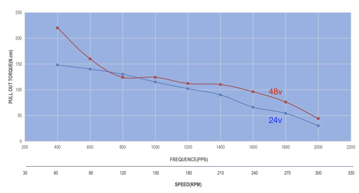

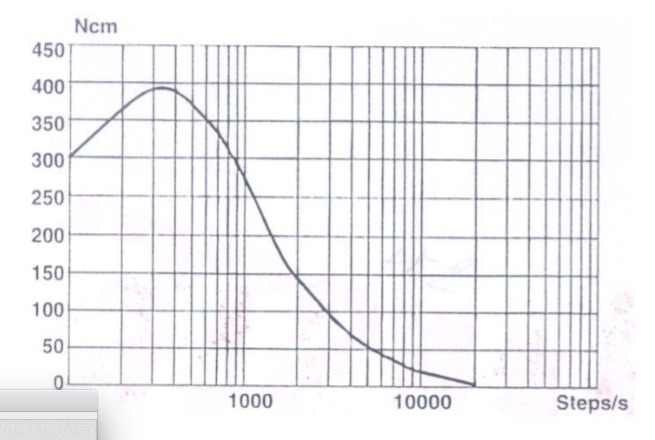

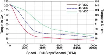

    I have been puzzling about using Nema 23s with a reduction drive, but can't see how this will help in my situation. If I wanted to achieve 1000 rpm at the feedscrew the motors would have to run at twice that speed with the inevitable massive drop-off in torque. Even if the torque itself is multiplied by 2:1 (which it won't due to losses in the drive belts etc) the torque of the motor is likely to have dropped way below any mechanical gain. I can see how it helps with gaining torque at lower speeds, but looking at the torque curves of even the lowest induction and rotor inertia steppers it looks like less than a zero-sum game to me since their torque drops down to less than a third of their maximum. By the time any motor gets to having nearly 7000 steps a second they're going to have no torque at all. These topsy-turvy stepper things do my head in!
Name:	Nema23 torque.png
Name:	typical torque curve.jpg

    I'd like to get my hands on one to see, but the torque curves look more akin to those of a stepper system, than a servo system. Stepper and brushless motors are very similar, it's just stepper motors are synchronous (which is what gives them the detents), while servos are a/non-synchronous, which means you don't lose power/torque overcoming the detents.
    Regarding the Nema 23 v 34 argument. Compare them running similar voltages. You'll generally find Nema 34 graphs are using a high voltage driver, while Nema 23 are done using a relatively low voltage driver.
    I've just had a quick look to see if I could find a couple graphs to do a comparison, but the Nema 34 graphs I found were mostly using a 110VAC supply (about 155VDC), while the Nema 23 ones were using 30-40VDC supplies. At those low voltage, torque drop of is very noticeable, and crippling Nema 34s with only 70VDC also makes for a very similar torque drop-off. You need voltage to over come the back EMF at speed. Without that voltage, torque at speed is very limited.

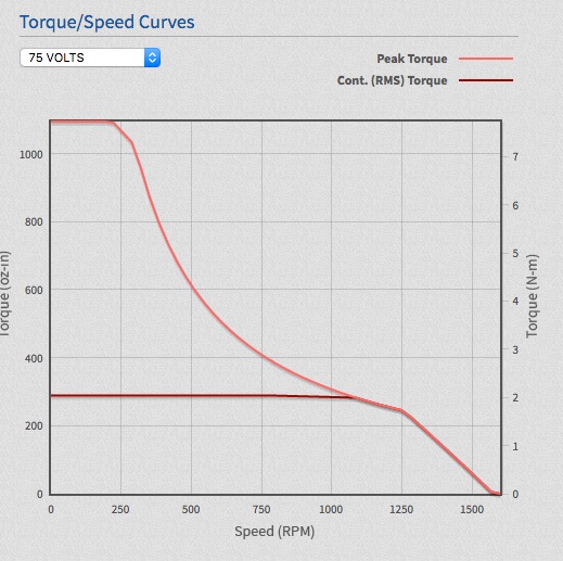

    I have to say all this stepper and servo stuff is new to me. I'm very familiar with squirrel cage motors and vfds, but steppers, and now servos are a very steep learning curve. I know what you mean about the Clearpath graphs, but Teknic have stated that they are servos and not steppers. Their torque curves are certainly much more healthy at speed than any stepper graph I've seen (which admittedly isn't that many). Certainly when you compare the torque/speed graph of the Clearpath 2.04 Nm (rms) (CPM-SDSK-3421S-RLN) servo I was thinking of buying to that of the Astrosyn 4.8 Nm (holding torque), there's no competition. Where the Clearpath has no problem producing its nominal rms torque at 1000rpm the Astrosyn has fallen to something in the region of 0.9 Nm at around 3000 steps/s (900rpm).
ID:	22120Click image for larger version.
    Just as an aside, if the Astrosyns were geared 2:1 they'd only be producing 0.4Nm
    Having looked at the torque curve more carefully I see now that with my table axes running at 2000mm/min that the motors should be producing something in the region of 1.7Nm - which should be fine and indeed seems to be so. I can also see why increasing the speed by 50% causes them to lose steps as they've lost 0.5Nm in torque
