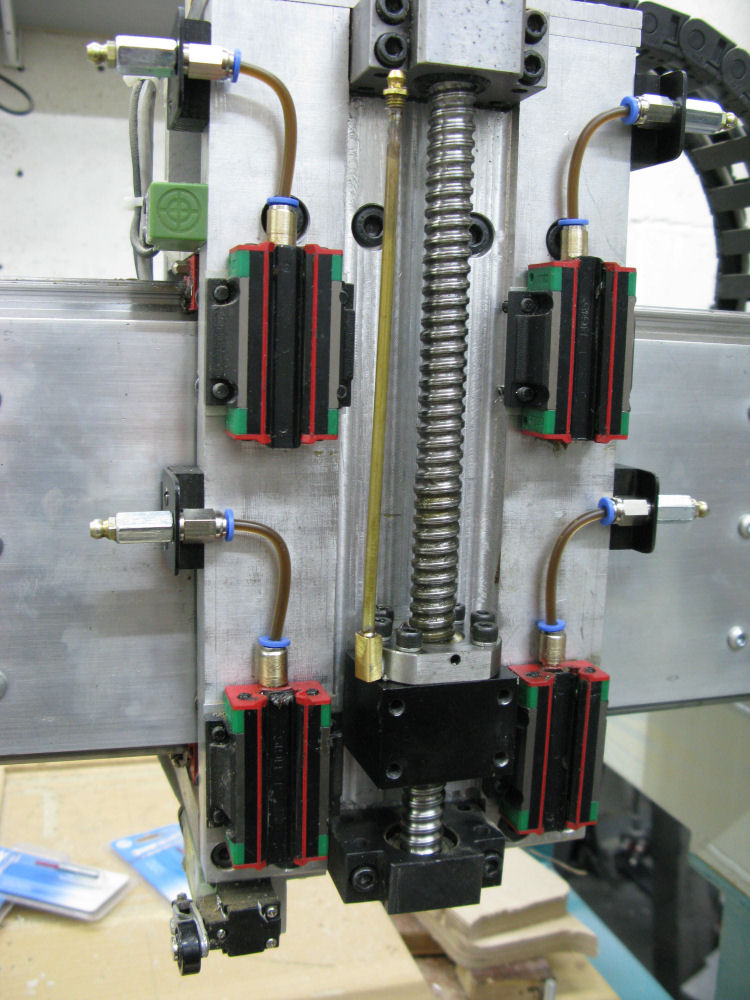

    I used 15mm rail and blocks for Y and Z but never again. They work fine but unless they have changed the design, getting grease into them is damn near imposssible.
    See this thread; http://www.mycncuk.com/threads/7273-Greasing-Hiwin-HG15
    This was my solution if it's any use to you.

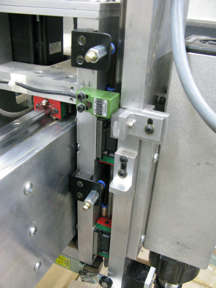

    I got some 4mm tube, push fittings that I turned down to fit in the gap, and there was just enough 'meat' on the push fittings to reduce the 5mm thread as supplied down to a 4mm thread that fits the Hiwin bearings.
    Fitted some brackets with 6mm thread push fittings, 6mm thread nipples, and 6mm hex connectors.
    It now works very well.
    I also fitted a home made extended brass grease pipe for the Z ball nut grease nipple.
    Pic1 shows it with Z front plate removed, pic2 shows it reassembled.

    Nice Mr Current!! What kind of grease are you using for those bearings?
  4. The Following User Says Thank You to Nr1madman For This Useful Post:
    Some of the links I used a while back are now dead but at the time I found some cross reference charts and worked out that for light duty use Lithiun EP1 and heavy duty use Lithium EP2
    this is the one I use ; http://www.toolstation.com/shop/Auto...0/sd180/p89691
    Read this; http://www.intercom.si/web/dokumenti...LI_EN_V1_1.pdf

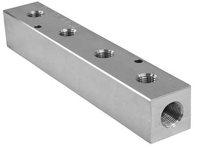

    Nice little manifold would be easy to nock up:
    You can buy them in various flavors as well: 1/4" PT Threaded Ports 3 Way Quick Connect Air Hose Manifold Block Splitter
    Or another member did his with one of these push fits: Pneumatic One Quick Push to Connect Union Manifold Connecter 5 Way OD 8mm
