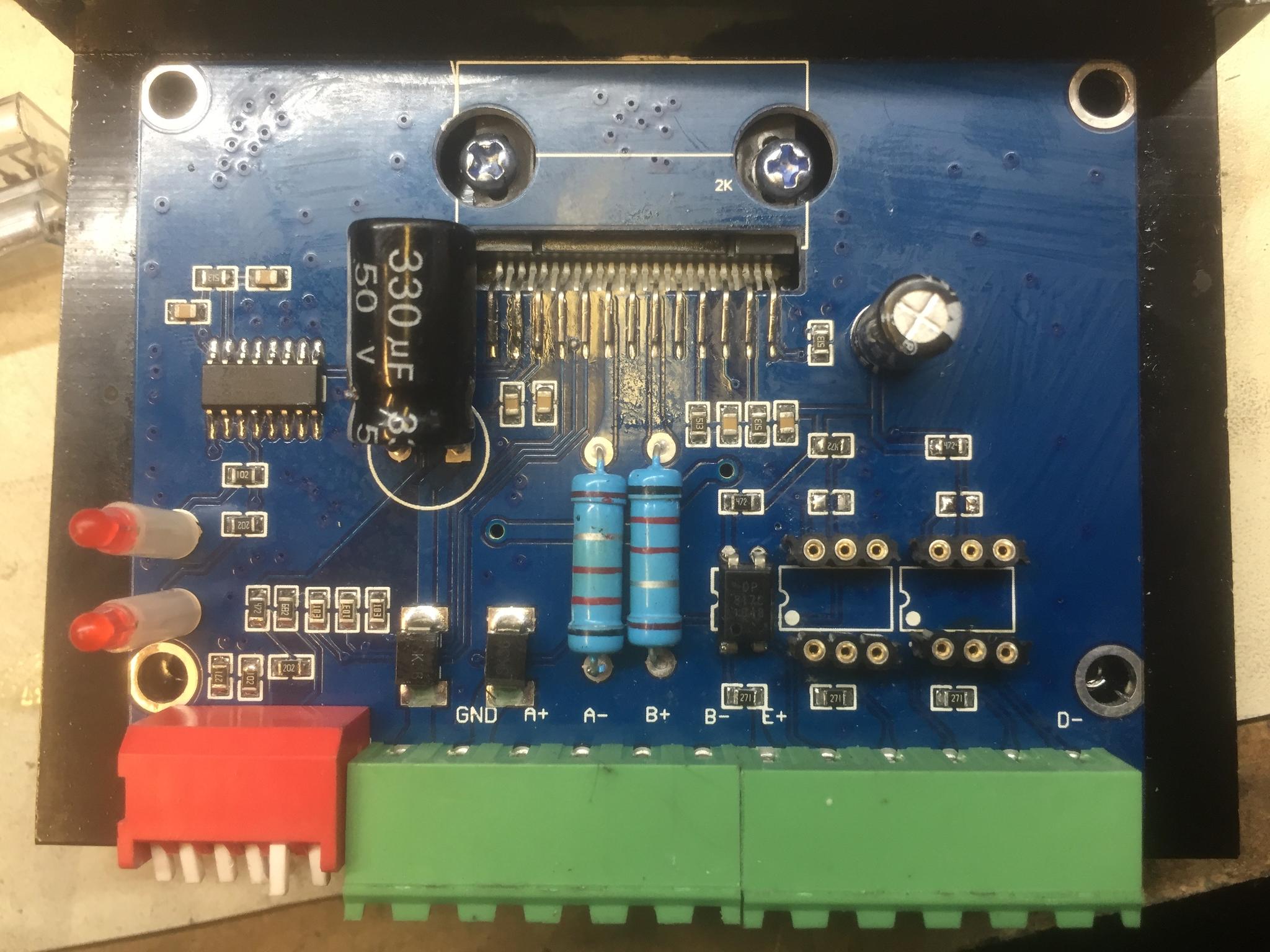

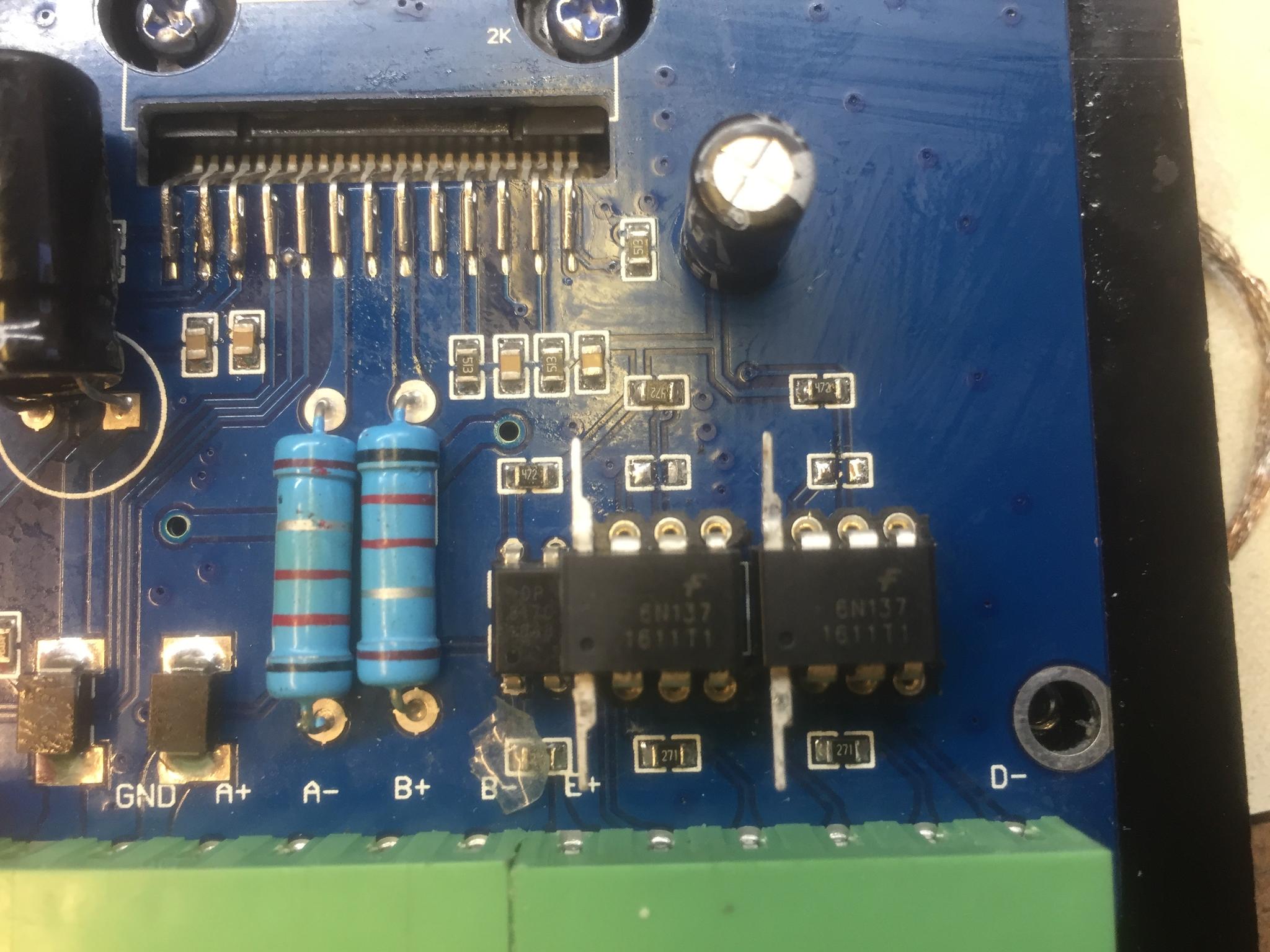

    Here, you can see that I've remove the 2 6-pin Opto Isolators (lower-right) and the two base-pulldown resistors (just above each opto isolator). I've soldered in 2x3 pin SIL headers for each opto-isolator to accept the replacement 6N137s.

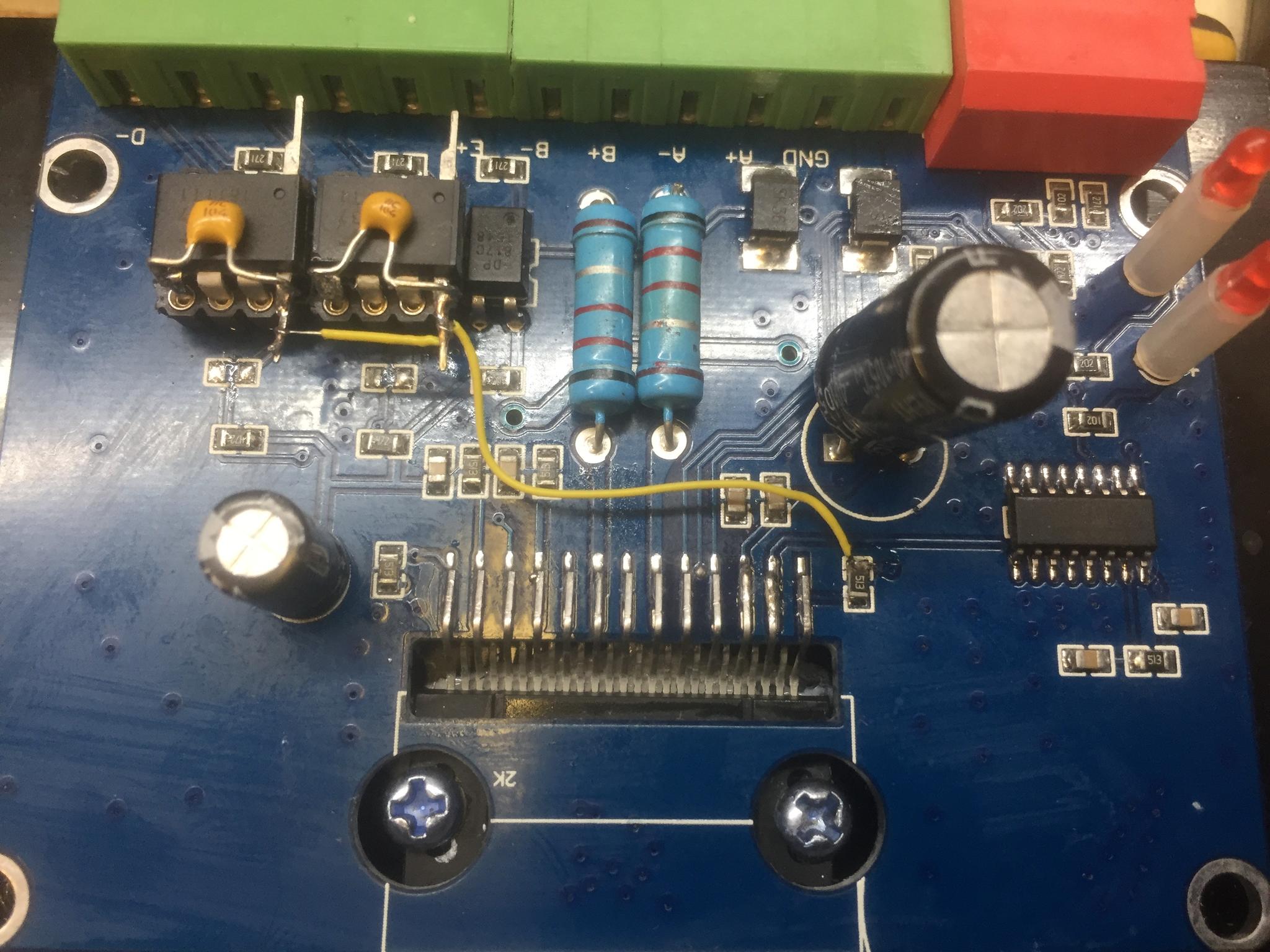

    Here, I've inserted the 6N137's, bending pins 1&8 away from the PCB (no holes for these). Pin 1 is N/C, pin 8 is +5V. Also, according to the datasheet the 6N137 requires a 100nF capacitor between VCC and ground (pin 5). So...
    I've strapped capacitors across the supply to the 6N137 and sourced a +5V supply from the SMD resistor near the TB6600.
    Reassembled the driver, and tested. A-Axis was perfect - responding to much quicker acceleration and max speed than previous and faultless in terms of lost steps. Tried one of the remaining drivers - back to the usual poor performance. So, an evening in the shed later and I've upgraded all 4 of the drivers and reassembled the cabinet. Operation is now perfect, as far as I've been able to test.

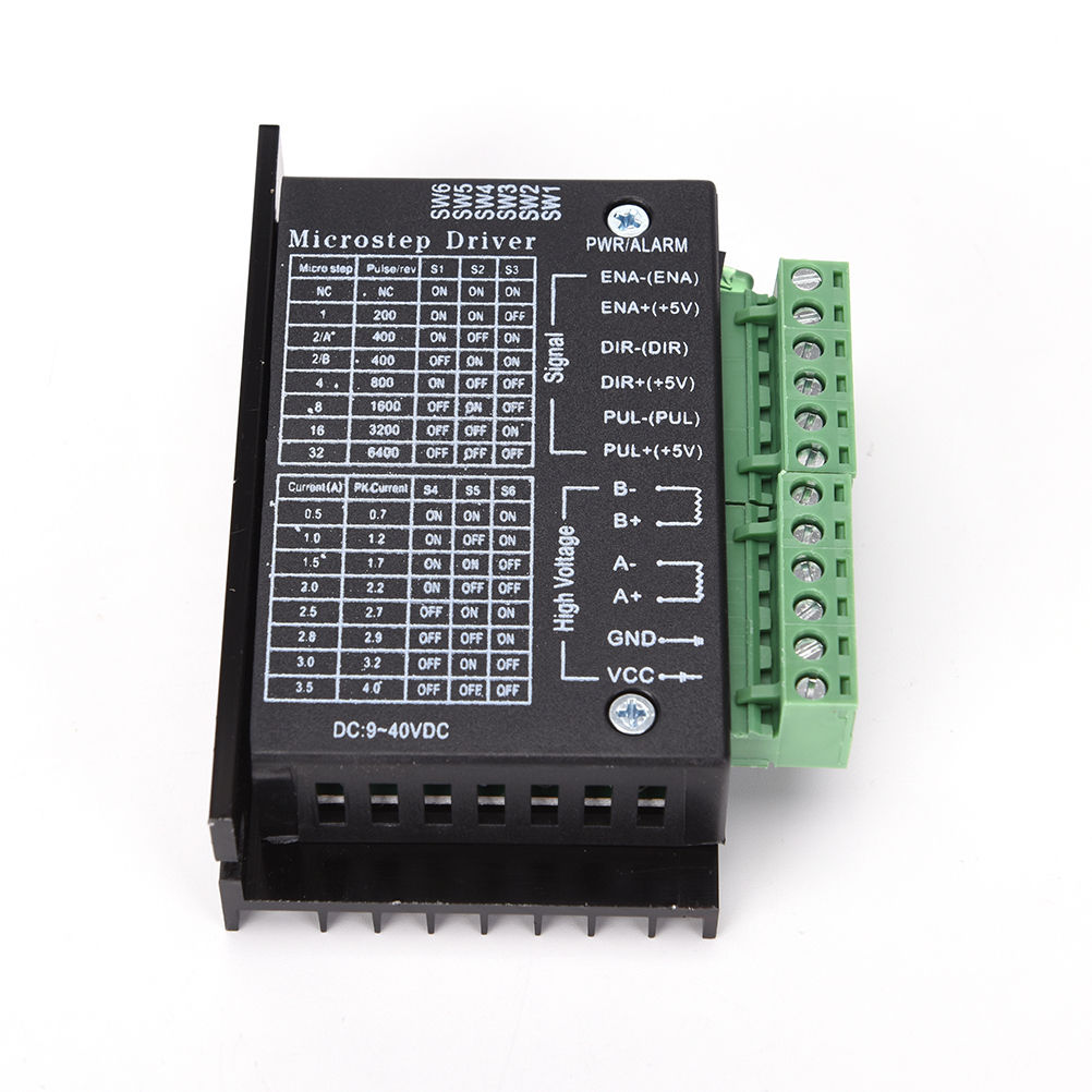

    I'm also using TB6600 based controllers... these super-cheap ones:
    and they're fine apart from after about 10 minutes any of X/Y axes will die, all indicator lights off on driver, until I power cycle it. They don't seem very warm and they don't auto-recover as you might expect if it were overheating. It's perhaps too different from your circuit but maybe someone here recognises the problem.
    Over current? Totally dodgy circuit / waste of money?
    Any suggestions appreciated!
    (36v 15A power. driving fine using GRBLv1.1. Failed on highest power and the one down from that)

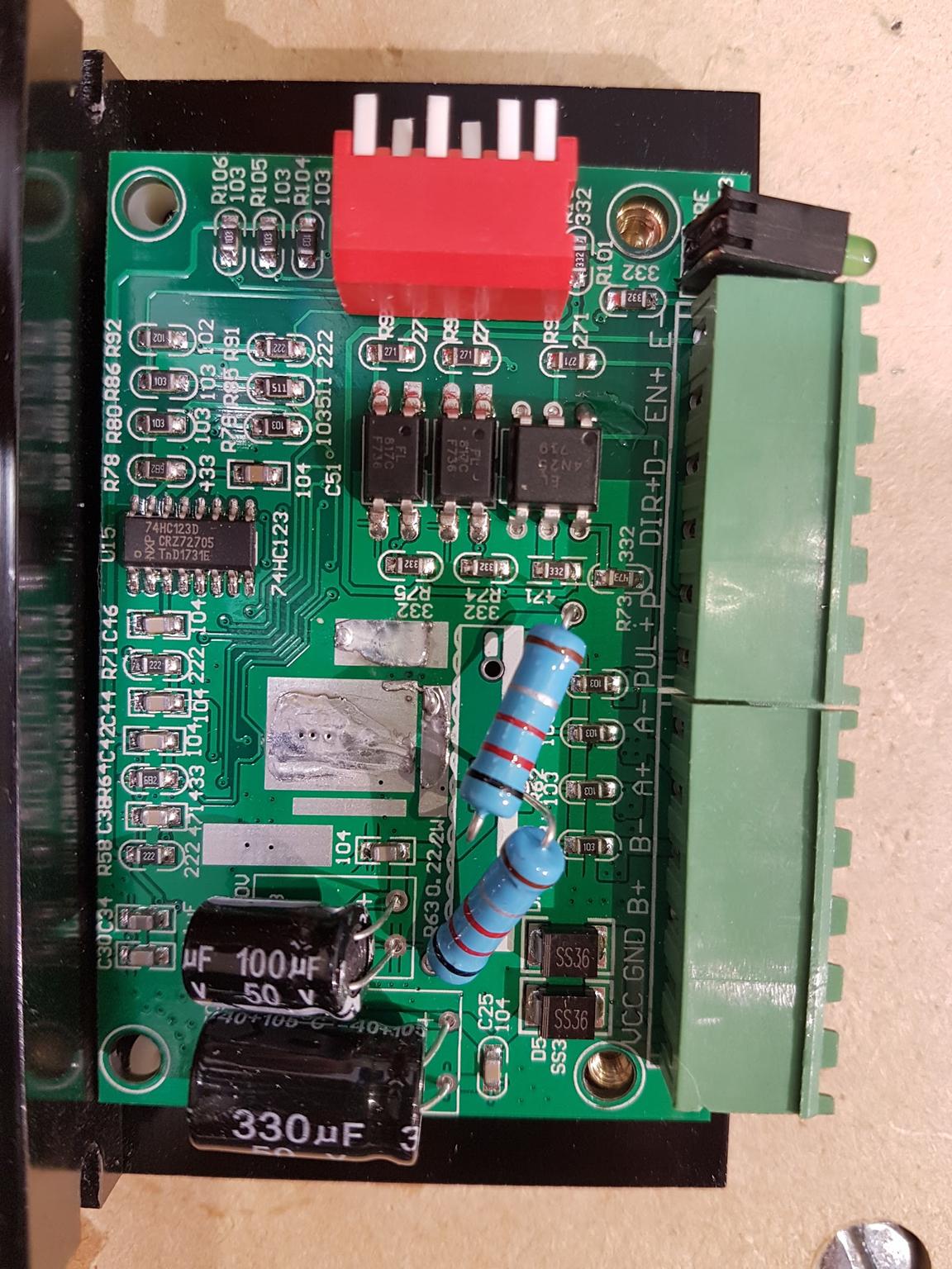

    If you could remove the cover and take/post a photo of the circuit board I'd be interested in comparing. Only advice is - when reassembling only tighten the case screws lightly (the plastic mould form for the screw hole tends to float inside the case - so if you tighten the screws too much it will snap the plastic.

    Happily! Here it is:

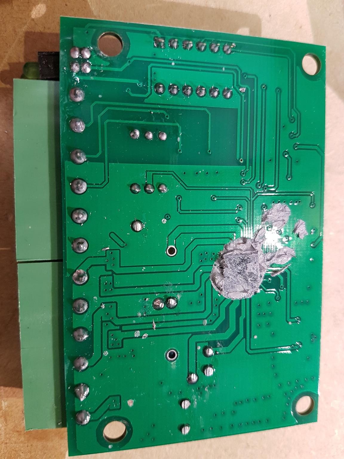

    the back showing the tiny chip:

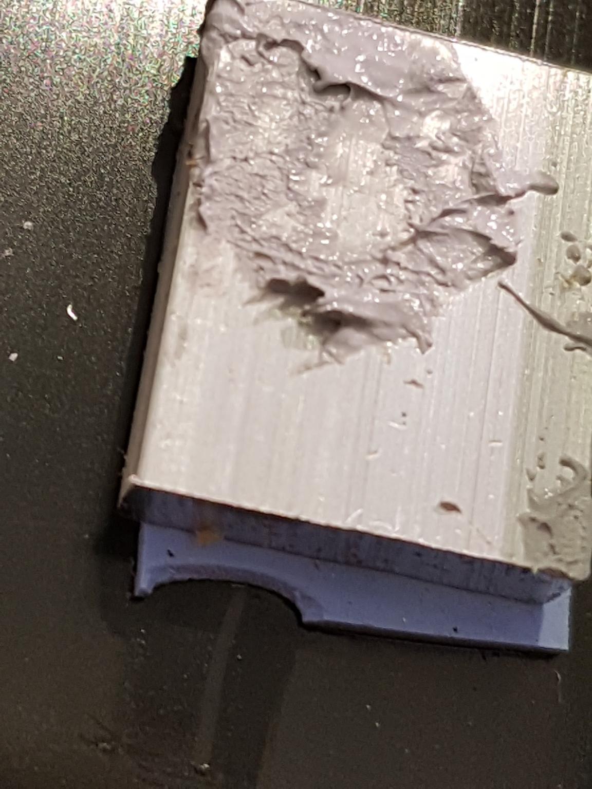

    and the block that sits on it (connected by some purple mat to the actual heatsink):

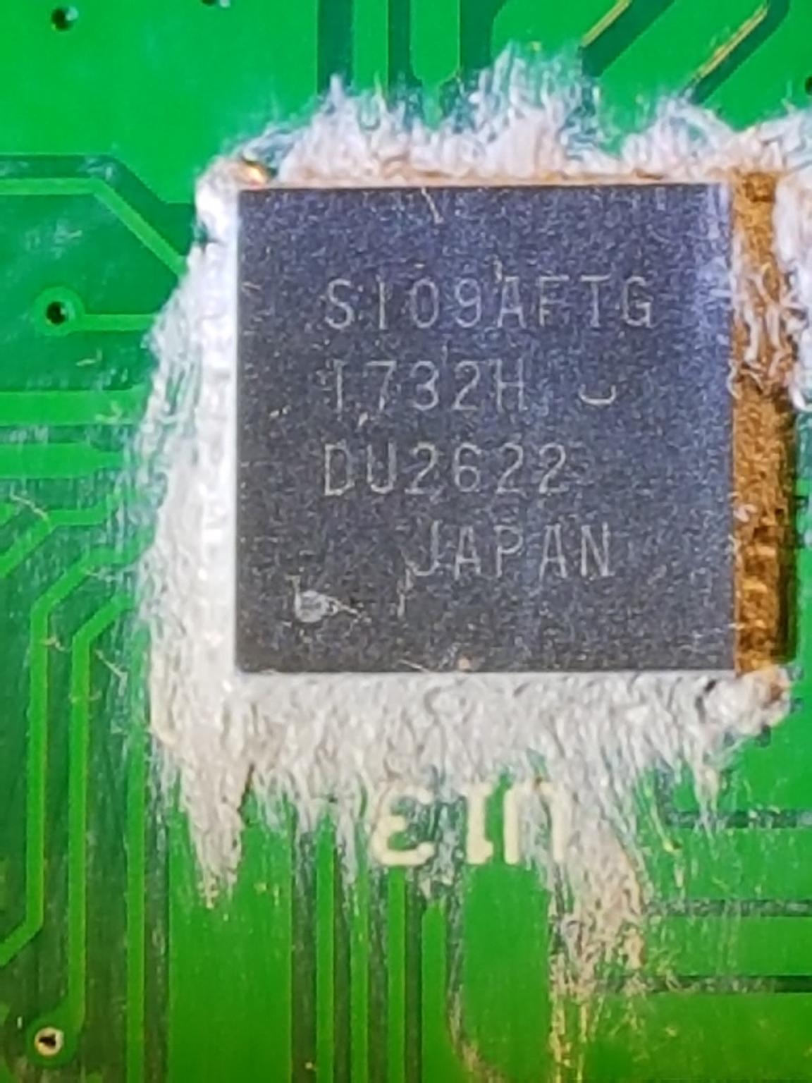

    I expected it to be like the 6560 in size! It's labelled S109AFTG - I've been sold a totally different board
    OK looking into datasheet, the TSD and ISD modes on this chip require more than just disable/enable to recover, so it's probably one of those, and since it's happening towards the end of a job it's maybe pointing more towards TSD error. Will reset heatsinking and try again.
    OK, opened all the boxes, reduced clearance to heatsink and replaced foam pads with silicon grease. Heat sinks now getter hotter and no fail yet...
    -Phil
