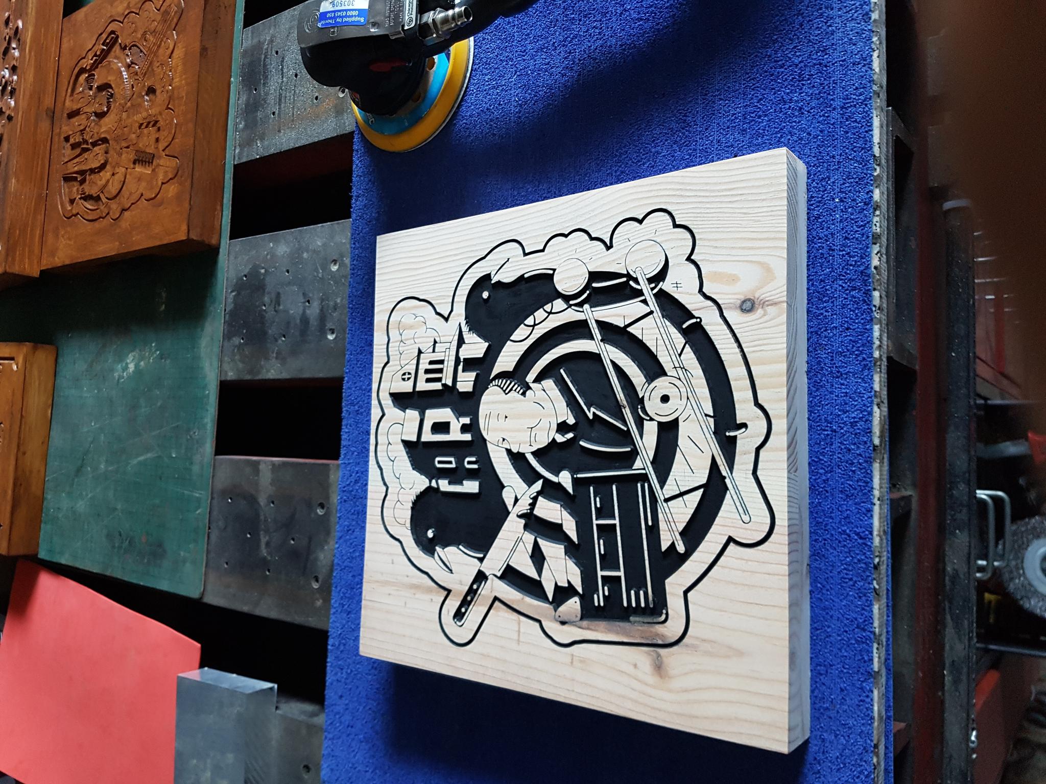

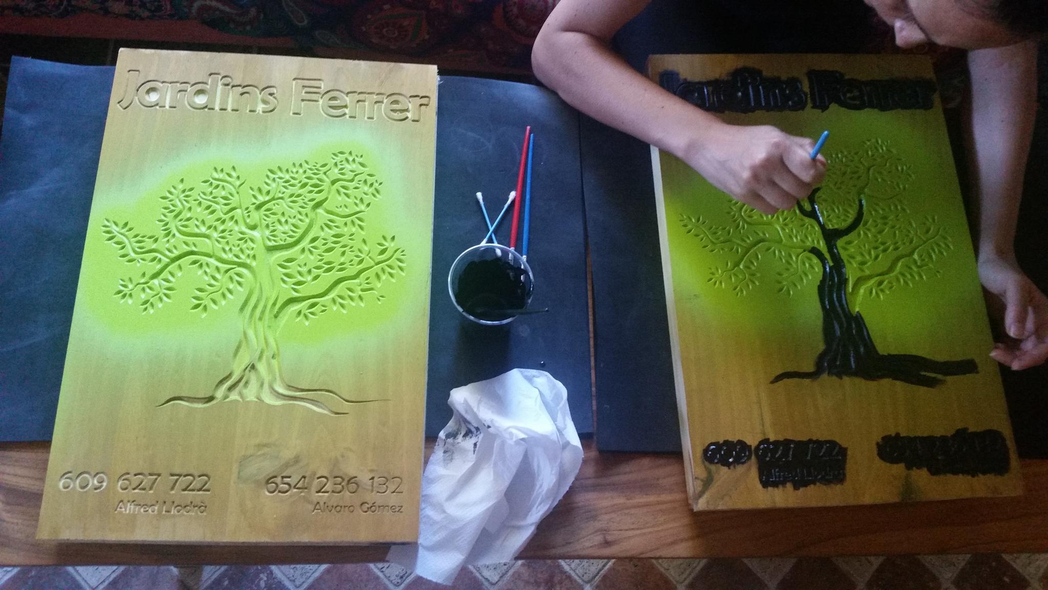

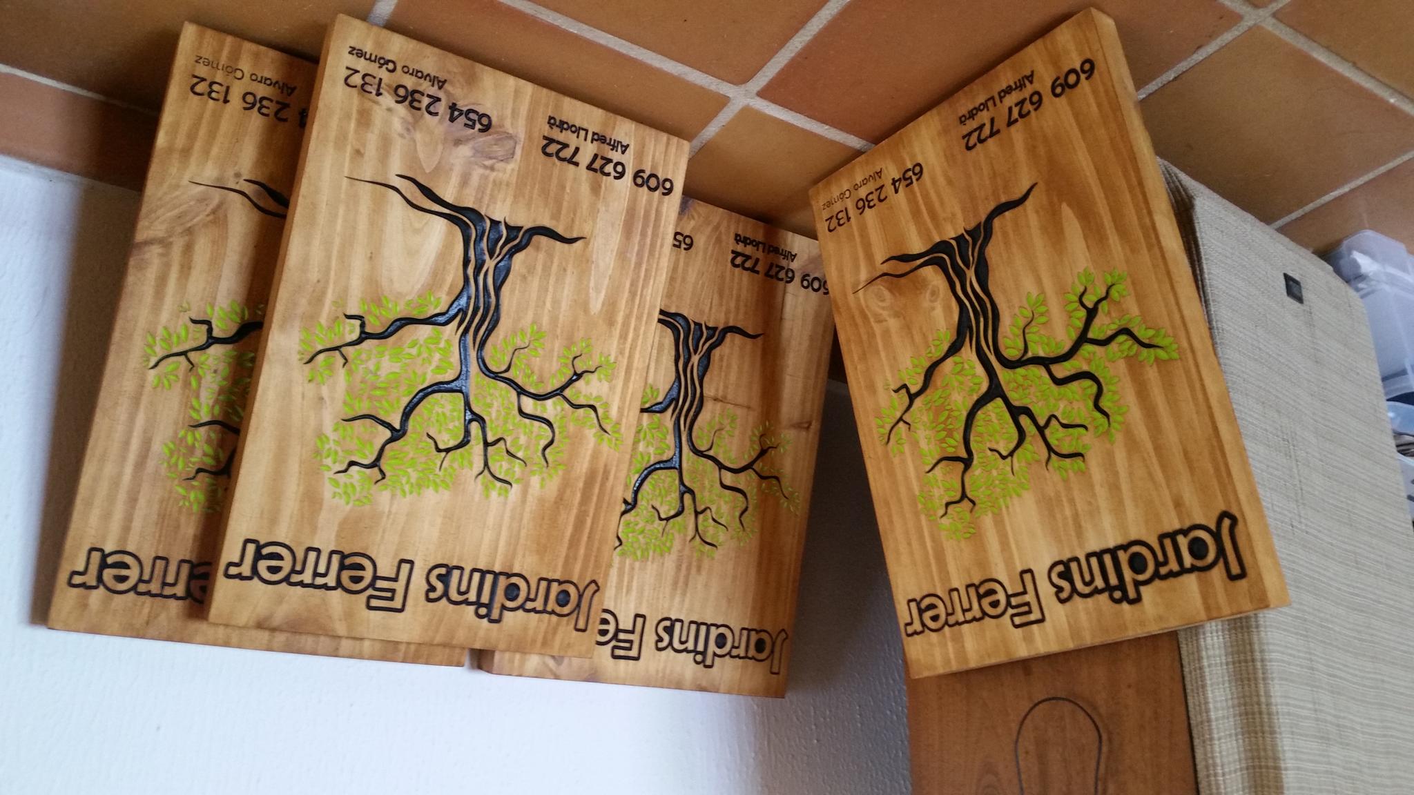

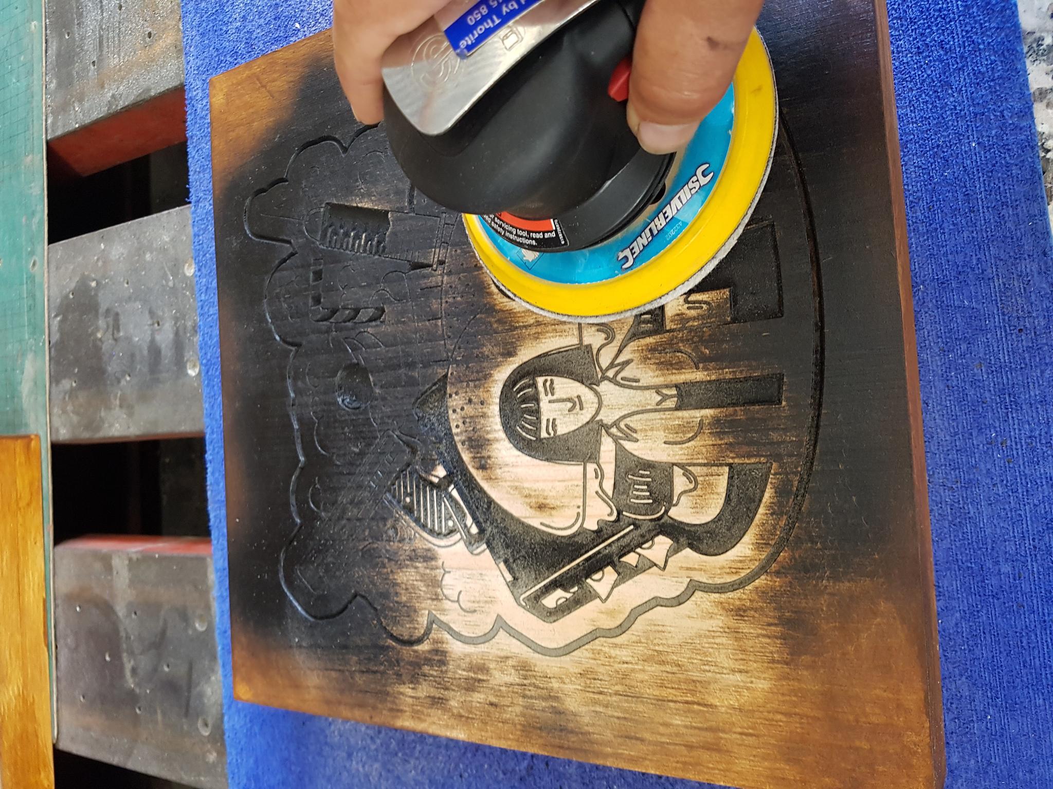

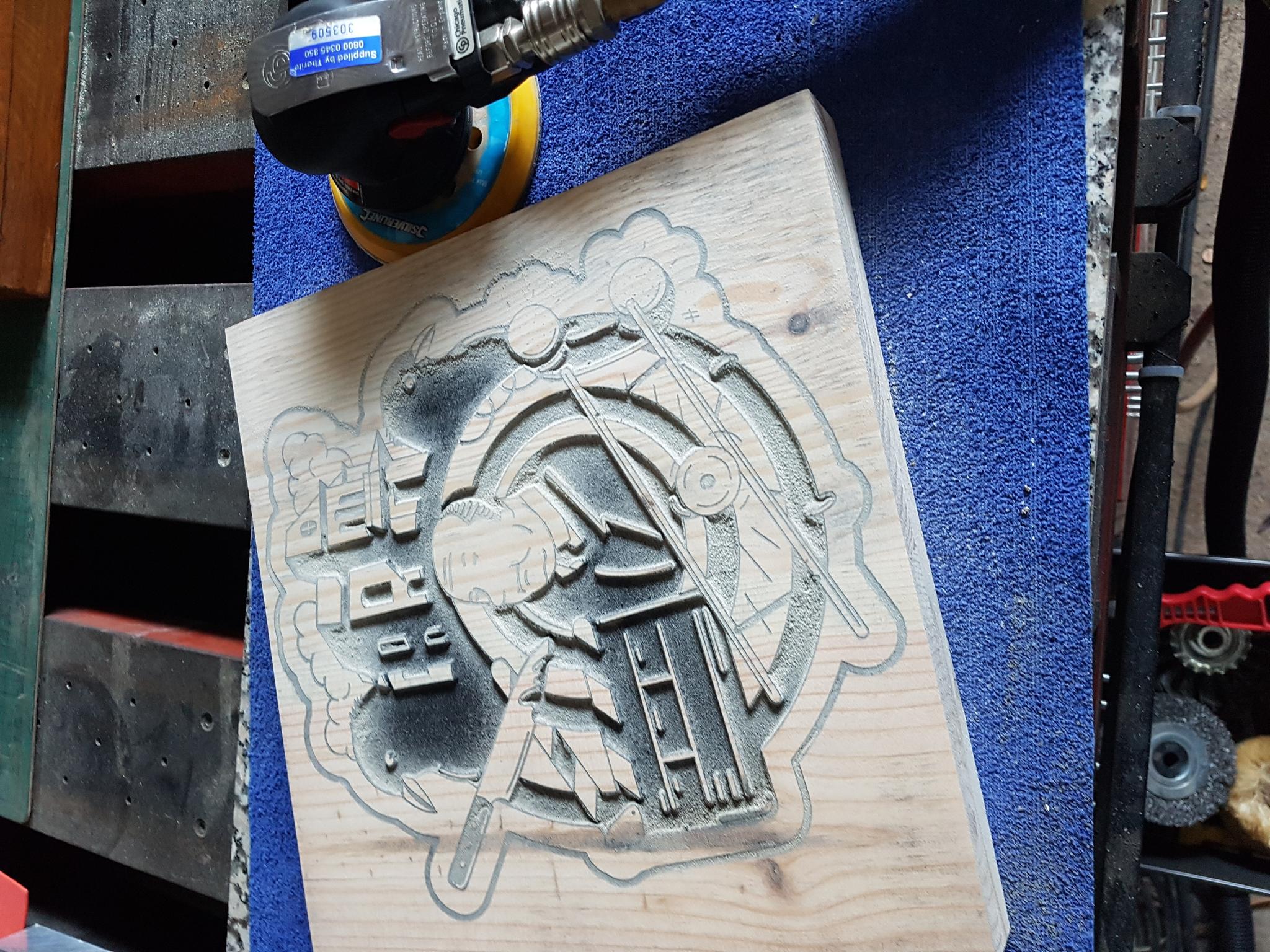

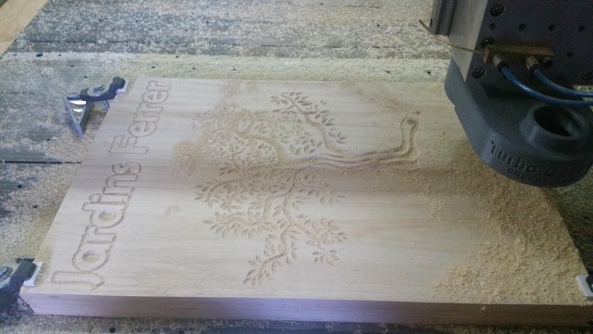

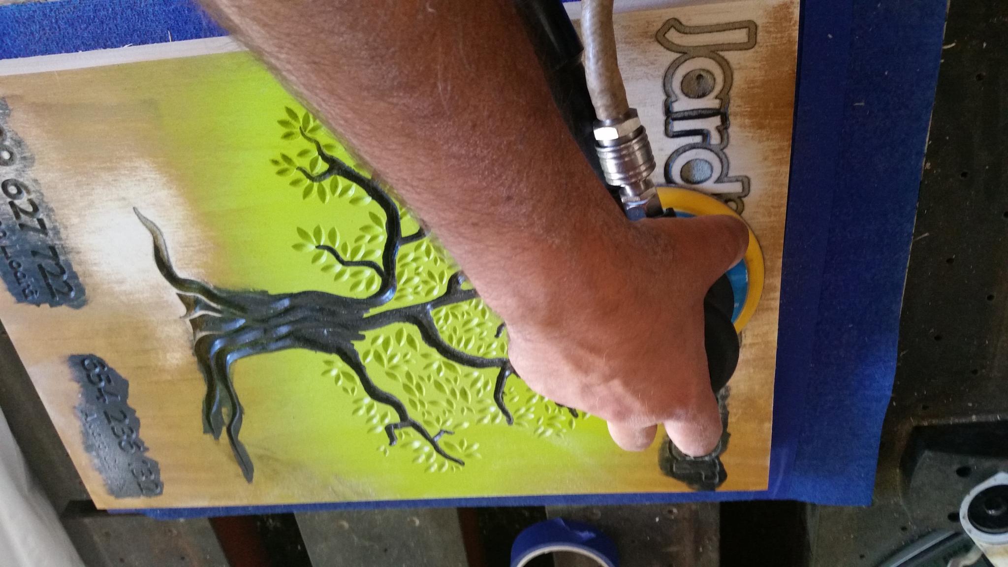

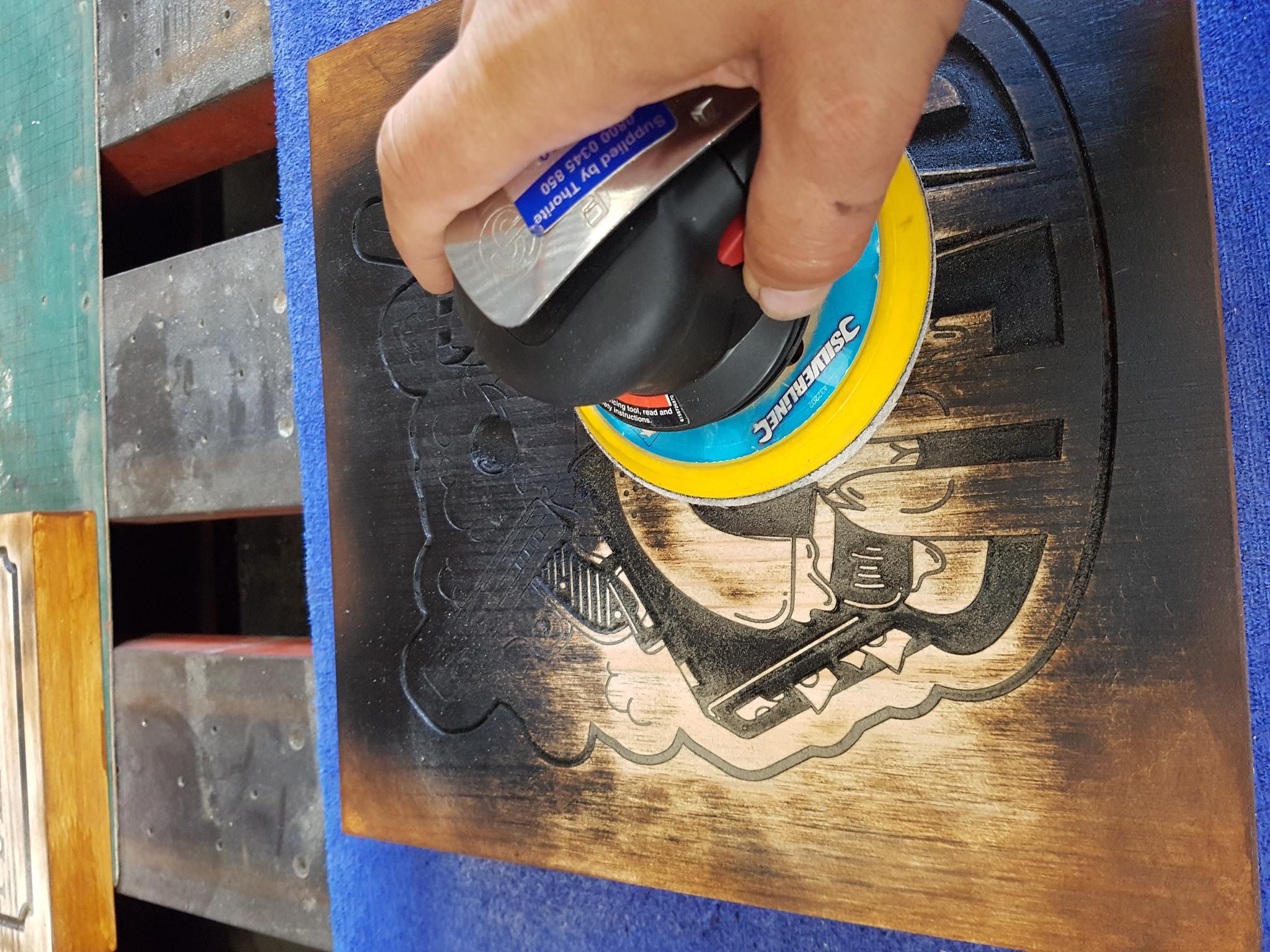

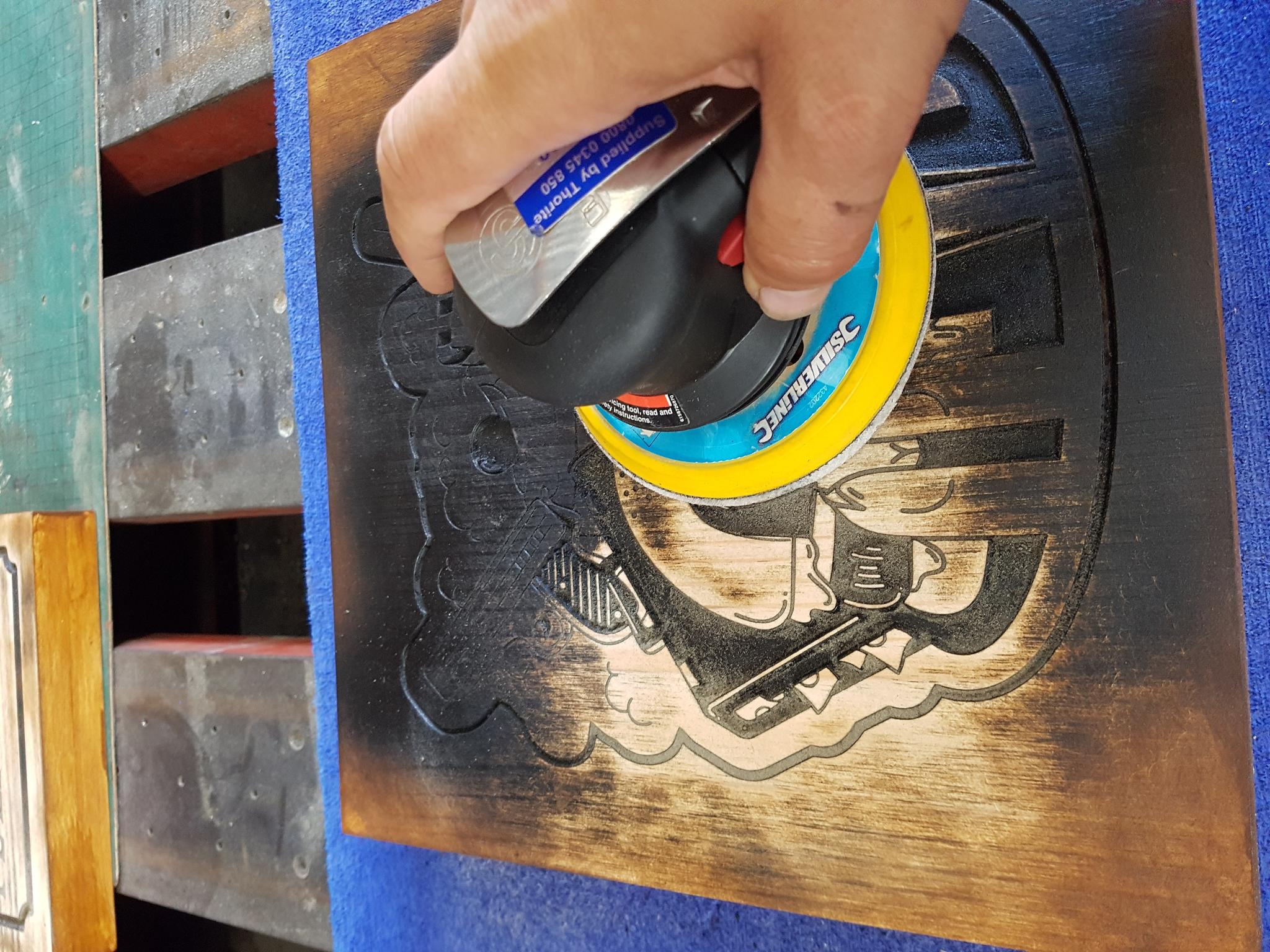

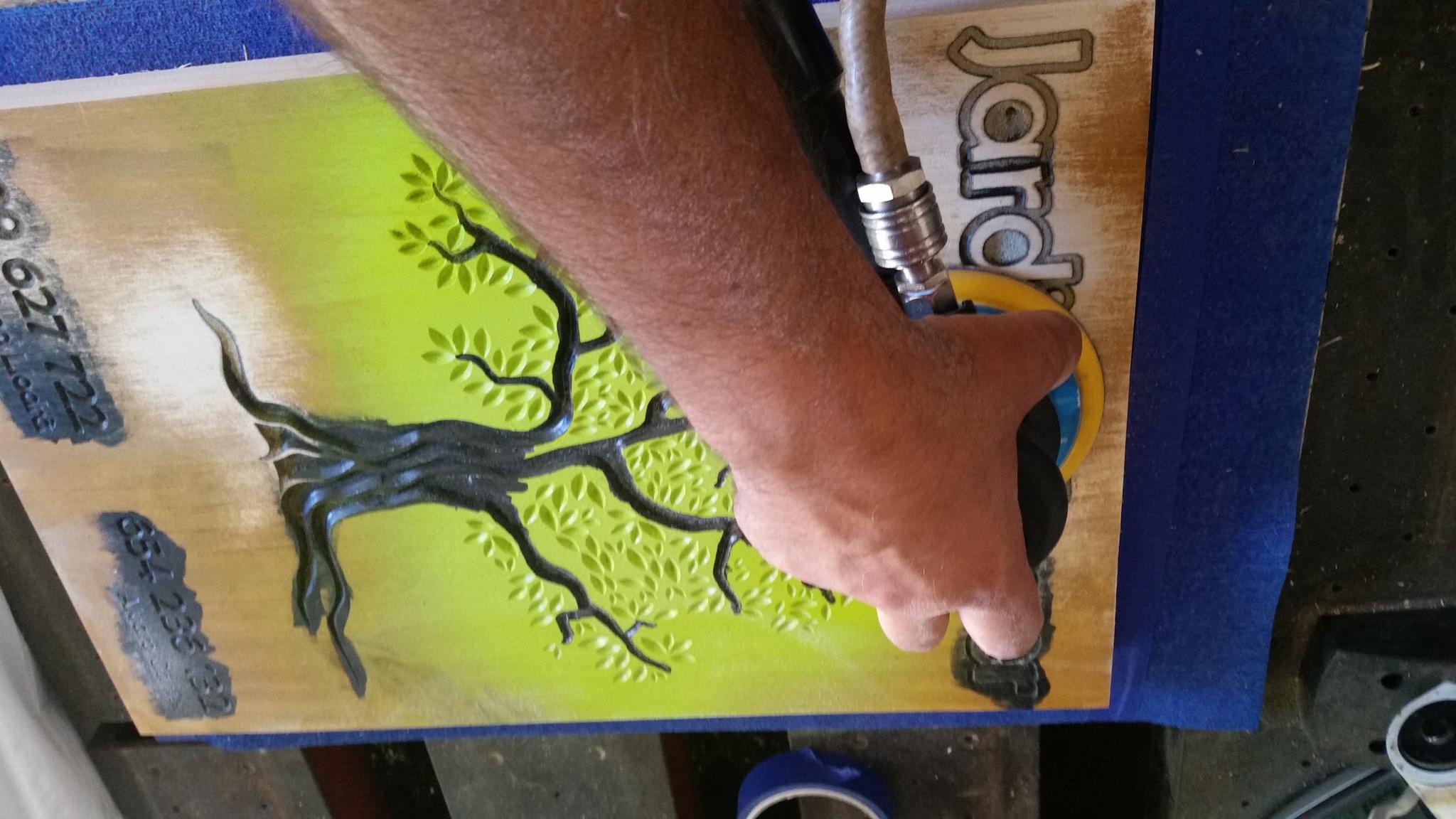

    I have tried all possibilities and here is my advice if wood, as possibly all other scenarios lead to a fault or mediocre quality:
    1.V carve
    2.Sand a bit the edges and clean the V channel perfectly
    3.Find the best quality and fastest dry impregnation lacquer for outside wood. Best works water based urethane.
    4.Paint more or less, paint back if needed, paint sides if needed. Dont care for inside of channel
    5 Let dry recommended time
    6. Use only 2 component Urethane paint. MIx and paint the channels without caring if you make all thing dirty.
    7.Let it dry for a couple of hours
    8. Sand directly with 100 and up sander. If you have a good sander thats it. If not sand up to 240.
    9. Arm yourself with a sponge and apply finish with careful brushing movements so as the paint or lacquer not to go in the channel
    For metal:
    use only 2 component base and paint. Sand face down on flat plate, do not use polisher. Or if using polisher, do that after the base , then spray color and then fast clea with acetone very carefully the polished part that need to be seen.
    Here is an illustration of the process. In fact exactly what i am doing today:

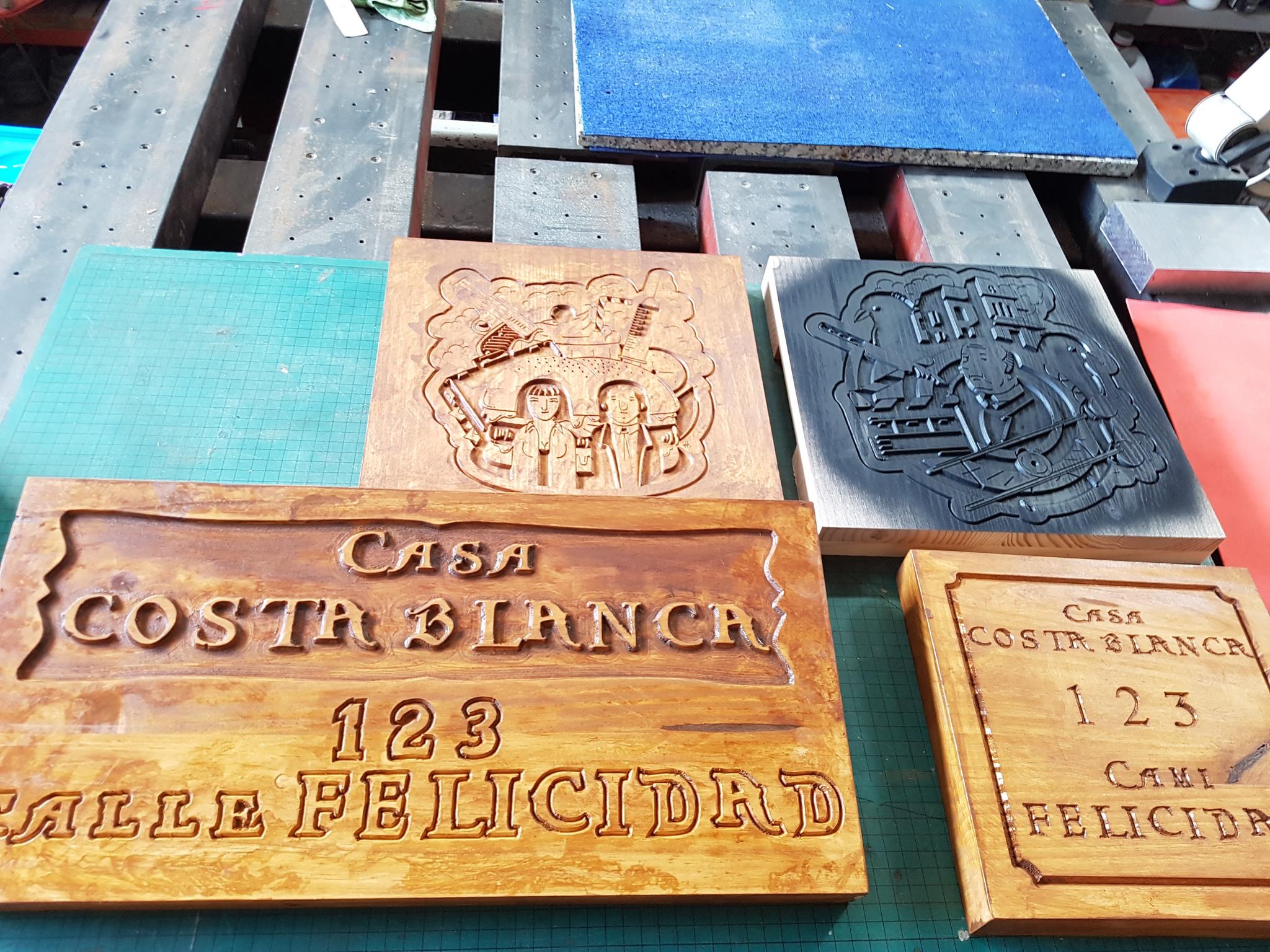

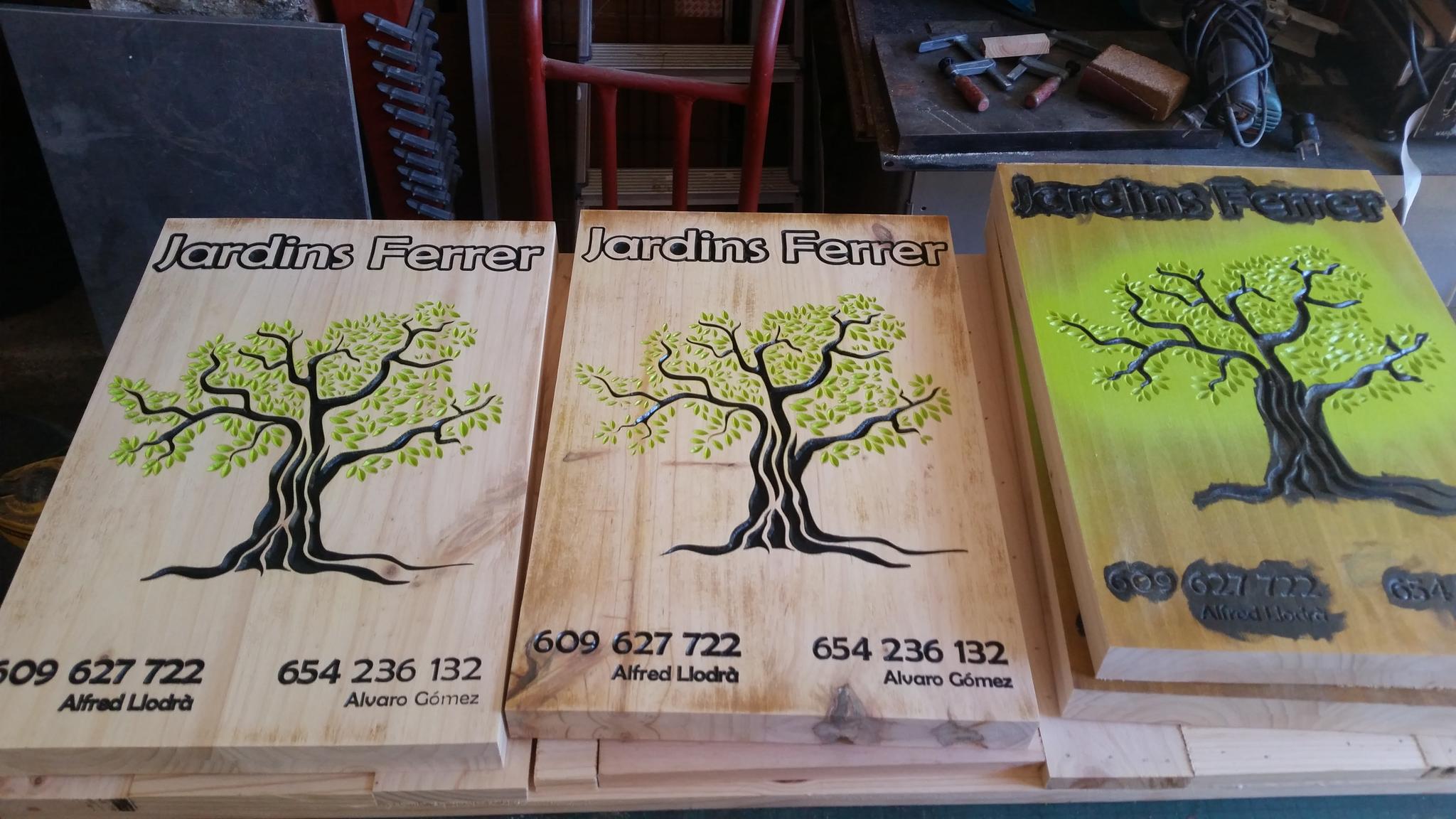

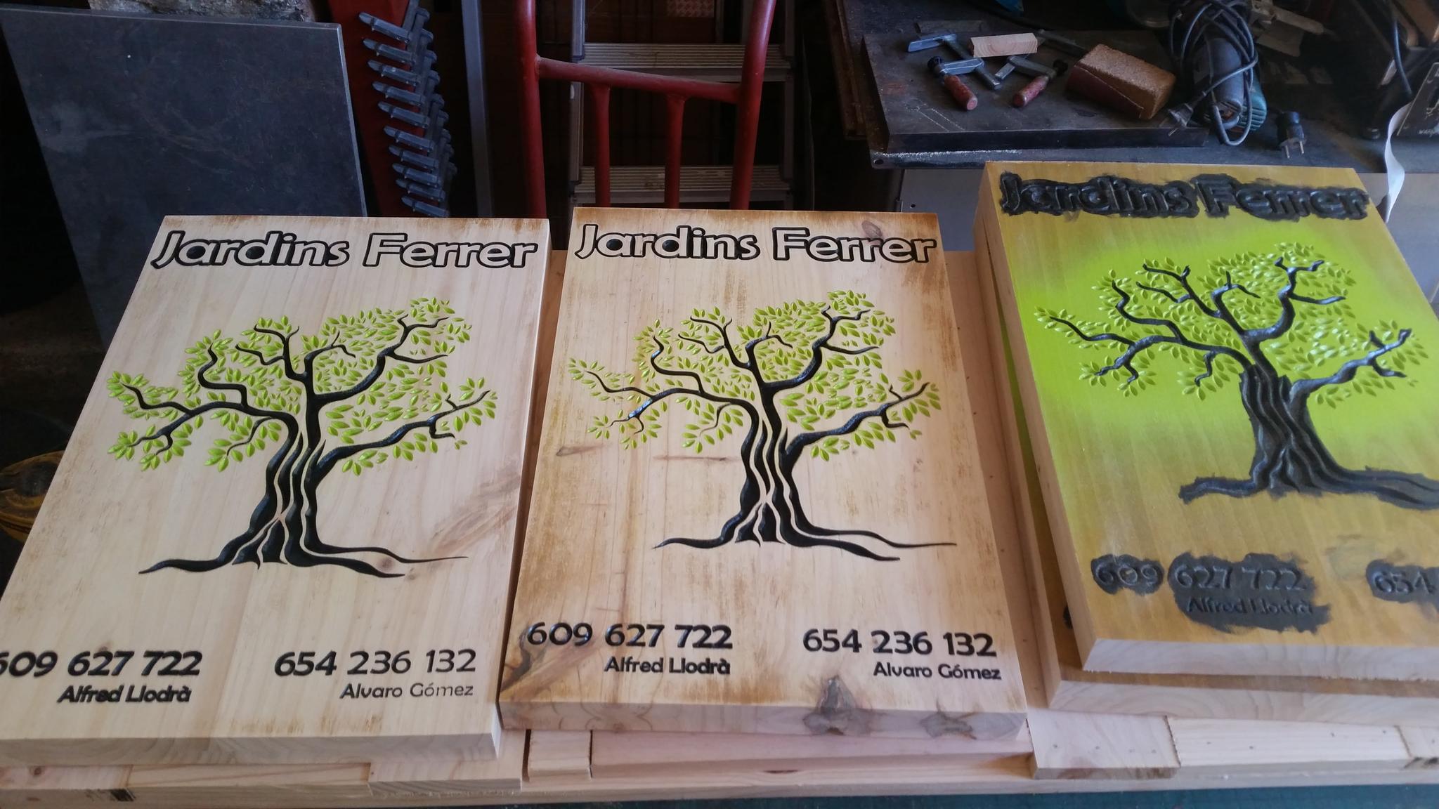

    No, what i am suggesting is more precise. There is no need for tape. Paint will go under the tape and into the wood! hence better is to impregnate wood and then paint channel. Then sand excess. I have that constant conversation with a printer guy friend of mine when he tries to teach me that i have to use tape and me that is better without tape.
    Plus there's that detail that you have to sand inside channel or clean with flat screwdriver before coloring and priming. The tape will not permit that or will roughen and then coor will go where is not needed in wood.
    I have tried all and what i say works 100% perfectly. I don't have more time for experiments... It works also just V cut clean and paint, but then sanding is more time and trickier if you have 1mm grooves like that on picture below. In fact on that images you will see that i used different method for each plate. result was same just i lost 2 1mm lines and had to do them by hand later.
    And use bicomponent paint otherwise you could be testing the destiny. Once only i used bad paint on 30 signs and had to repaint them 4 times.
