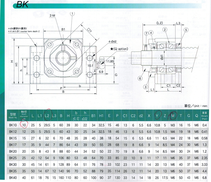

    I have 8mm slots with 40mm between the slots. That's why I had to make the adapter plates for the gantry. With 45mm extrusion the bearings could be bolted straight on.
    The distance between BK12/BF12 fittings is 46mm they do fit but it's less than perfect, my gantry is fit like this. I made adapters for my bottom axis (With the proper 46mm spacing) and you can tell the fit is better.
ID:	23083 look under P
    Personally if I build with extrusion again I will make adapters for all the BK/BF fittings. (A non issues for the Z of course)
