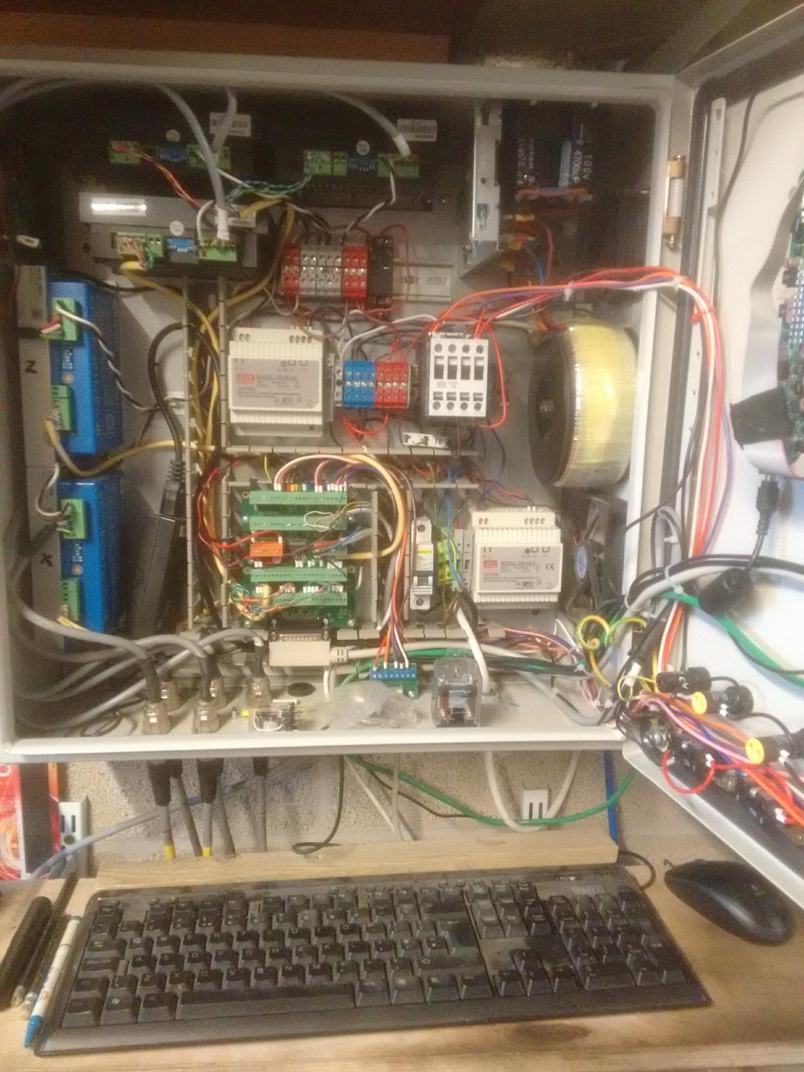

    I would get all your bits together first and then lay them out, you will be surprised at the amount of space you need.
    Pic of one of my control boxes. This one power the lathe and mill with mpg's etc

    Haha !
    Clive it looks like you might have one cable to many in there!! Just kidding :)
    How big are those? 60x60?

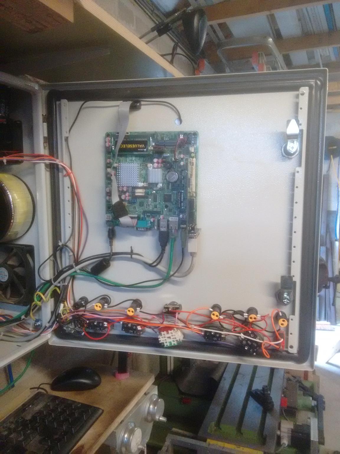

    No 50x50x20. I got carried away it was just for the mill at first then I added another two drives for the lathe etc etc. the pc is on the door with the monitor on the other side.
