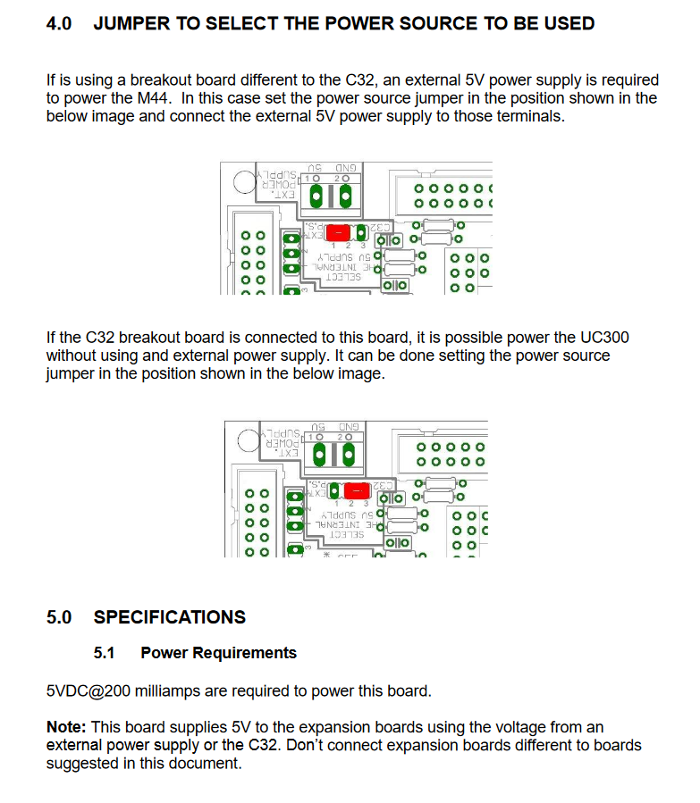

    Maybe the amperes are not enough from the PSU 5v for powering both the UC300 and Bob that is why you solve the problems when you get your 5vokts from two different power supply ...just a thought.
  7. #276
    From the UC300 manual
    I think you might be correct Nick!
    Either that or my thin long wires from the first psu are the culprit.. or interference.. ;)
    The psu is speced at 5v 2A so it should be plenty?
  11. #280
    Thanks :D
    But I got even more trouble when powering the board via usb. Then it disconnected whenever I e-stopped ;)
