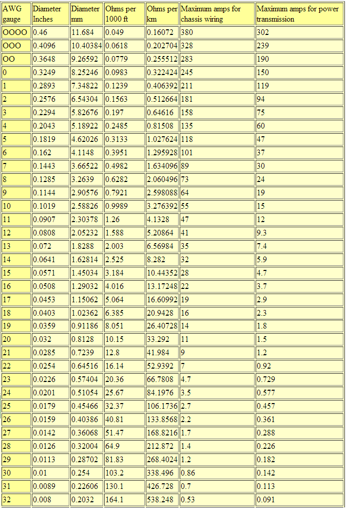

    2amperes is good but how thin are the wires?
  3. #283
    It's 0.5mm2 wires. So they should be more than fine. They just feel thin/flimsy.
    I'm used to 1.5mm2 wires ;)
  4. #284
    You are just fine,according to this :
