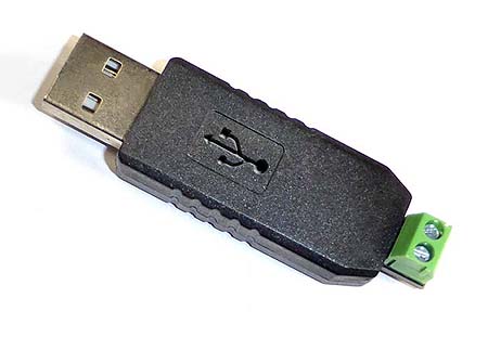

    Yes, you are mistaken. I don't know which VFD you have, but as far as I know, all VFD which allows RS485 control has at least on/off/forward/reverse/speed commands. I control mine via Modbus protocol and even download some monitoring data.
    The USB dongle is fine for Modbus but some models are better than others. I have one like this...
Name:	USB -RS485.jpg

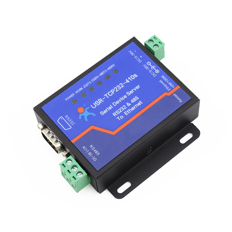

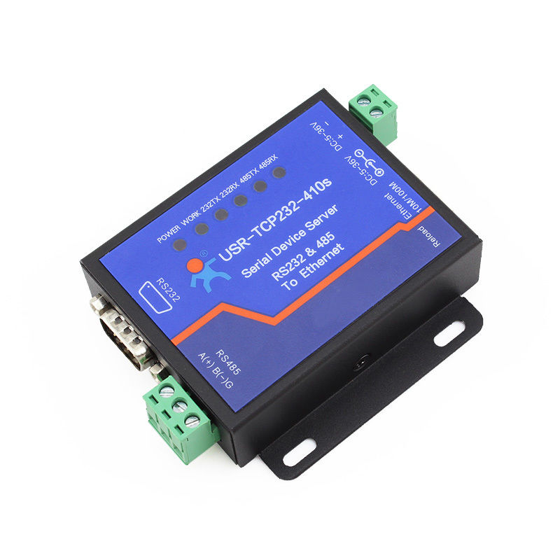

    ...which I don't use because I wanted Ethernet control, so I bought this one:
Name:	ETH-RS485 - 1.jpg
    Both works reliably, and in fact, you can also buy a WIFI version, which I'd probably go for today, if I not already had this wired one.
