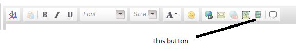

    Small update!
    I think there is smooth action going on..
    https://youtu.be/KQl2zc84KsM
    How do I embed youtube links? :D
    click the insert video link it's next to the insert picture then paste the youtube link.
