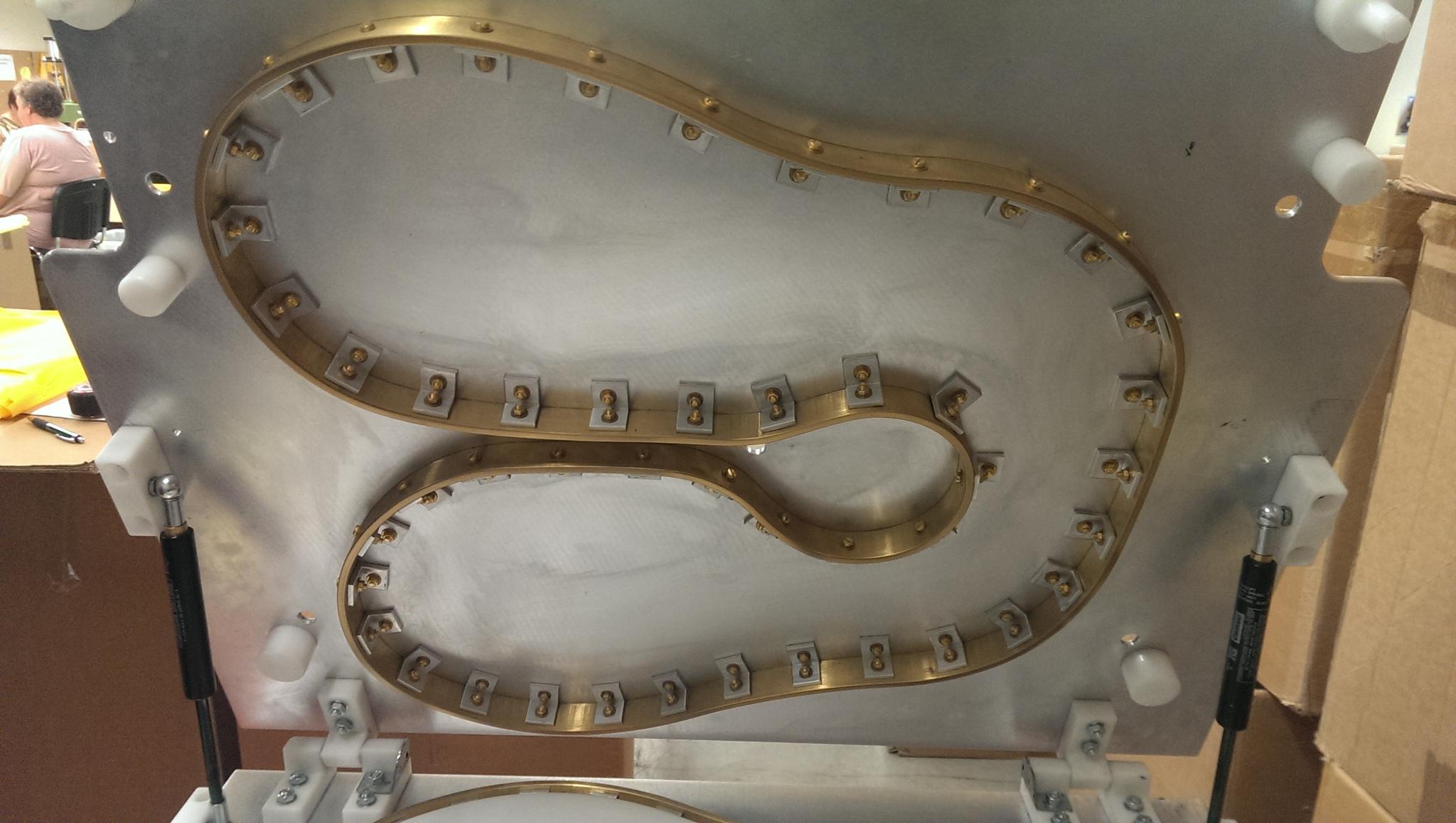

    I have a possible new project - welding fixture for HF-welder.

    Overall the fixture is quite basic except for the brass electrode.
    Electrode profile dimensions 30x6,5mm. Overall fixture size is 900x700mm
    I have not seen this fixture in real life, but common sense would be to bend it from a bar stock. But considering it has to have quite tight tolerances and 2 identical top and bottom contour - this makes it extremely difficult. Though I do not have any experience with brass bending...
    Surely it is not milled out from solid?! :D
    What do you think guys? How it`s made?
    Looks like annealed brass flat bar, you should be able to bend it OK.
    Mike

    Could you mill a shallow slot in the back plate for the brass to sit in ? that way it would maintain accuracy.
    Good idea!
    I was thinking of milling out the template and bend the brass bar around that template. Guess I will have to just test it.
