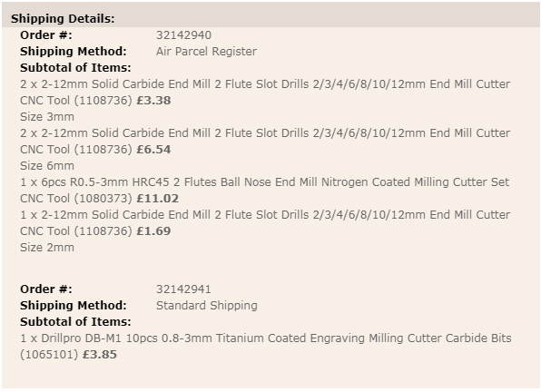

    e2a bought this for a start will order some more shortly.
Name:	End mills.png
    Paid a bit extra for quick shipping on the 2 flute cutters but the engraving bits will come in normal post.

    I bought 2 flute slot drills for now
    2*3mm, 2*6mm, 1*2mm (Was cheap), also a 6pc ball mill set 0.5mm to 3mm and a 10pc engraving set.
