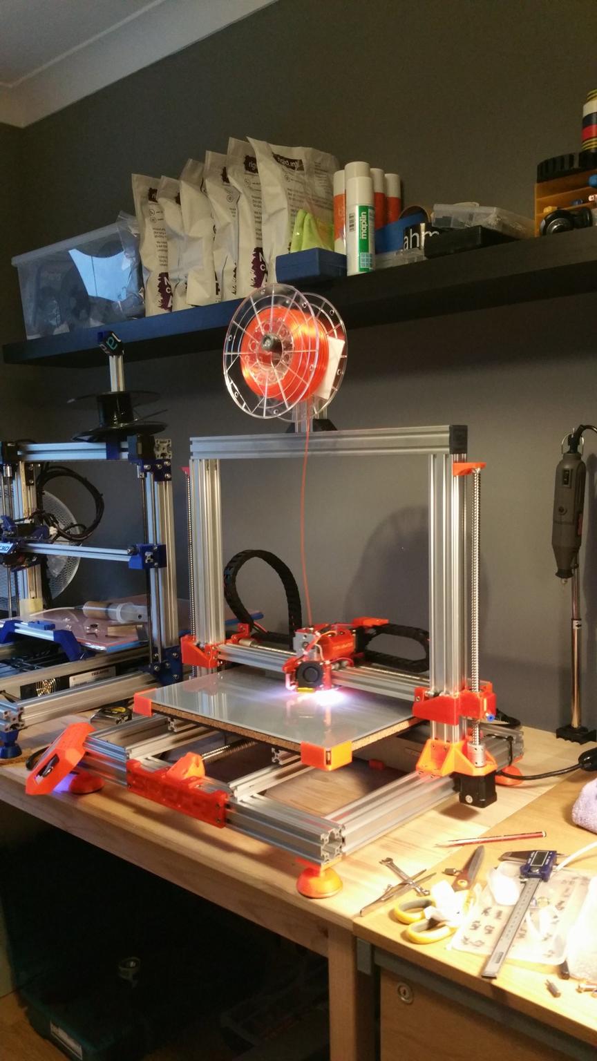

    I'm sorry but you could not be further from the truth, 1/256 microstepping is widely used in the 3D Printing sector, mostly for improved quality and almost silent operation (Mainly with Delta Printers), you think people want to listen to their printer go for 40 hours when its in the next room, making a noise when you're trying to sleep? The needs for a 3D Printer are totally separate from a Router regardless of how similar they actually are.
    Well my printer uses a SFU1616 ballscrew on both the X & Y and a SFU1204 on the Z Axis, the X Axis is driven by a 1/32 microstepped Nema17, DRV8825 driver.
    A belt is fine for most applications, but if you printing engineering plastics where the Bed Temperature needs to be 120c+ you will soon see they stretch and deform from the heat, screws are also far more robust.
    Alex
