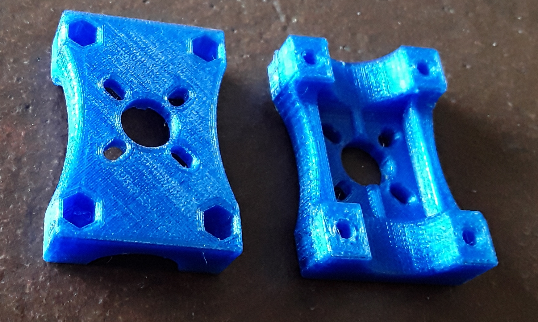

    I agree, I'm experimenting with a roll of PETG (coincidentally from real filaments!)
    I have found it pretty easy to print with, although it can sometimes have small stringy artifacts, but these are easy to scrape off.
    It is definately tougher than PLA, but i couldn't quantify by how much.
    I think it will be my "go to" filament when strength is a factor, otherwise PLA . I haven't tried ABS yet as I've heard it's smelly and I'm enough trouble as it is!!
    Pic of 16mm tube motor mount for my upcoming X8 copter printed in PETG
