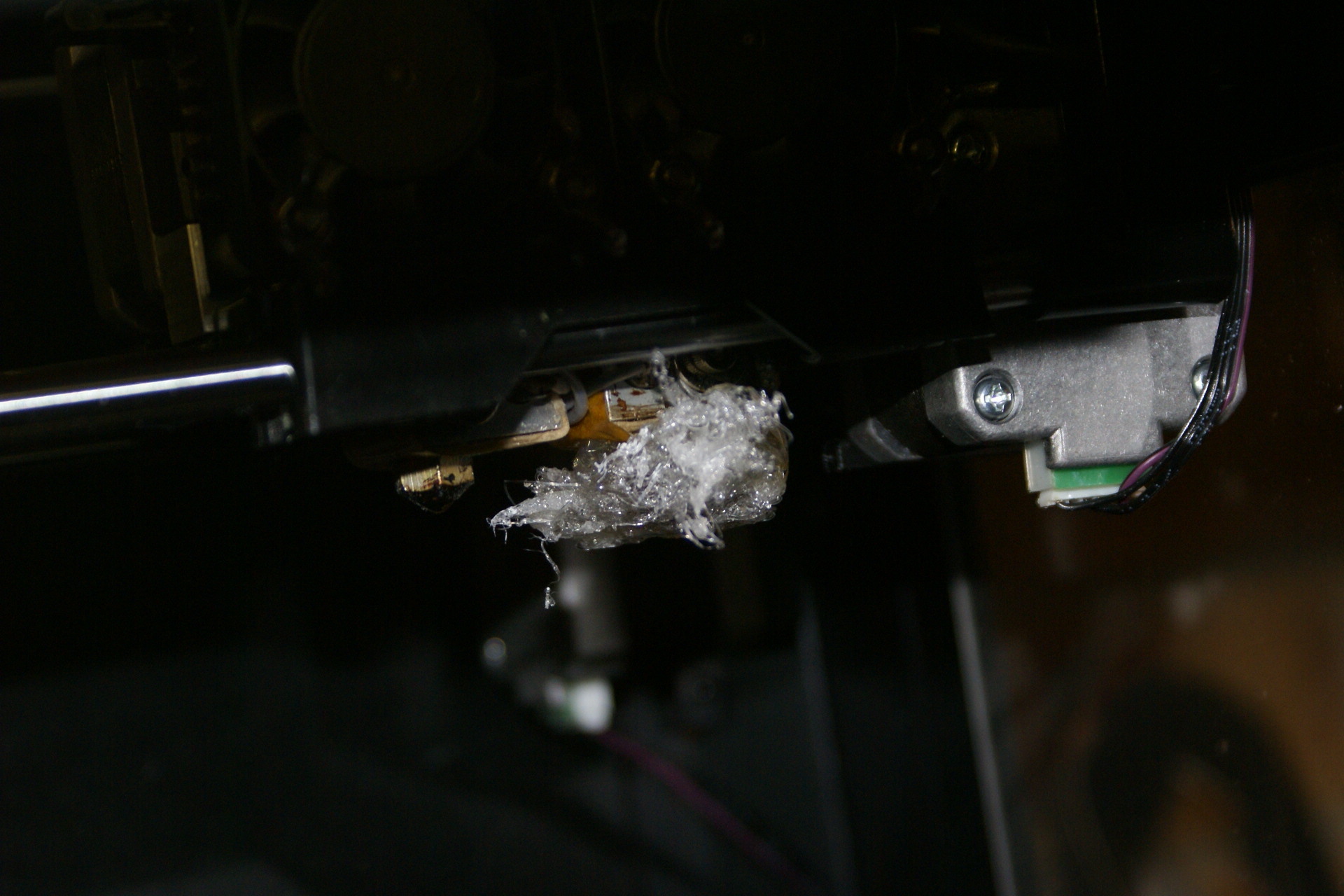

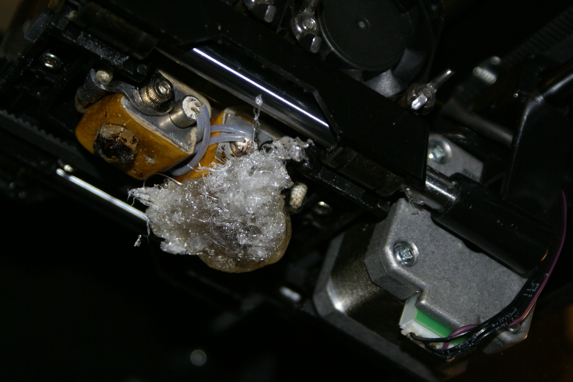

    I printed a couple of dozen shaped washers for a customer/friend and the last two I left to print overnight and went to bed. In the morning I found the print had come unstuck and the ABS just kept extruding, but due to the unstuck component hanging round the extruder, a great mass of ABS had accumulated

    So I am just preheating the nozzle and will leave it for half an hour to see if it gets liquid enough to come away without damaging the heat blanket.

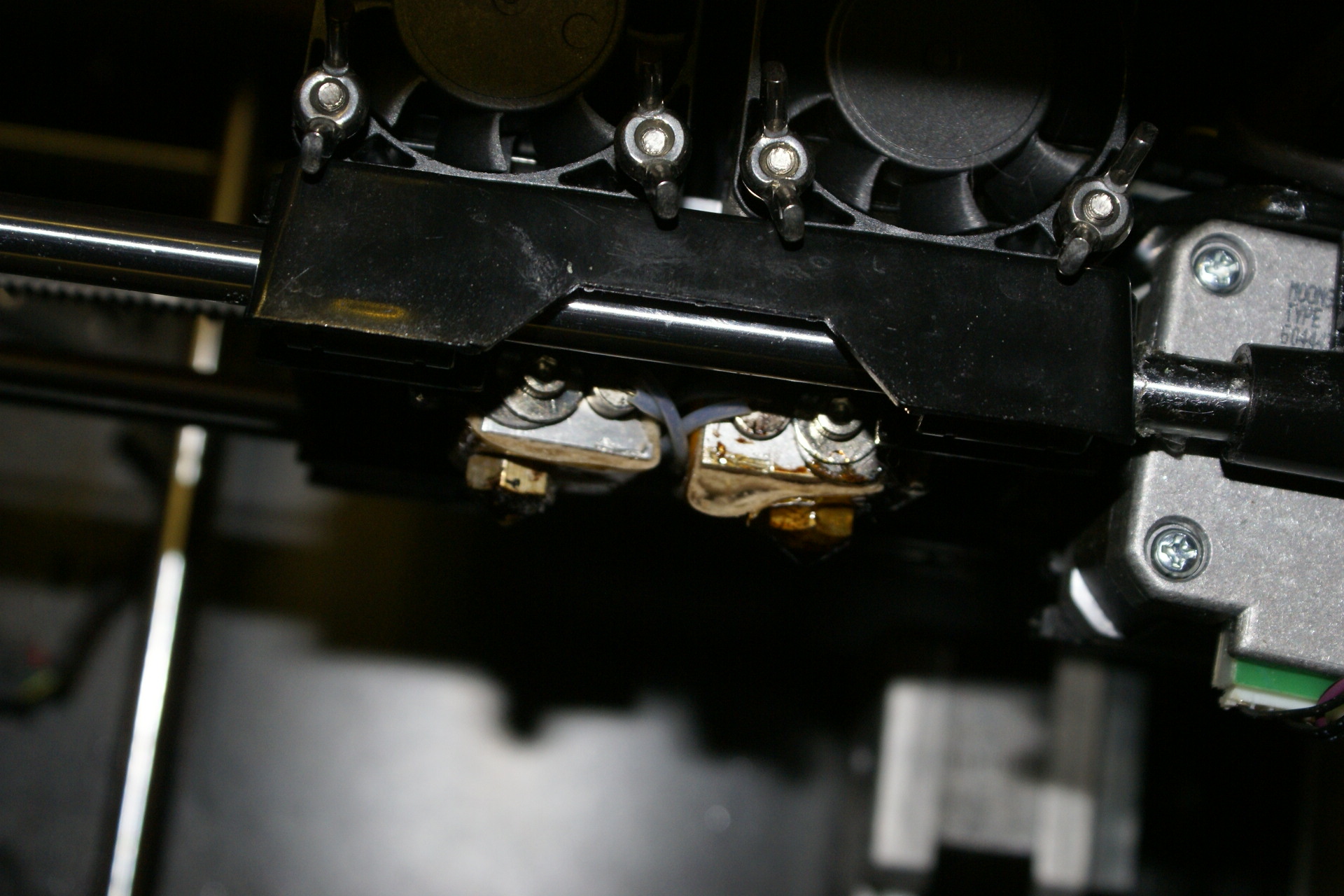

    I made a couple of mods to the printer. The first one was to fit stainless steel extruder gears, but this proved wrong. The stainless does not have the self cleaning property that the original brass has, so any minor filament jam just grinds a notch in the filament and the dross just stays on the gear and requires disassembly to get to it to clean.
    I have also replaced the 40mm M3 bolts that hold the extruder motors, extruder, heat sink and fan on to the bar with the nozzles. I used 50mm M3 studs and wing nuts, so that I can remove the heat sink to get to the extruder gear without having to take the extruder motor off the frame (cos it is a bugger to get it back).

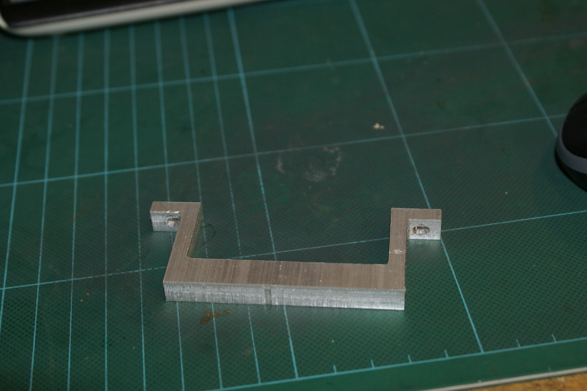

    The other thing I did was make a jig for setting the height of the nozzles with the nozzle bar out of the printer. It saves a hell of a lot of hassle later on in assembly, when you can't easily get to the nozzle height clamping grub screws.

    I think I may have gotten away without having to replace the heat blanket
