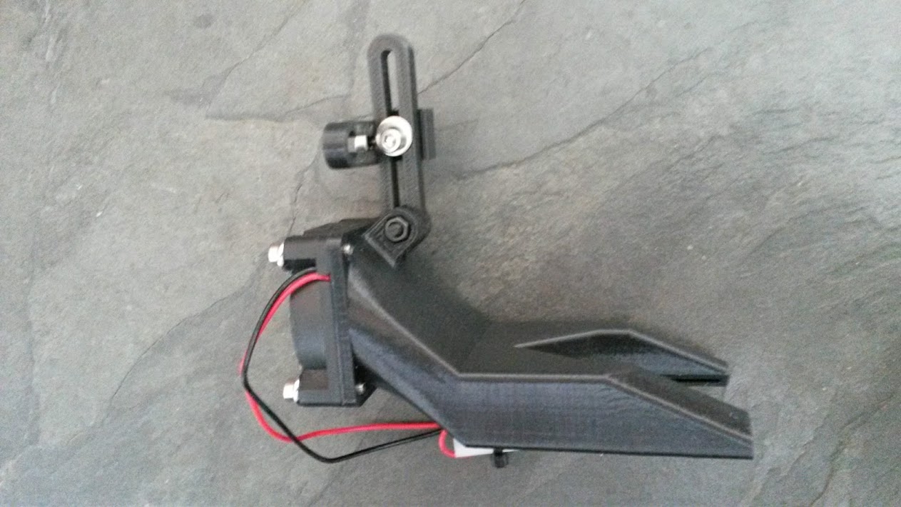

    I've been printing some Nylon parts with my Factory 3D Prusa i3 clone kit ;-)
    This is my PLA part cooling duct with a 40mm fan.

    How long did it take to print it? Which temperatures did you have on the table and the extruder?
