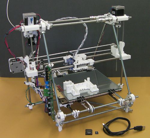

    I think it must be perspective because it's 8mm smooth rod, standard prusa build size.
    I have the same printer it's not particularly big I had a mendel and just bought the ply frame and swapped the parts over.
    Was a massive upgrade from the original mendel lol.
    This was the mendel
    One of the early FDM 3d printers for the home
