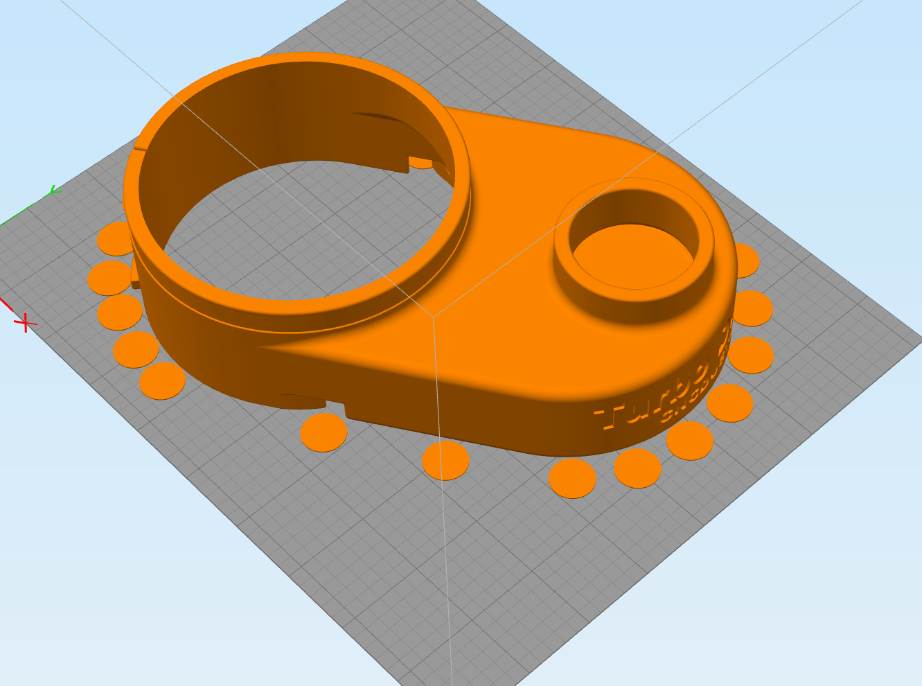

    What materials do you normally print with? I've had trouble with larger parts and ABS lifting up at the corners, anything that's over 6cm tall has caused me problems in the end I have to encase the printer to get it to print larger parts (I do this with a cardboard box lol) but when my router works going to build this enclosure to add to my printer because it looks nice lol.
    https://youtu.be/wt7bQXyLSL4
    Never had an issue with PLA found it very easy to print if you have a fan blowing over the part correctly obviously I don't use the fan with ABS because it shrinks one of it's design features (So it drops out the injection molds easier).
    I print ABS in an enclosure, rafts and supports always. Plus some extra coins that help against lifting. PLA same. Nowadays i use mainly PETG for functional parts/ up to 70C/ .
    Whatever they tell you each one of the materials lifts, shrinks and so on. I print the dust shoe from my signature and there is not even one material that it will print ok due to the specific shape, if i did not knew how to counter effect that. All else is marketing.
    See example below of the coins, how i situate them, or all hacks up...
    3d printing makes a lot of sense after the CNC and once you understand what is happening and solve the common beginner problems, its easy to become an expert when you are using your brain and figuring stuff. But on Facegroup groups and so i was tired of repeating the steps to understand all, nobody cared. So i dont visit them now.
