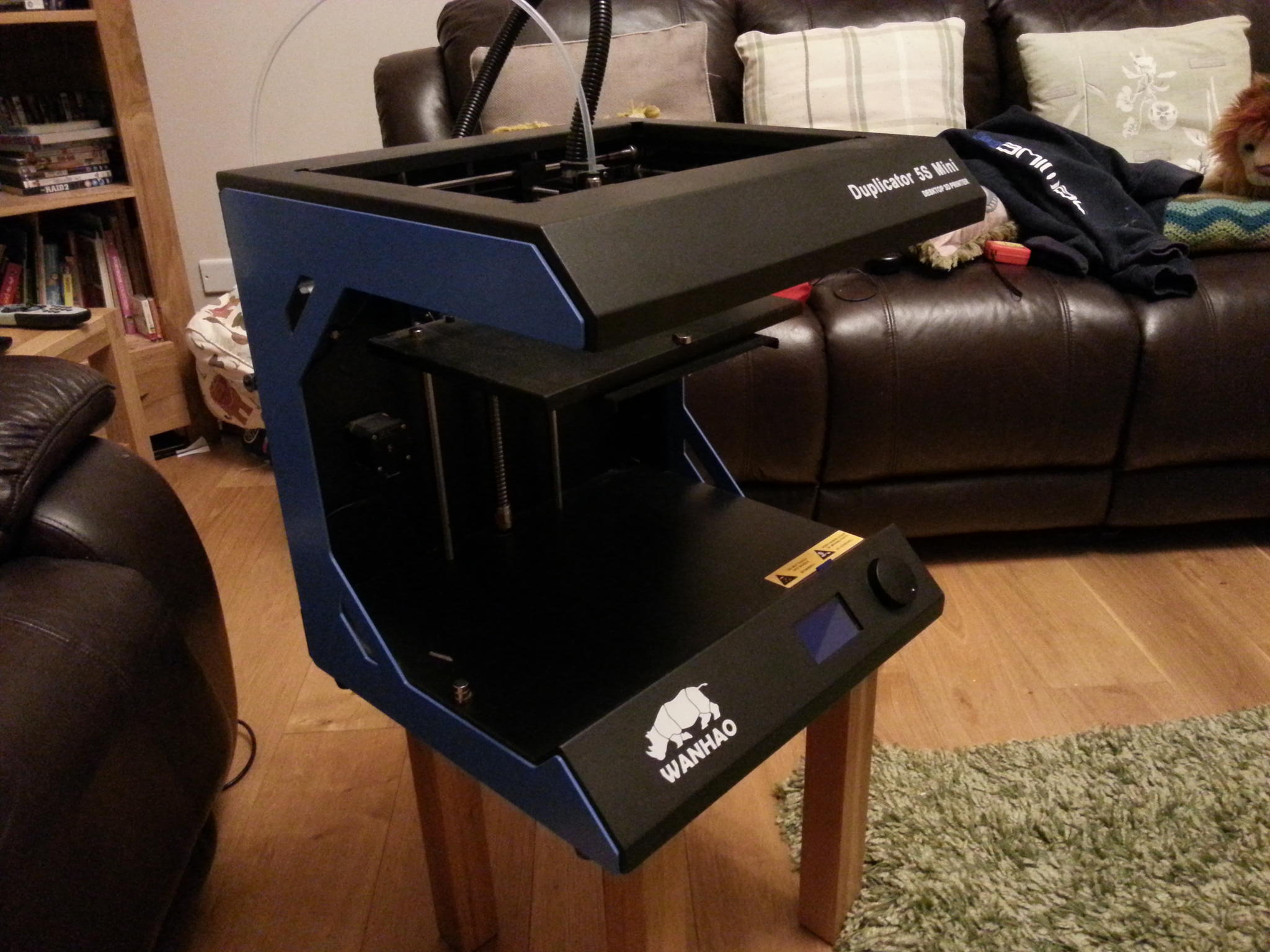

    Thanks for all the good input. I was all set to build one and then a Wanhao D5 mini came along at the right price so Im now the proud owner of this little beast.Click image for larger version.
    also has the heated glass bed and some PLA+ to play with. Should be up and running soon.
    Thanks Again.

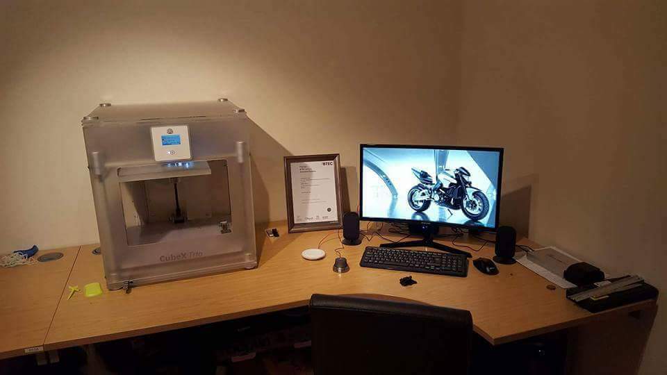

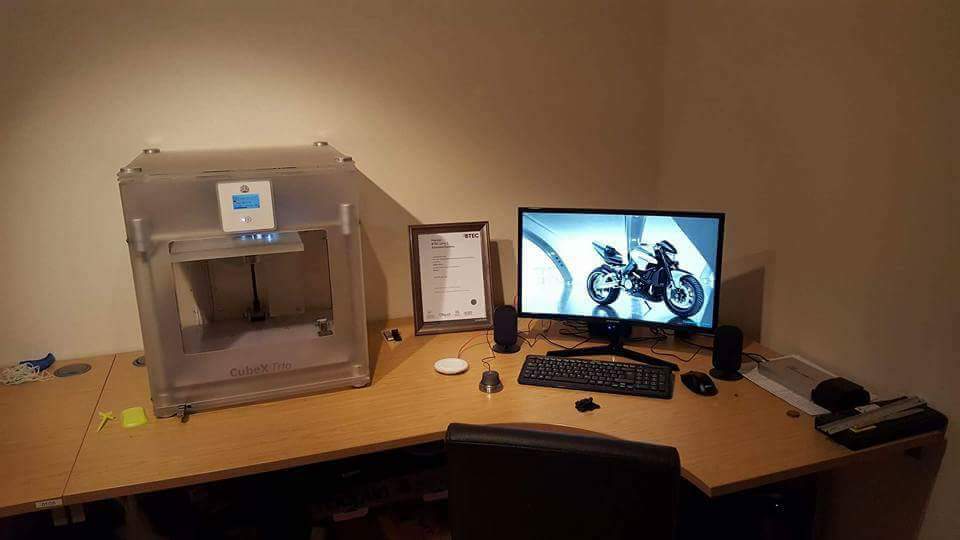

    Hi I have a Cubex trio 3d printer, triple extruder ideal if you want to use dissolvable filament for support material when printing complex parts. Very easy to use comes with some material & and tools to get you started. Good condition. £400

    Cool. Have you printed anything? Are you happy with it? What's your impressions so far?

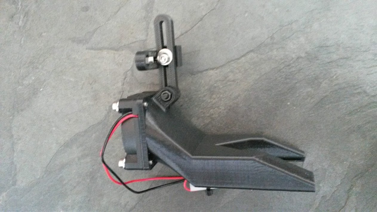

    I've been printing some Nylon parts with my Factory 3D Prusa i3 clone kit ;-)
    This is my PLA part cooling duct with a 40mm fan.

    Yes lots of failures but I guess its a learning curve. I had bed leveling issues and poor prints with layer shift, since found out that the 2 or the 3 screws holding the main x-y carriage where missing and the 3rd was loose.
    tightening them has solved the layer shift but Im still getting 1mm variation on the bed calibration. guys on the forum think it is the micro switch but it seems to work fine when I tested it with a meter.
    I think it will be a good machine but needs a few tweeks and lots of wear, the previous owners must have used it a lot.
    biggest issues that i missed when researching are the bowden extruder and being stuck with the wanhao maker slicer program. (firm ware upgrades to 3d partry but not brave enough to try)

    How long did it take to print it? Which temperatures did you have on the table and the extruder?
