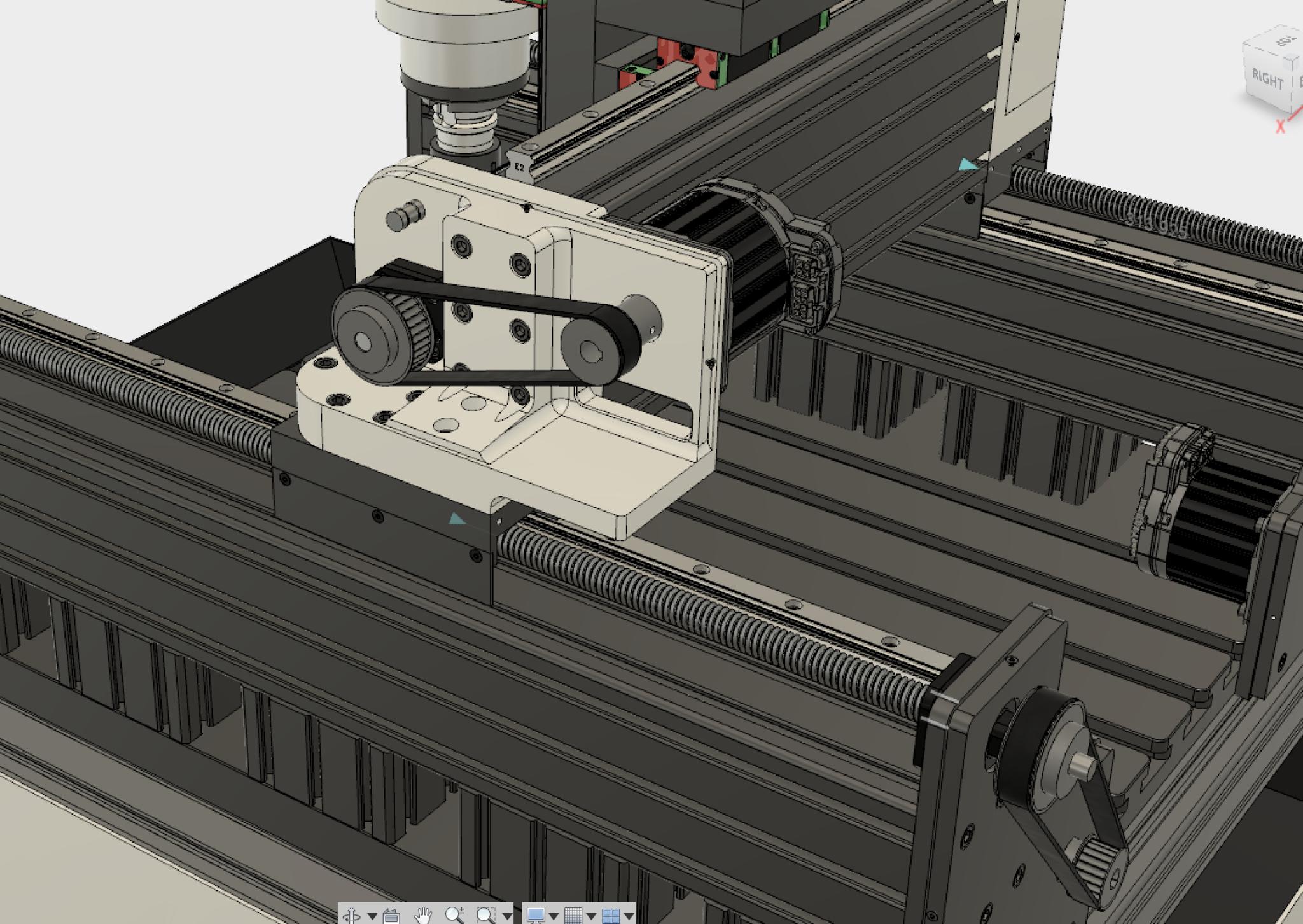

    the gantry ends (and all other parts) are machined from solid 7075 T651 but those are covers as well.
    i'm including some images without the covers for clarification
Name:	Screen Shot 2017-07-28 at 12.21.39.png
ID:	22399Click image for larger version.
Name:	Screen Shot 2017-07-28 at 12.27.06.jpg
ID:	22401Click image for larger version.
Name:	Screen Shot 2017-07-28 at 12.25.37.png

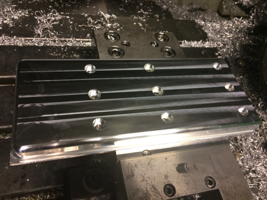

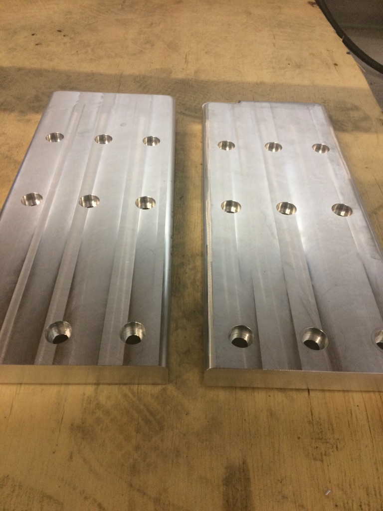

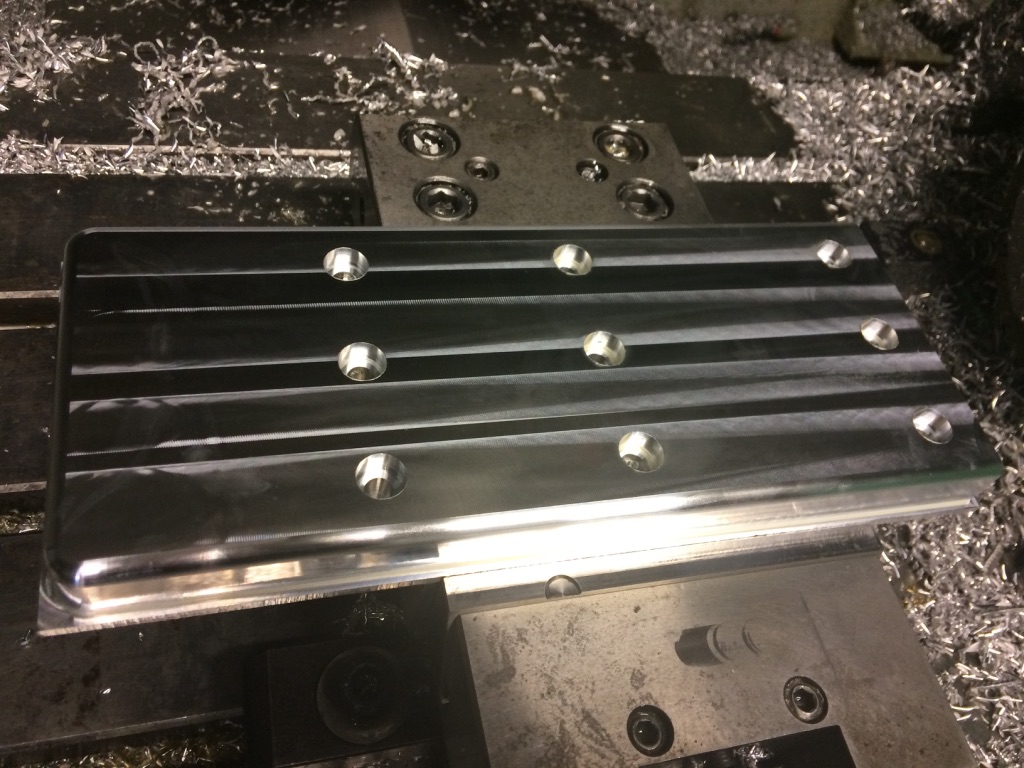

    also, the work has begun on the machined parts(!!)
ID:	22403Click image for larger version.

    Hi giladv,
    Very interested in your project as I am thinking of building something of similar compact size in the near future and your design looks great.
    I also use Kflop with my CNC mill and I love it.
    One question, the 1.8 spindle servo, can you tell us what servo you are planning to use? Is is a dedicated spindle servo for higher revs or just the usual 3000 revs?
    Edward
  4. #14
    Quote Originally Posted by Edward View Post
    Hi giladv,
    Edward
    thanks!
    regarding the spindle: the ac servo should be 3500 rpm max (with the driver itself i was able to go only to 3000rpm).
    but there is a 1:1.87 gear ratio between he spindle and the motor. so i'm planning on around 6000-6500 rpm at the spindle tip.
    best,
    Gilad

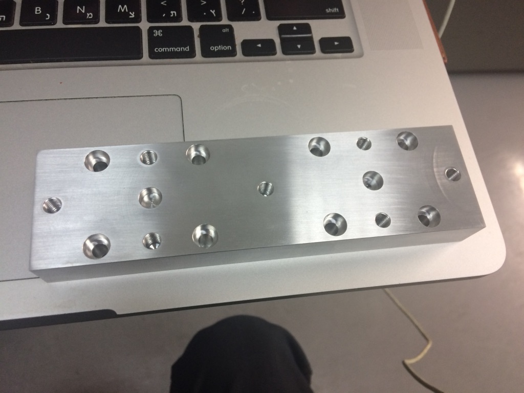

    hello everyone, just a small update:
ID:	22462Click image for larger version.
