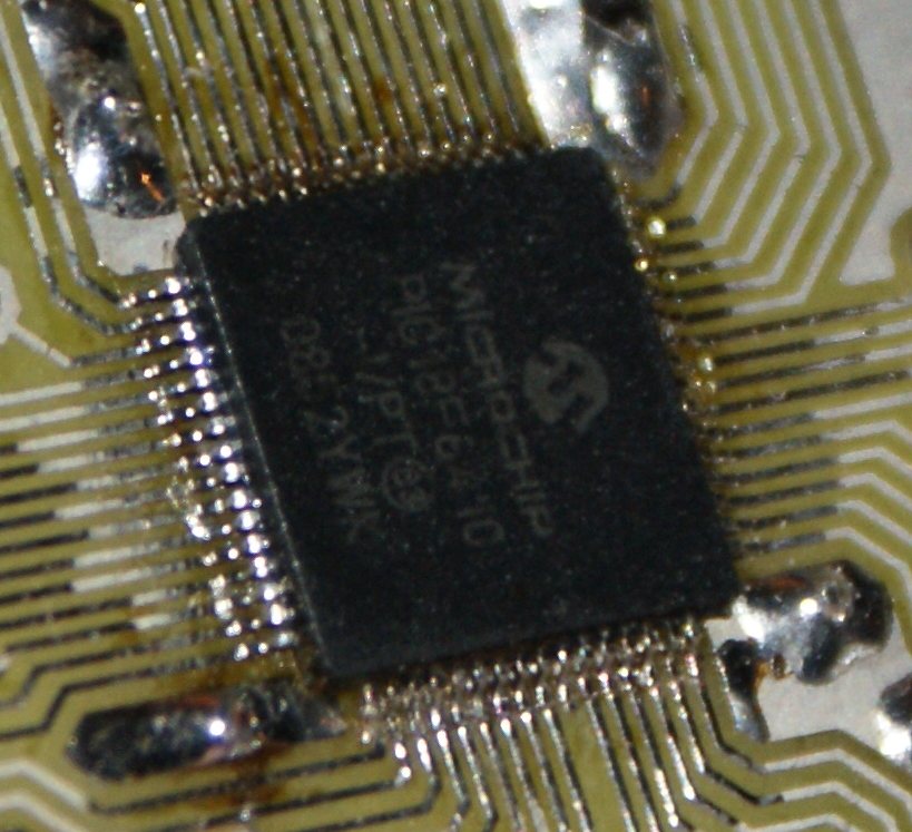

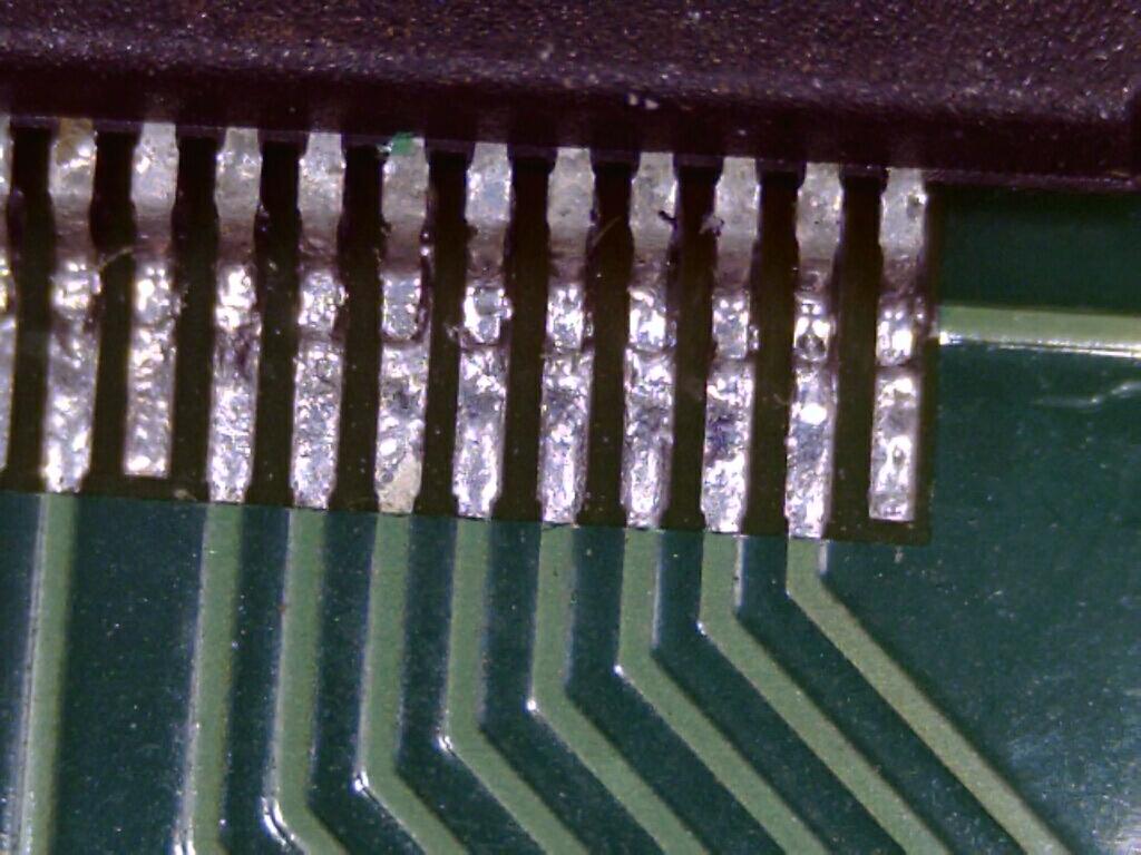

    I do .025" but it ain't pretty :whistling:
    Prettier than my 0.02" without solder resist (cheat!) though
    Note that the two pins that look like they're shorted aren't - it just flux that didn't come off the third cleaning I did with it.
