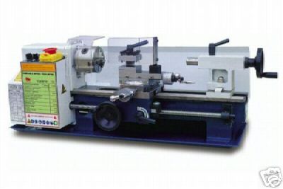

  2. is it the same as this? that i got from ebay.
    360140178055
    If so i can take some pictures of the wiring for you?
    It looks remarkably similar!
    The one I have is an Axminster C2 ....
    http://www.axminster.co.uk/product.a...file=1&jump=44
    All info is welcome - so if it's not too much hassle, photos would be great.
    Once I know which are the AC mains in connections (there's a veritable plethora of switching going on!) ...and the DC out, then I'm off to a good start, but at the minute I can't trust a thing - wouldn't want to connect AC mains across the outputs!

    block 1 has six connections
    below each connector has some ID written on the PCB as follows
    Connectors 1 & 2 ....."Gang" (possibly a ground connecton?)
    Connector 3 ....."L1"
    Connector 4 ..... "L2"
    Connector 5 ......"A+"
    Connector 6 ......"A-" (thesetwo look suspiscously like theycould be the DC outs to the motor)

    These machines share common wiring between machines.
    L1 and L2 are mains
    A+ A- are the motor connections
    P1, p2, p3 are the pot
    K1, K2 Usually wire to the start switch as an inhibit so that if it trips you have to switch start off then on again to reset.
    The one I can't help with for definite is P5 and P8.
    on the X3 these have a jumper fitted.

    Thanks...that's actually a great start (& I had an inkling that was the case), what threw me is the reference to L1 & L2 on this wiring diagram in the manual (which you'll see has a different number of connections on it to my board anyway!)...L1 & L2 look to be both attributed to the DC Motoros & AC mains!
    Any idea what the top two connectors at the other end of the board (in my photos) might be for? (I'm guessing possibly a chuck guard switch?)
    K3, K4 are estop guard switches.

    Having had fever all week (stuff swine flu - this was much more serious - man flu), it's fortunately waned sufficiently this evening to take a closer look at my dead board.
    I think I've found the fault ...about 25% of the components on the PCB's lower surface appear to have been nuked ....
    (surprisingly...there was no inkling of those scorch marks until the board was removed from the recess)
    Not looking like such a good buy now! (but to fair the seller did say it would need a new board - but oh no, did I pay much attention - nah, I'm way too cocksure thinking I could likely fix it! ).
    I don't suppose anyone has a less knackered motor speed control board that I can buy/fix? ...this one's beyond the pale!
    Out the frying pan & into the fire ...there's nobody holds stock of the pucka replacement (not that I[d pay eighty quid anyway), so John S pointed me to a suitable Danfoss control board.
