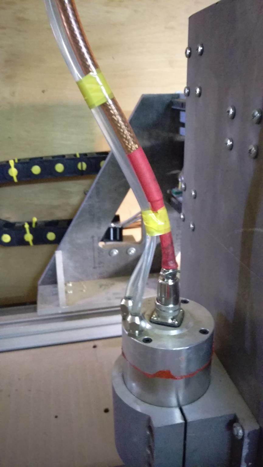

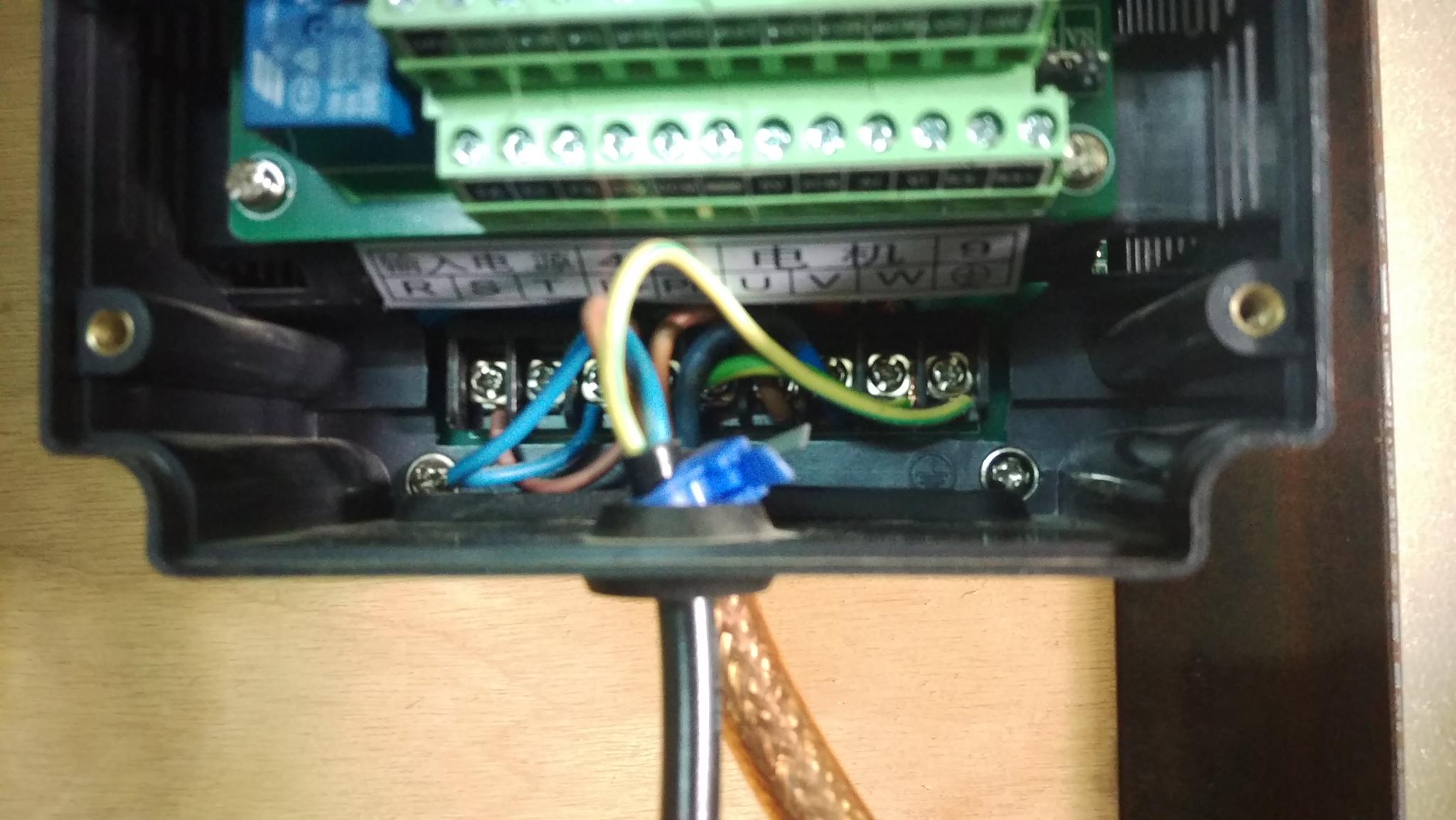

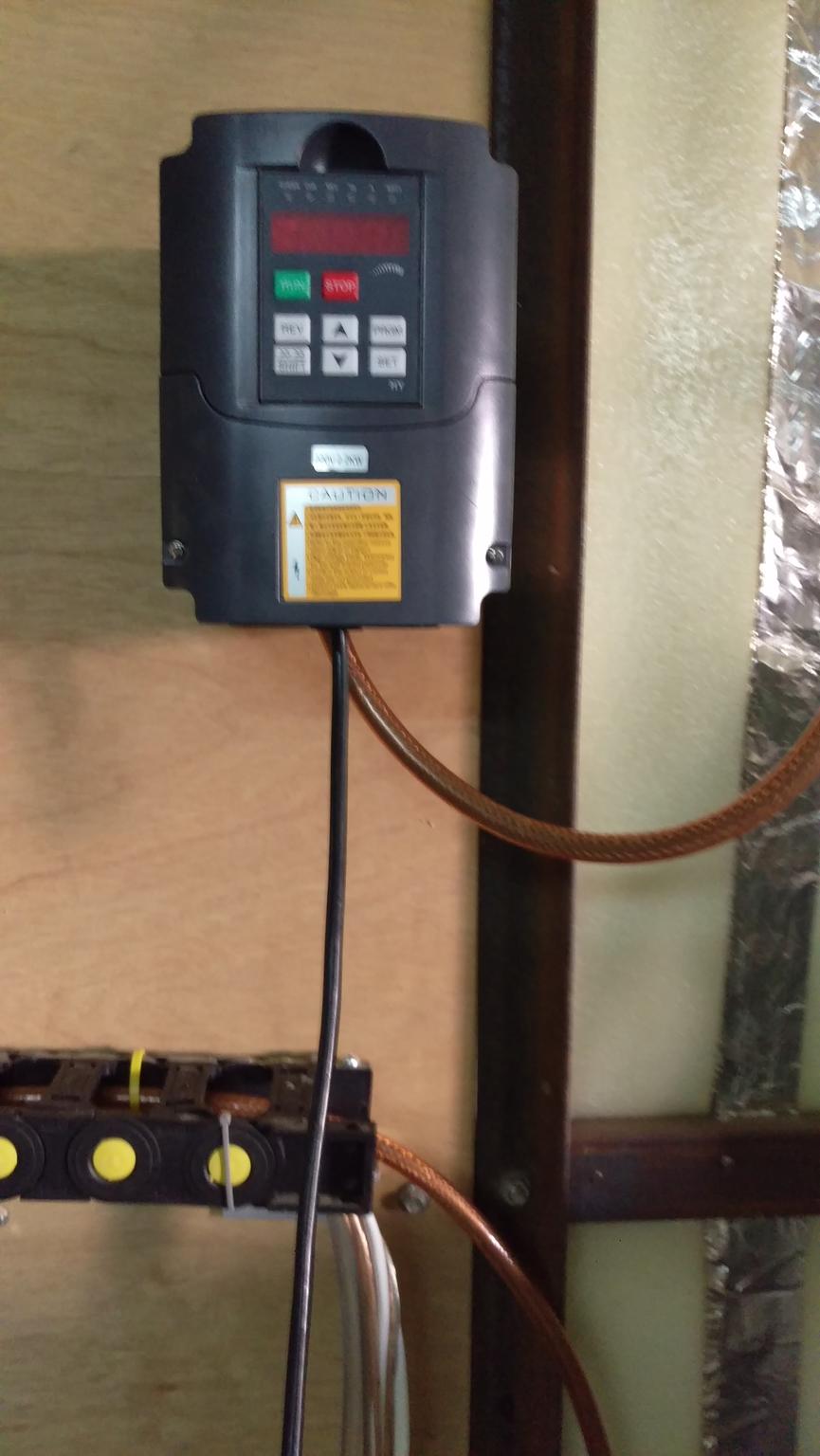

    Hi guys,
    My suspicions were correct, the culprit is EMI coming from the spindle, but now that I have replaced all of the cables...... I need some electronically minded advice.
    The spindle is leaking current to the entire machine when it is powered somehow.
    Inside the 2.2KW inverter, I have the house power connected to R /T on the left for active / neutral, and Ground on the far right.
    Then I have the spindle power on U/V/W in the middle.
    The shielding on the spindle cable is not connected to anything at the Inverter end, but it overlaps onto the metal plug at the Spindle end - could this be the cause?
    The other possible issue is that this spindle does not have an earth - aside from it's power return cable.... If I did run an earth wire attached to the spindle or aluminium Z axis block, can I just plug that into the house power earth inside the inverter box, or could that cause some kind of fault/loop?
    The question is, is the charge coming from the shielding getting charged, and because it's touching the outside of the metal plug, it's then charging the machine, or the lack of a spindle frame Earth is now somehow causing the issue

    Ok First make sure the machine frame is earthed to the star point in the control box, make sure the screen on the spindle cable is earthed at one end only (solder a wire to the screen and ground it to the spindle body)
    Are all your other cable screens grounded to the star point (In the control box you should have only one point where everything is grounded to)

    Ok.... I disconnected the Spindle power cable braided sleeve so it is now fully insulated at both ends, and so is not physically touching the metal spindle plug either.
    With the spindle turned on at 18,000 rpm, I have a 40 Volt ac signal generated, between the Spindle/Machine, and the spindle power cords' Braided Sleeve, at 9,000 hz. The machine ran without issue.
    So - should I run an earth from the braided sleeve to house . power inverter earth at one end.... I don't see how this would dissipate electricity though as it's an AC signal effectively being generated by EMI.
    2. I will probably run another earth wire back from the spindle to the House earth now - to stop electric shocks in the case of other failures.....
    If I have the AC leaking braided sleeve earthed with the inverter / house earth, and also conect an earth from the spindle to the inverter / house earth, I could be back at square 1 as the spindle could get some of the AC?

    Try downloading some manuals for good quality VFDs to see how they recommend grounding.
    Typically the screen would be connected to the earth point at the VFD. Then the VFD earth connected to the star point.
    Whether the screen gets connected to the motor varies. I'd be inclined to try it with and see how things run, as having the spindle well grounded is recommended from a safety point.
    Ideally you want to avoid ground loops, however sometime they're unavoidable. Having them in the screen of a power cable isn't likely to cause problems. The problems occur when you get a ground loop in signal wire screen, as that's when you start introducing noise into control circuits.
