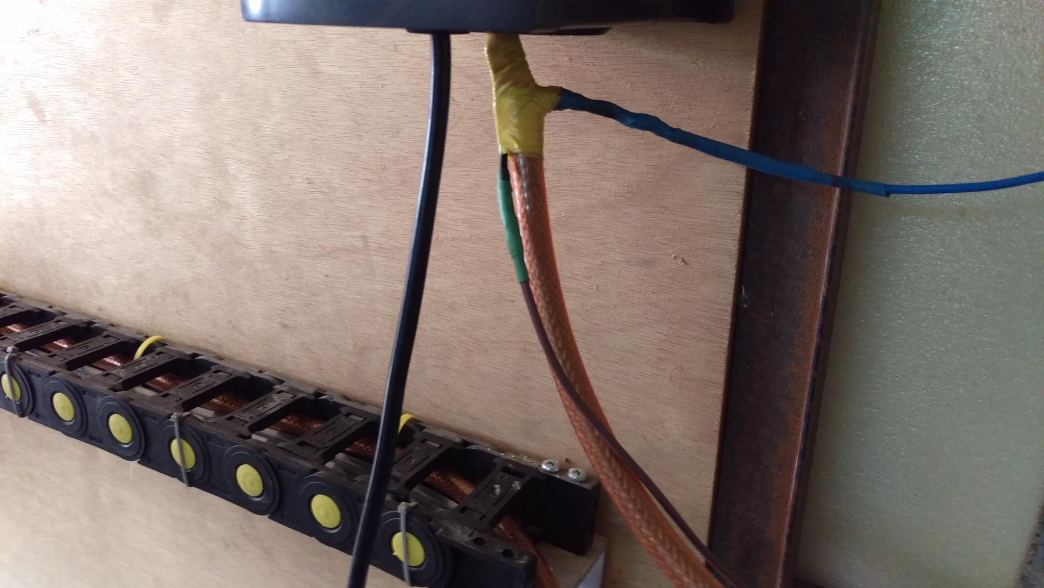

    This is so frustrating, so I had another 4-5 skips / jams on the x and z axis doing this parallel job, so I reduced the speed, and the acceleration by 50% , still jamm, turned off the spindle, no jam. Put the spindle power plug and spindle / vfd cable earth on separate circuit ( not going through control box ) still jam.
    Then I disconnected the spindle earth ( which runs inside the vfd cable so is probably a massive noise carrier, from the spindle and IE from the machine, and so far no jams.Click image for larger version.

    This ground cable was effectively attaching the vfd noise onto the machine. Since the stepper motors are on the machine, they are then subject to the effectively AC pulse made by the VFD earth, and by the vfd cable shielding.

    Did you try running the machine with the VFD cable screen connected at both ends (and check that with it connected, there is continuity between the spindle body and the VFD earth point)?
    Hi MC,
    I measured the voltage that the shielding on the VFD cable produced when the Spindle was turned on, it's was straight to a 40 Volts AC signal, between the shielding, and the CnC frame. When I connected that shielding to the frame, the steppers went ape shi*T. Motors were stuttering and I could " hear" the motors struggling to just run normally. Now, the machine wasn't grounded at this stage, but that was the effect of attaching the noise directly onto the frame of the machine.
    I then unattached that end of the shield, and tried to attached what i thought would be a suitable ground ( it was an unused wire from inside the VFD shielded cable ) Big mistake - now this wire WAS on the Earth ground at one end, running through the VFD cable, and attached to the Z axis / stepper motor mount at the other end. I think all I did, was make a big long antenna inside the VFD cable, which even though it was grounded, was helping to turn the machine into another noise generating machine.
    Then I got desperate after about 5 jams in 10 minutes, so I undid the " VFD " ground wire from the spindle / Z block and this made a big difference, but now the machine is not grounded any more.
    So I am going to run another two grounds, one from the machine frame to house ground ( which is the same as the start point, but from a different socket) , and another shielded cable up the cable tracks and onto the spindle/ z block, which will then go to the other house ground.
    I keep reading about these star grounds, but the fact is the VFD cable is creating an AC type noise signal, and If I run that into my electronics enclosure base plate, what is stopping it going straight back up my Stepper controller shielding which is connected to the same base plate? hence I'm connecting these two at a different socket of house earth, in the hope it weakens before reaching the base plate again.
    I don't think Im going to connect the VFD cable screen back up to the frame, it just seemed to make the situation far worse.
