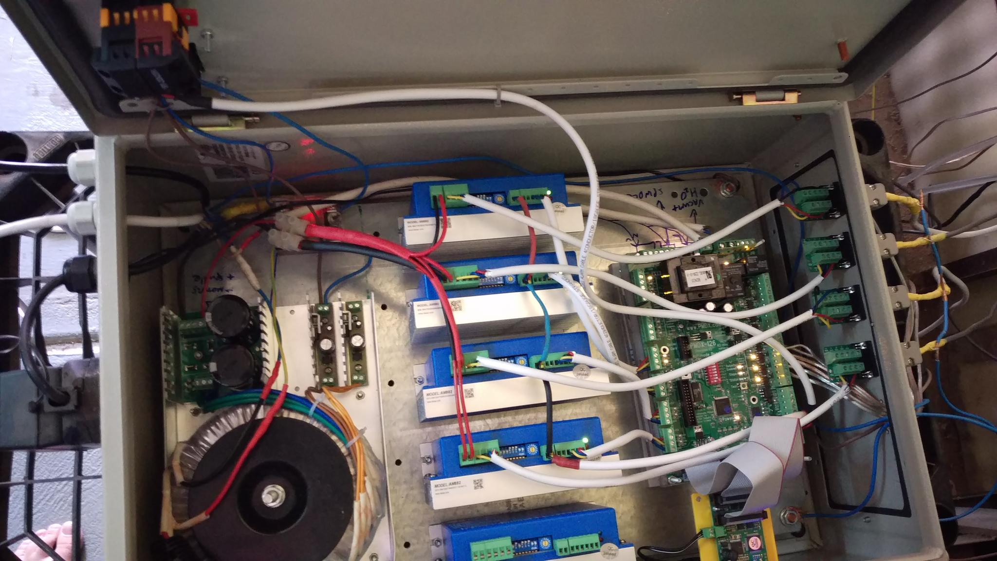

    Ok First from what you have said are you sure that you have a good earth into your shop (is it actually connected)?
    Where are the pictures?
    It is beneficial to wire steppers with 4 core screened cable with the control box end of the screen connected to the star point.
    Personally I would keep the vfd mains wiring on its own socket.
    If you have grounded the screen on the spindle cable at the vfd end. then don't connect the screen at the other end.
    Have you grounded the machine frame? to the star point. (the purpose of the star point is to avoid ground loops)
    I take it that the electricity supplier give you an earth connection and that you are not using an earth rod in the ground.
    Hi clive....
    So this is what I'm at now.
    I checked all the stepper motor shielded cables, made sure they were insulated at the stepper motor end and touching nothing, then at the control box end they all go to the star point.
    The VFD spindle/Z axis block is now earthed direct to the star point. ( No other frame earth, just the one on the Z block )
    The VFD cable shield is earthed separately onto the same star block, and it's insulated at spindle end ( not touching the spindle )
    The other AC appliances ( VFD + Wood chip motor + 2 x pumps ) are all earthed at the same star point where applicable.
    On the earth side - I'm using the house common earth..... how can I test if this is faulty?
    I was a little concerned about the cable shielding pushing an AC signal back into the stepper motor shielding, but it seems to be going ok, 40 minutes into a cut now

    Hi Phill, it's illusion, the neutral 240 Volt connection for this VFD is active / neutral on far left, and ground far right, then 3x spindle wires in the middle ( there is no spindle ground from manufacturer)
  5. #35
    Personally I would just earth the main frame not the Z block ( if you want to earth the Z block connect that to the main frame)
    Let us know how you get on.
    Still no pics of the control box !!

    The stepper ground is temporary as I was still trying to troubleshoot
  8. #38
    Quote Originally Posted by dachopper View Post
    Ok It is always better to use twisted pairs for the step and dir wire from the drives to the control board just chop a cat5 cable up.

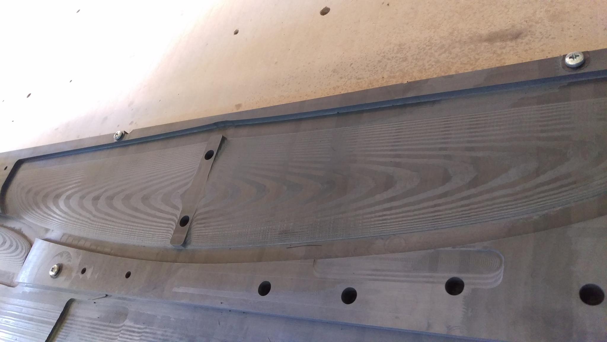

    10mm x axis skip. I've now moved the vfd braid shield onto a separate ground than the stepper shielding.
    If it happens again, I'll move the spindle motor shield onto th
  10. #40
    Guess what.... all skips happening on parallel moves..... ! Strange
