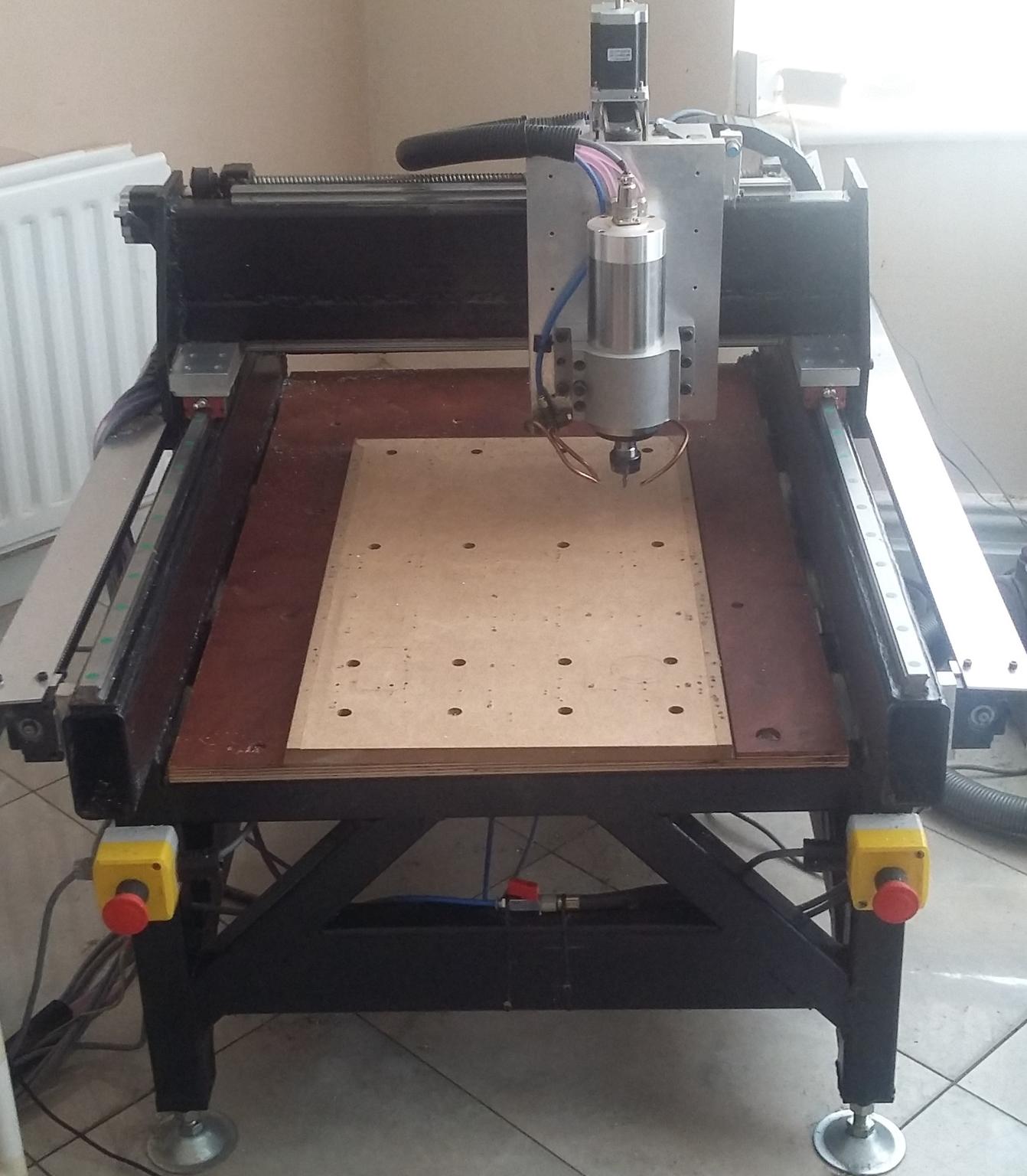

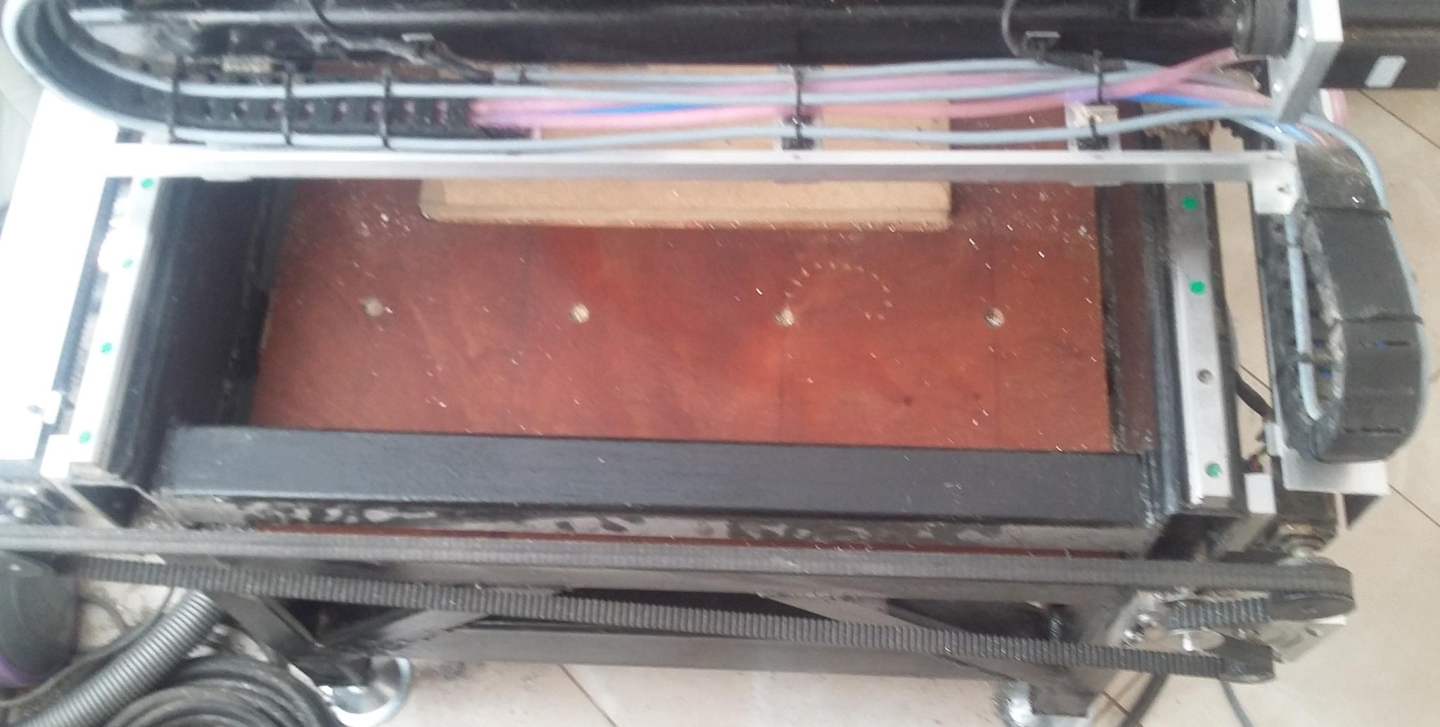

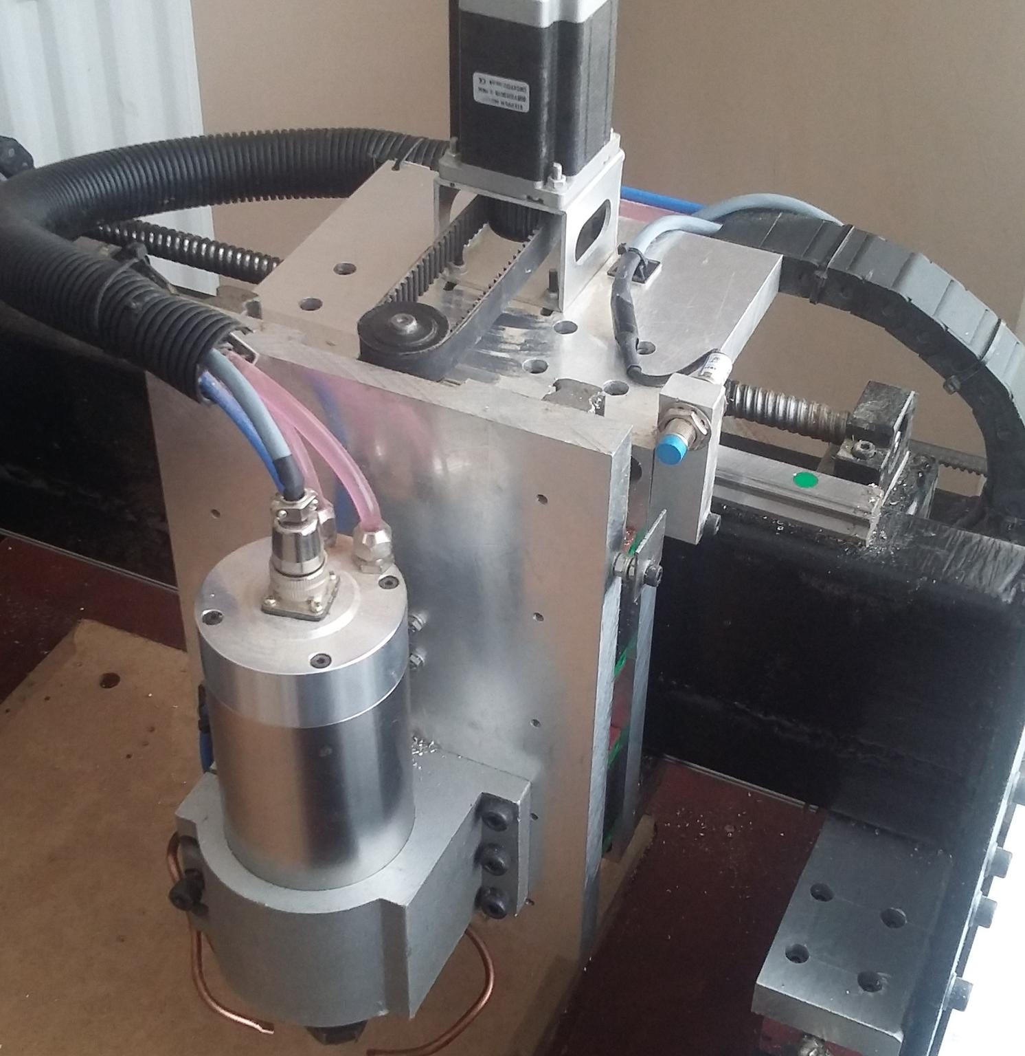

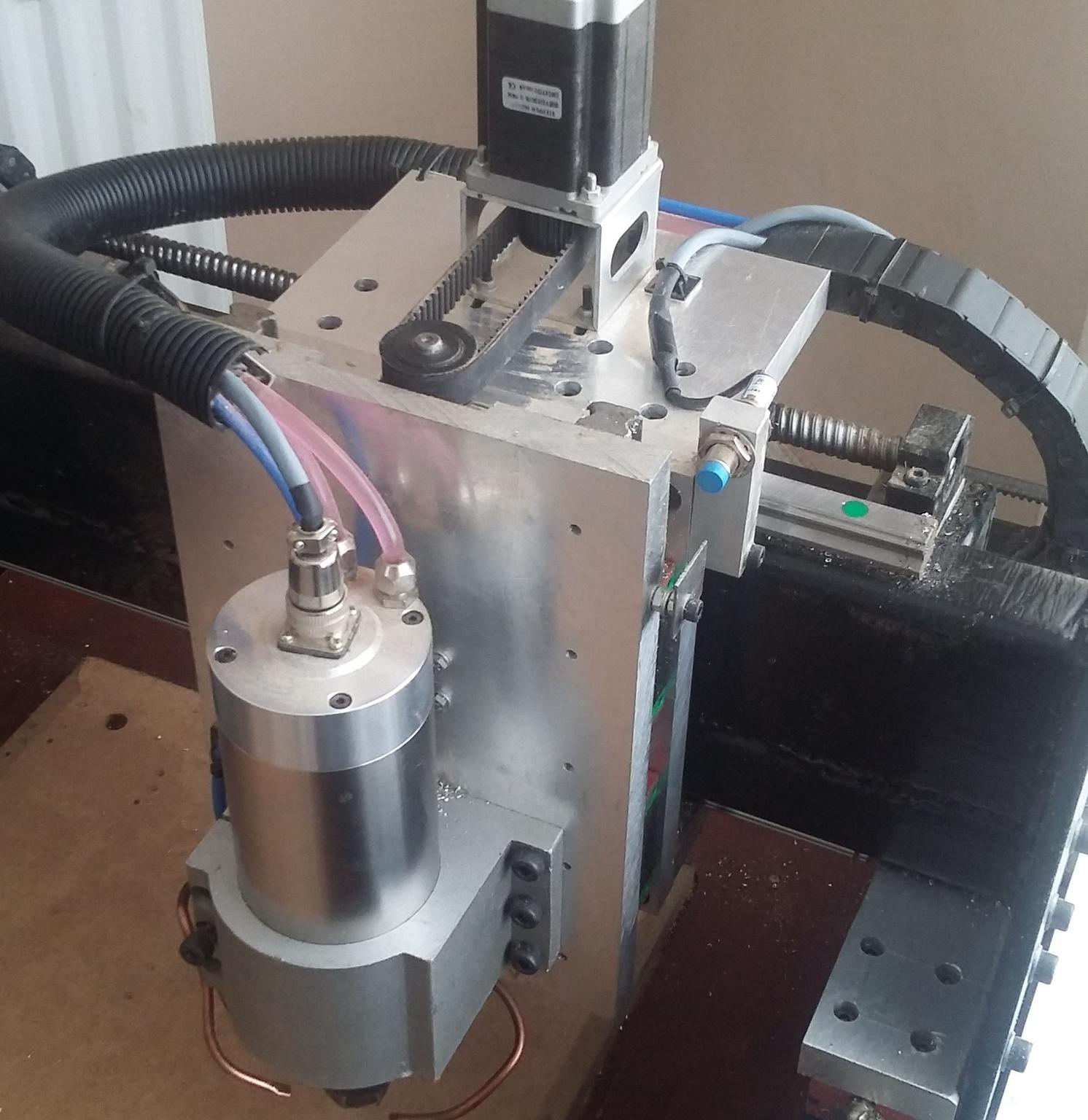

    Details
    General Info:
    Hours of use: Mach3 shows a total operating time of 205 hours
    Materials cut: Aluminium, brass, various woods, foams, plastics and more.
    Cutting area: ~700 x 400mm with Z axis of around 90mm. Also an additional 100mm overhang for taller objects at the front.
    Machine construction:
    Components:

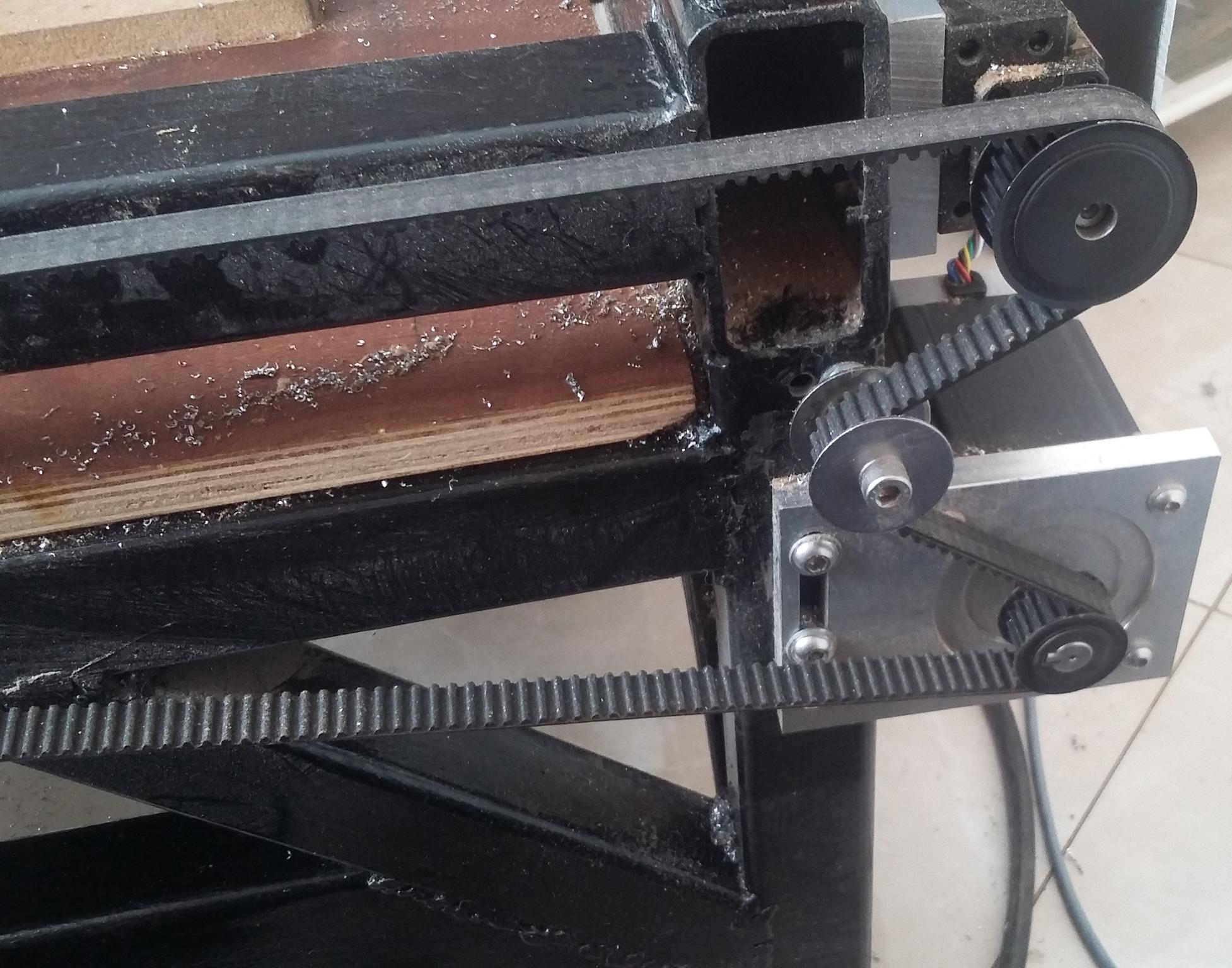

    - HIWIN 20mm rails on all axis
    - 1610 dual ball screws on X axis, 1605 single ball screws on Y/Z
    - All ball screws belt driven

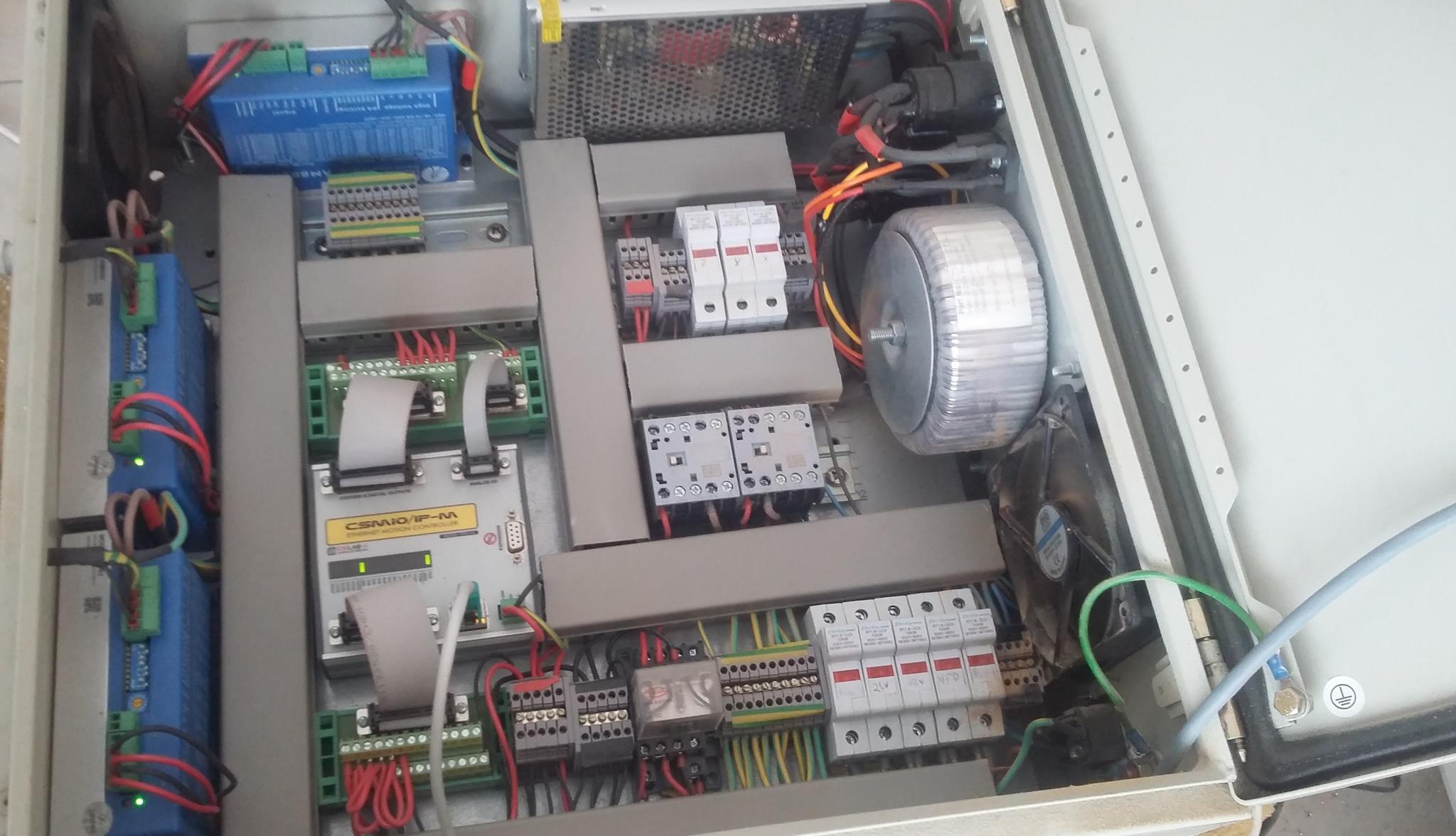

    Electrics:
    - 2.2kW Water cooled spindle + Huanyang VFD
    - AM882 digital drives on all axis
    - CSMIO/IP-M motion controller
    - 8.7Nm NEMA 34 on X axis and 3.1Nm NEMA 23's on Y/Z
    Additional:
    - Mach3 license and setup files to suit this machine (laptop not included)
    - Manual valve controlled air blast setup for metal machining (compressor not included)
    - Water cooling setup for spindle

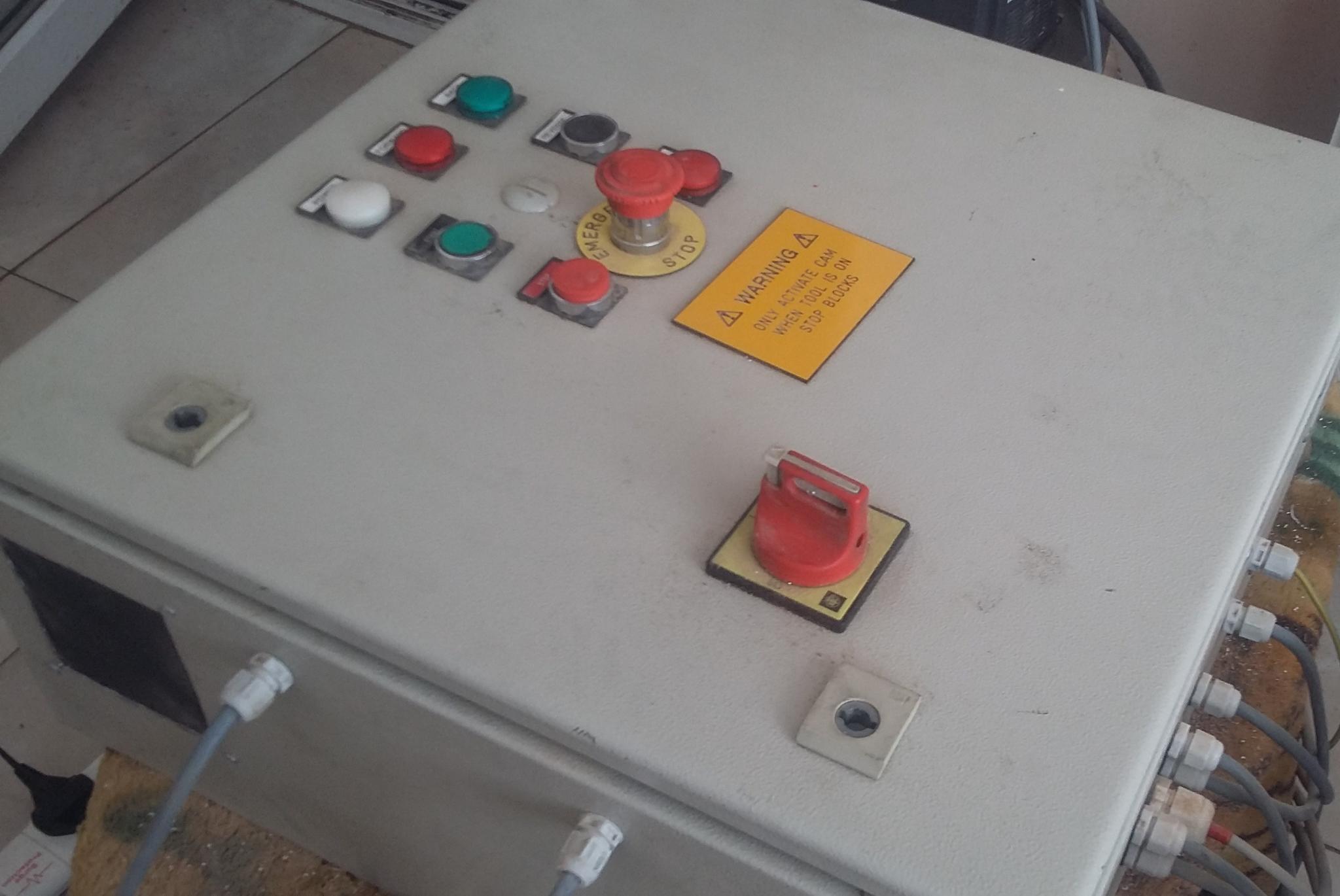

    It's ready to go as a 'plug and play' machine, just requires single phase mains supply and a laptop/PC with an Ethernet port and you're good to go. Here's some pics of the machine:

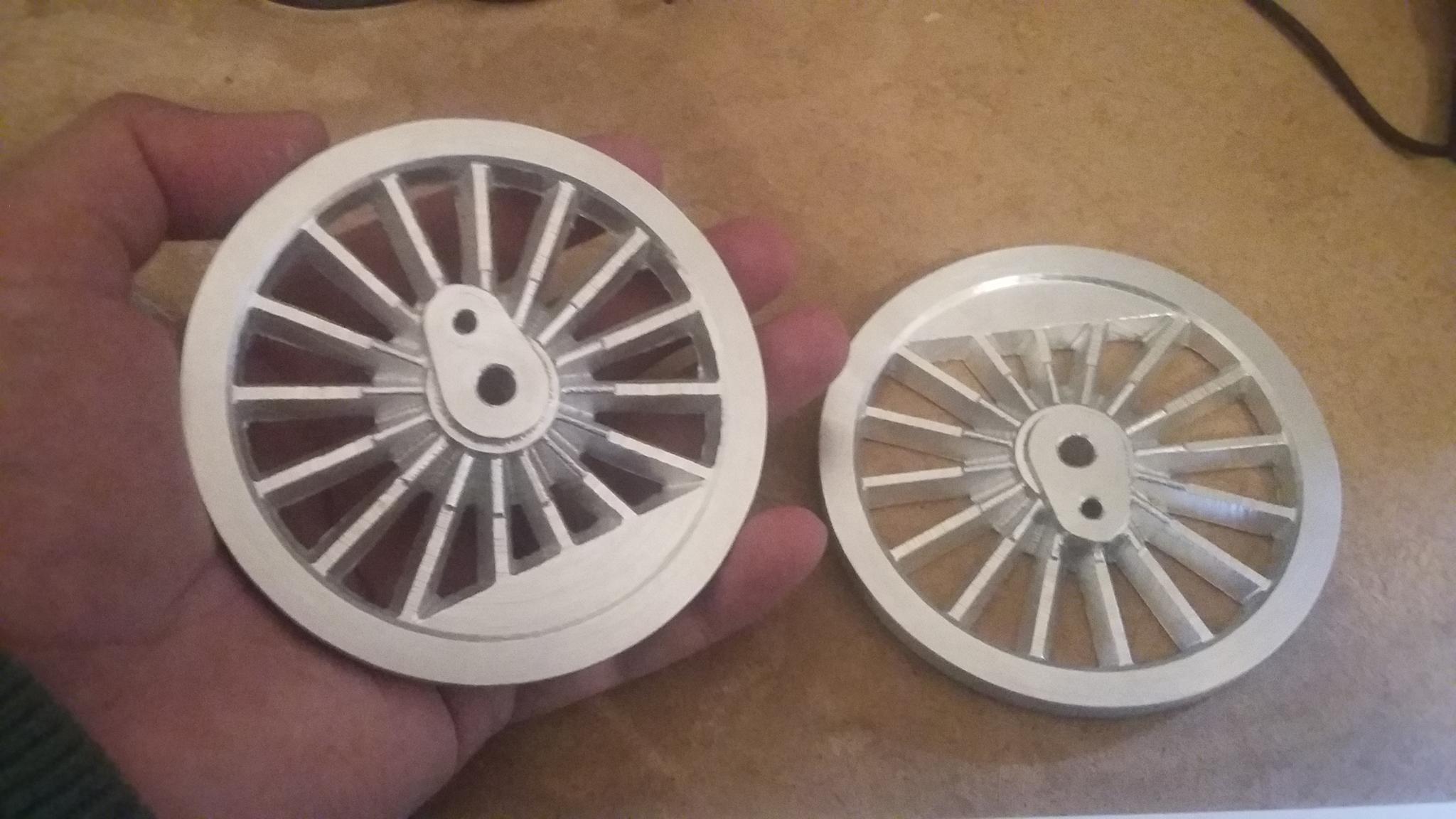

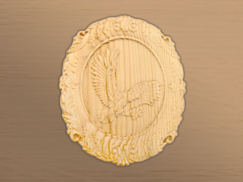

    And here's some machined examples of some test cut's and 'one off's' which I have photos of:
