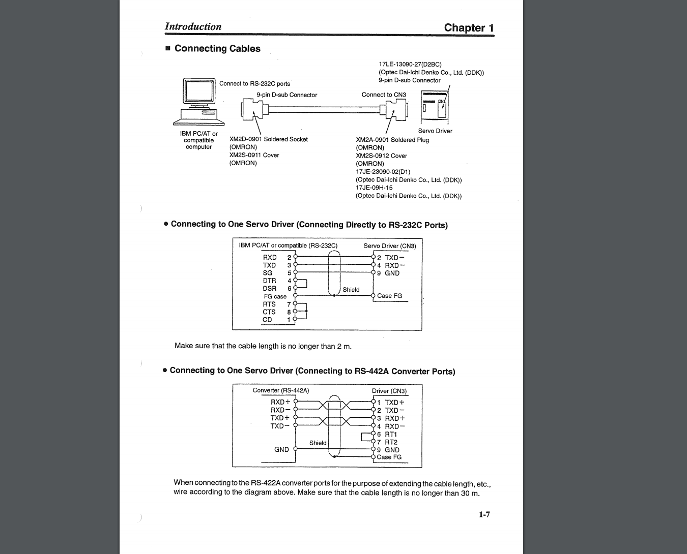

    I do have a PC with a RS-232 port and have tried connecting with that, but I didn't check any of the settings. I'll check the cable too.
    you will have to make sure the baud rate is the same at both ends also start and stop bits are correct, the handshaking might be xon/xoff (ie software handshaking). You might also have to swap pins 2 and 3 over at one end this depends if the Pc is setup as DTE or DCE. one good thing about the com port is that it is hard to break

    Thanks Clive, I'll take a look at all the things Boyan mentioned. I'll check the PC DTE or DCE settings - I'll buy a cable that I can alter the connections on.
    you need to keep on eliminating reasons and i can tell you straight away that i would never use USB-RS232 converter for connecting to servos, or anything. . You need a normal. PC with a normal PCI port and an adapter there. Or even better, a PC with a com port that you could control from bios.

    That above is from your servo drive manual. If baud rate is not set at Com port same same, communication will NOT ever happen
    And most of all check that manual https://www.fa.omron.com.cn/data_pdf...8d-u.pdf?id=68 for the proper connection to the drives from the PC side . Check your cabling if is right.
    So in other words from page 1-7 seems you need Null Modem Cable https://www.decisivetactics.com/supp...h-serial-cable
    Attachment 22409
    Looking at that drawing and the info you've sent on null modem cables, it's not a straight RS232 cross-over as it's computer pin 2 to driver pin 2 and computer 3 to driver 4. I'll have to make a cable.
    Will post and let you know how I get on - thanks again.

    OK, got the software to talk to the driver thanks to your diagram Boyan - many thanks. USB-RS232 working well - software thinks it's 422, but I'm not splitting hairs.
    Do you have a source for the manual? - it's not the same as the two I already have and may contain more detail. The manuals I have don't show pin numbers for the CN3 port for instance.
