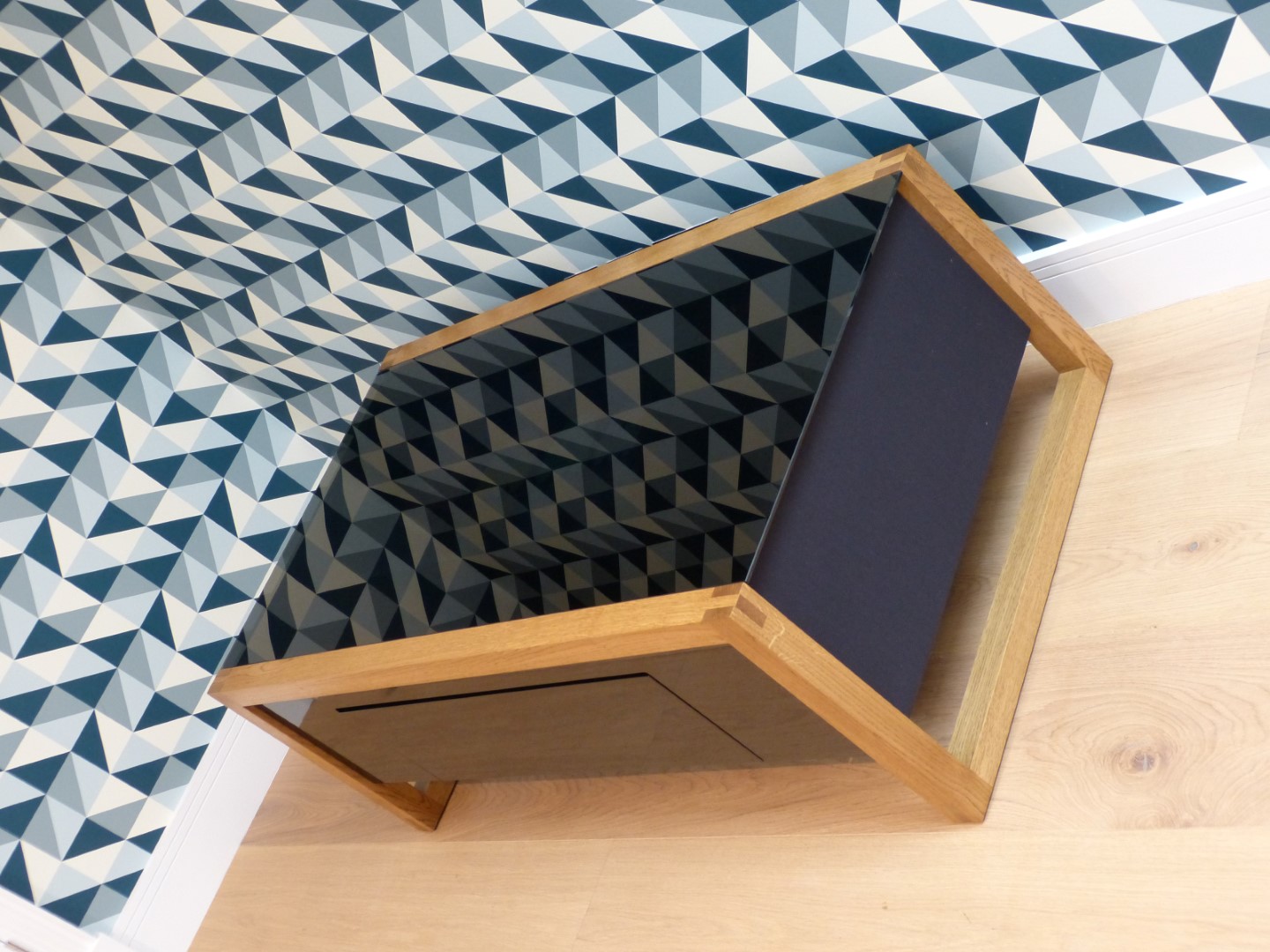

    Hi building an arcade coffee table for mates Bday and his GF asked if I could make it in this style

    How do I make the corner joints on the wooden frame, can this be done with a cnc router? Or i there a simple way to do this without a router? The wood will be either Oak or wallnut.
    Would I be better trying to make dovetail joints? These joints are quite chucky I don't think my router bit set will handle them.

    Yo,
    They are just mortise and tenon joints but done on the end of the mortise piece, that type is know as an "open through tenon and mortise joint".
    There are so many ways you can make them, its going come down to what tools you've got. The Tenon being the easy bit.
    Your getting towards fine wood working with stuff like this, YouTube?

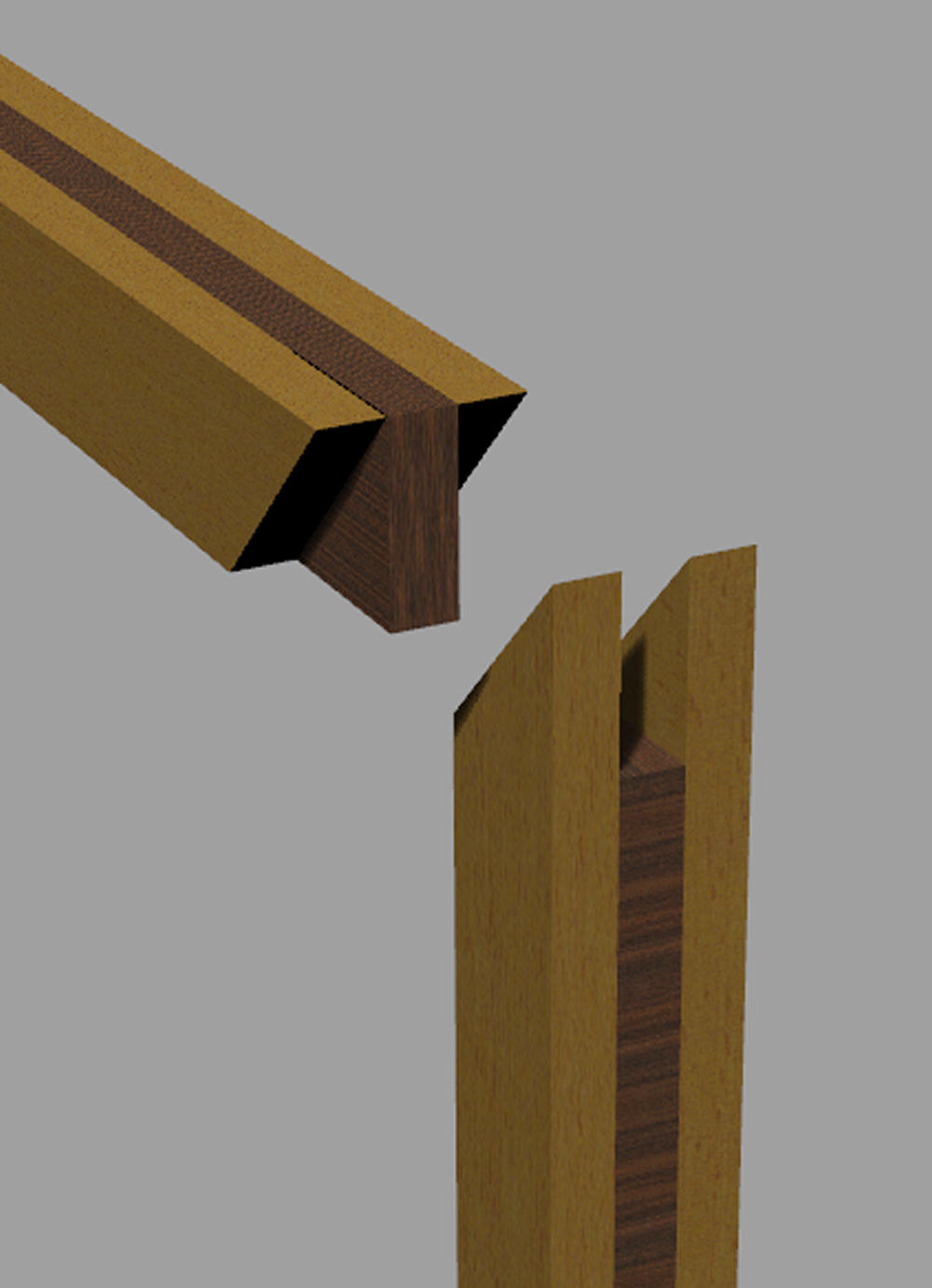

    Taking into account what you said, maybe this idea would be easier. Laminate three pieces for each part, I've coloured the wood differently so you can see the laminations easier. You could leave the ends square or mitre the outside ones like the example. Use Titebond Original glue. Provided the pieces are all planed to the same thickness you should have a perfect fitting joint.
    The one in your picture is called a "corner bridle joint".
    The one in my picture is a "mitred corner bridle joint".
