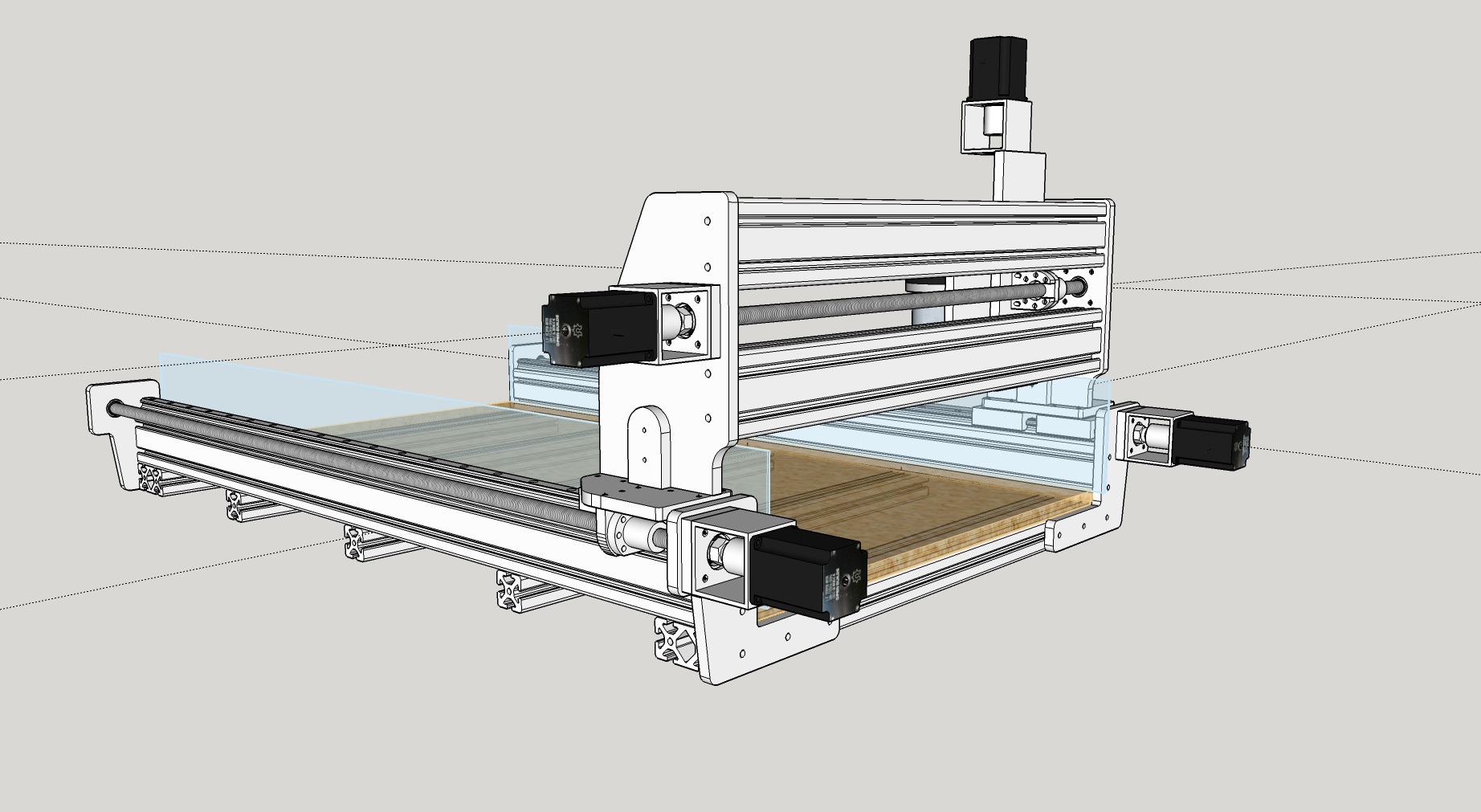

    Byuilding my second DIY router. This one is a fairly serious bit of kit compared to my first openbuilds OX.
    I would be very grateful for a bit of advice on purchasing the electronics for my new machine, before I take the plunge.
    I have already purchased a Huanyang VFD and 2.2kw spindle from Solar Jean. Fingers crossed it works.

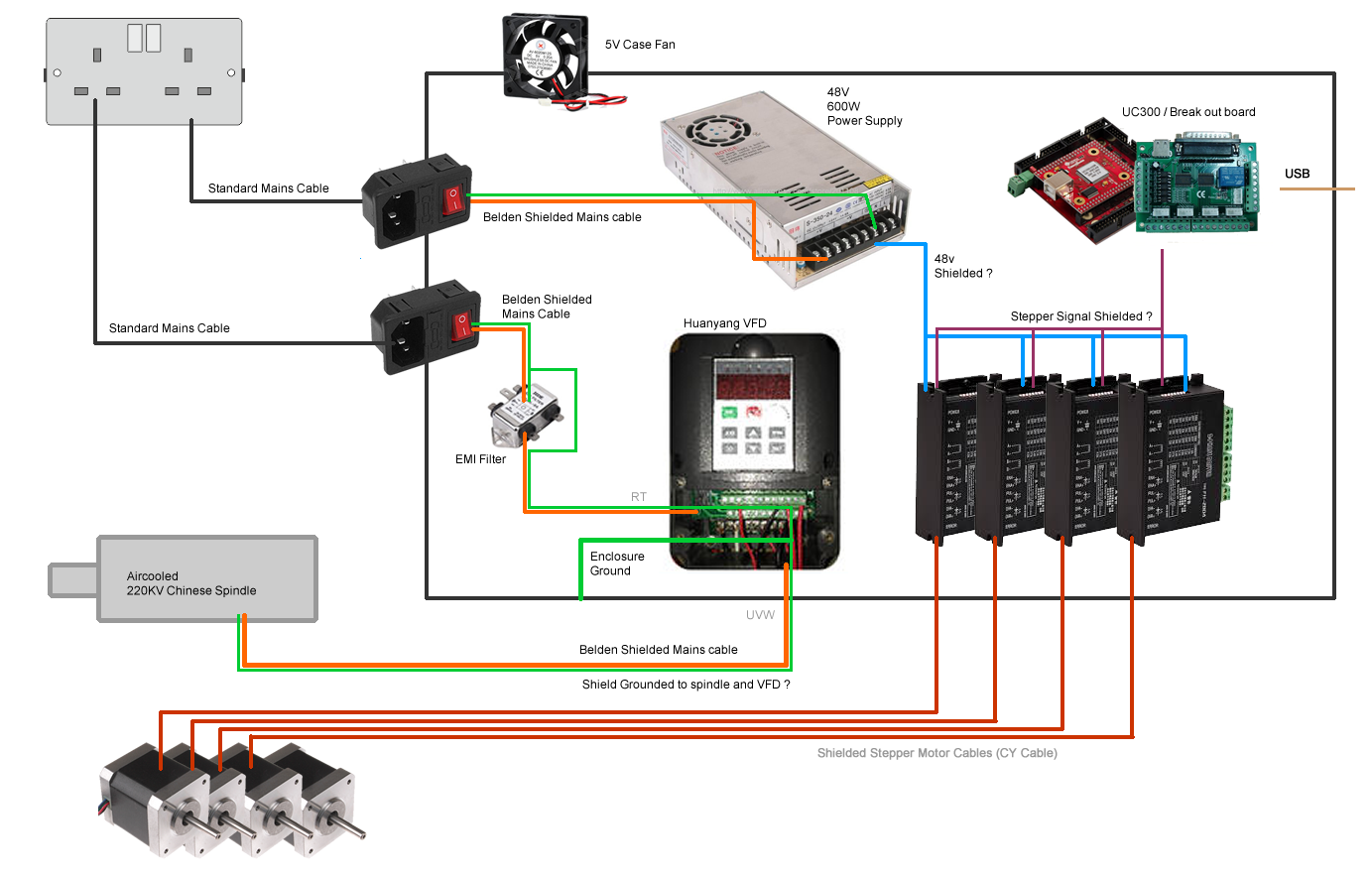

    Q1. On my previous machine I used a UC100 motion controller attached to a HG08 breakout board from CNC4YOU in the UK.
    Do you think there is a better set-up than this within a sensible budget?
    If I went down the ethernet route - maybe ESS? (which I have heard is more reliable than USB) can you connect the machine to your network, or directly to the pc only?.
    There is only 1 ethernet connection on my PC and i need it for the internet.
    Q2. I am planning to mount all the electronics including the VFD in a single enclosure. Do you think i will have noise issues ?
    I will be using shielded cables all round.
    Q3. It would be nice to have one single power input into this enclosure to power the 36v transformer for the steppers and the VFD. Any issues ? RFI Filter ?
    Q4. I am confused about connecting Mach3 to the VFD. Is it even worth it ?. Are there any benefits ?
    I see that a UC300 has some kind of PWM spindle control option on it, but got no idea how to connect this to the VFD and i can't find any wiring diagrams on the net.
    Q5. I have read that it is possible to break the Huanyang VFD / Spindle if i do not set-up the VFD correctly to start with.
    Can anyone confirm that this is true, and point me in the correct direction to get the settings right before I start ?
    Thanks for any help on all of this.

    Q1 Yes Ethernet is much more reliable than USB and Yes while it's possible to connect thru a hub it's not recommended so the honest answer YES but Don't.
    Are there better options than the Uc100 then yes but they will cost more money. My personal Pref comes from Cslabs but not cheap so the next best would be ESS connected to a Good BOB like PMDX126.
    After that then you have Pokeys 57Cnc which is an excellent little board packed with features for not a lot of money. Again needs connecting to a good BOB.
    The BOB is critical to a stable machine.
    Q2 Yes it's possible provided you have correct grounding and cables. Also Good idea to run the VFD on it's own supply and fit RFI filter.
    Q3 No issues and RFi filter is nice but not required in many cases, thou it would be a good idea to fit one because of the VFD esp if sharing same mains line.
    Q4 Yes it's worth it and not difficult. Two ways to go about it. You can either just have Mach turn spindle ON/OFF which is most usefull. Or ON/OFF plus control the speed which is nice to have but not has useful as ON/OFF and depends on the Jobs your doing to how useful.
    Q5 Yes it's possible but not easy and you'd have be messing around with settings you really shouldn't be if don't know what your doing.
    Setting up is easy enough and just involves setting a Few parameters, takes 2mins. You'll find all you need here in this thread.
    http://www.mycncuk.com/threads/5814-...ce-More/page14
    One last thing you mention running the motors with 36V.? For a good router you'll want more than 36v to give you speed. I wouldn't run a router much under 50v with 65-70Vdc being normal with 3nm motors. Obviously you'll need drives to match.!

    With the RFI Filter would you fit that inside the case before taking mains power to both the transformer and the VFD? Also I read something in the manual about not putting a switch in between the mains and the VFD. Couldn't really understand that.
    As far as spindle speed goes. I have guessed up to now with my old machine to be honest. Based on the sound of the cut I have sped up or slowed down my router until it sounds happiest. I'm sure you will laugh. It would be nice to be able to control that via the software.
    So would 50V be enough?

    Techinicly you don't need a Bob but you will need some form of connection board. While I've been testing 57C I used one of these IDC type terminal blocks.
    http://www.ebay.co.uk/itm/IDC-Male-H...-/151166076305
    Like I say Not a good idea to Run any Cnc machine over a network. Use it to send to pull and send files but I wouldn't run it over one. It will work but not something I'd trust.
    Quote Originally Posted by mturneruk View Post
    It means No Switch between VFD and Spindle. You can switch the VFD mains power but it's not recommended for anything but Emergency conditions. So basicly no Stop starting by Switching VFD ON/OFF only when you HIt the Oh SHITE button should it be switched.!!

    Thanks Neil. I can solder and crimp!
    Is there any kind of numpties wiring diagram for making one of these?
    Thinking I may also need 12V in my control box for the motion controller. Would the PSU your talking about making be able to supply that as well. Or would I need a separate supply for that?
    I have seen circuit breakers in other peoples boxes. Is the breaker in my consumer unit not sufficient?
    I would also be running my kit on a normal 13Amp house ring. Does that still work?
    Sorry to be a complete newb.
