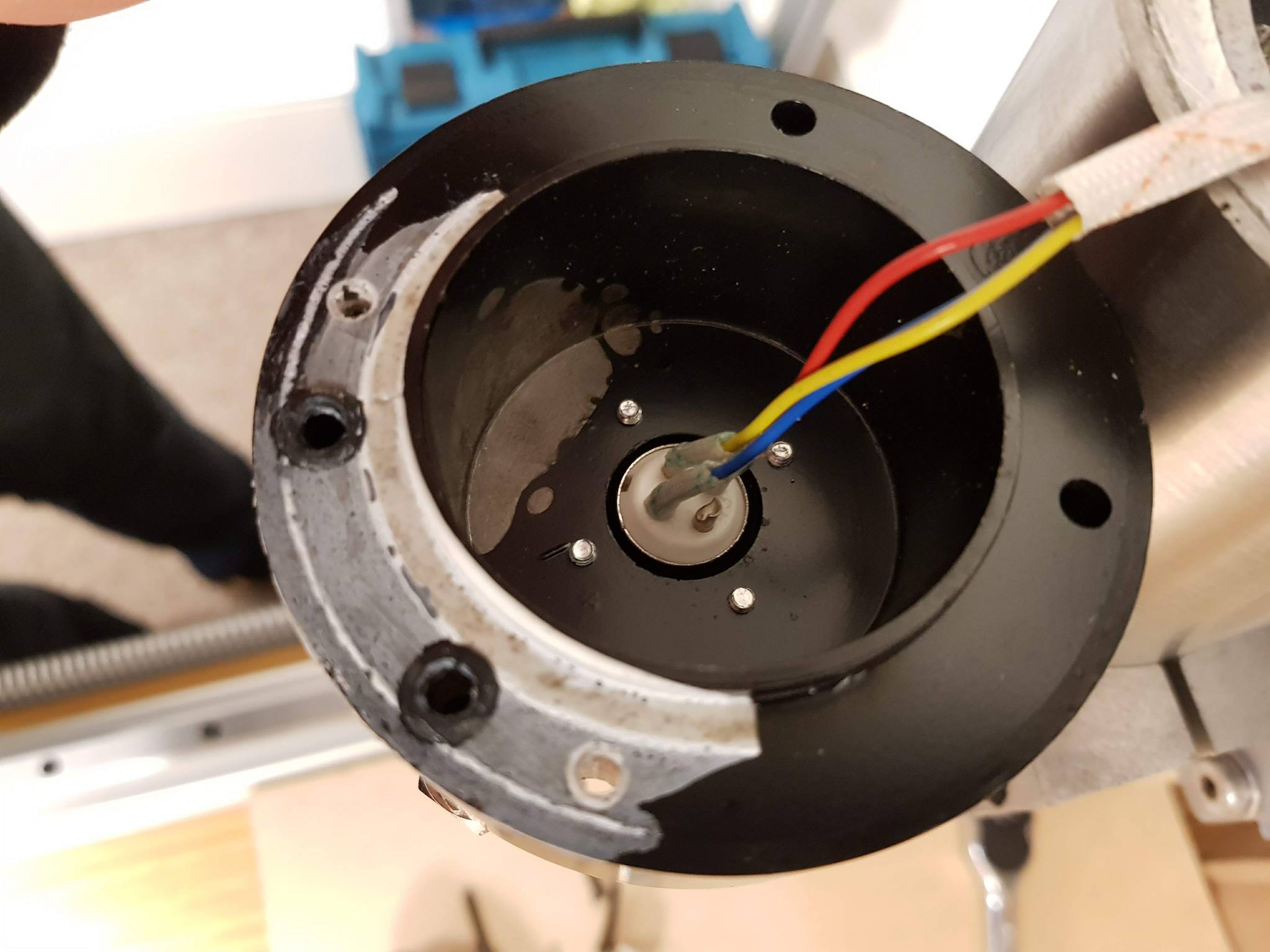

    I started looking today about how i need to properly Ground the Spindle at the VFD side, whilst looking for information i came accross a forum post on CNCZone that said many of the Chinese spindles do not have their Ground pins connected to anything inside the Spindle, so i decided to take the top off and have a look - and not much of a surprise as the Ground pin was not connected to anything. Where can i connect this to? Should i just drill and tap a hole so that a connector can be screwed to the casing and soldered the correct pin?
    I just changed one of the socket hold down bolt to one a bit longer and put a connector on that with a nut.
    Make sure you clean the water holes and put a little silicone around them to make a good seal when you put the top back on.
    So simple - yet so brilliant ;) :D Thanks i will do that.
    Thanks for the silicone tip i will pop out and grab some tomorrow.
