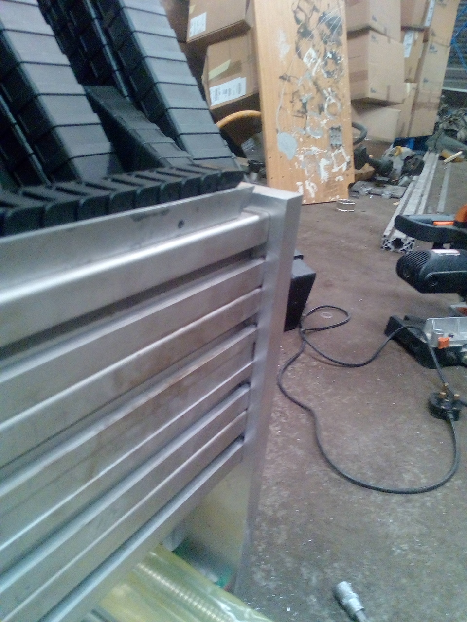

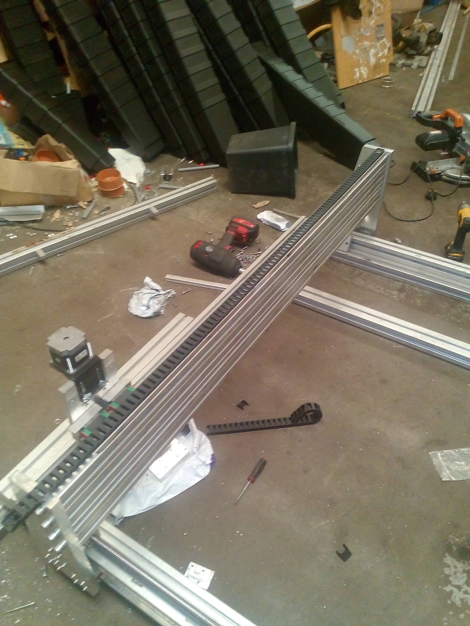

    Hi I was convinced they were M10's (You maybe got that from me) so holes I had drilled were too small in the end I widened them myself. I never tapped the ends I used M12 bolts and drove them in using an impact driver and stainless steel A2 socket caps was still hard work with the impact driver lol but only took 15 minutes just heavy on the hands.
    I used the T nut 90° corners to assemble at right angles the frame before I drove the bolts in then undid the corners and moved on to the next piece to try and keep everything as straight as possible. This was especially important on the bed frame which wants to twist when you drive the bolts in.
    I recessed the gantry into the aluminium which removed any twist when I drove those bolts, when I tightened the gantry mounts to the Hiwin carriages the gantry sat it fine without any bolts perfect fit this really made it a lot easier. In fact if you don't recess I doubt you could do it the way I did. I have a 5mm recess either side in 20mm tooling plate.
    I think it turned out ok

    It could be done with a bar and a lever (I did a few like this) but it's very hard work. You could also drill the internal out with an the correct sized drill bit (Guessing 10.5mm or 11mm) then it'll be easier to tap.
    In retrospect I should have had KJN tap it.

  6. #46

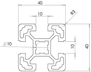

    Hi Desertboy, your machine looks good, nice progress! I can now see why you did not tap the ends of the extrusion - what a f*cking nightmare! Fortunately KJN sent me two lengths of the incorrect extrusion that i quickly had a practice on, so the middle of the Extrusion is indeed a hole that is the correct size to tap an M12 thread in, HOWEVER as the diagram below, because the circle is within a square it makes it impossible to tap, once the thread has been cut into the circle material, it slips out and into the the 4 empty corners.
    I think i will do the same as you and drive the bolt in to get the thread... I'm worried now that there isn't enough meat there to provide a strong connection.

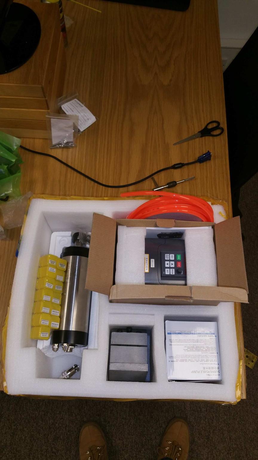

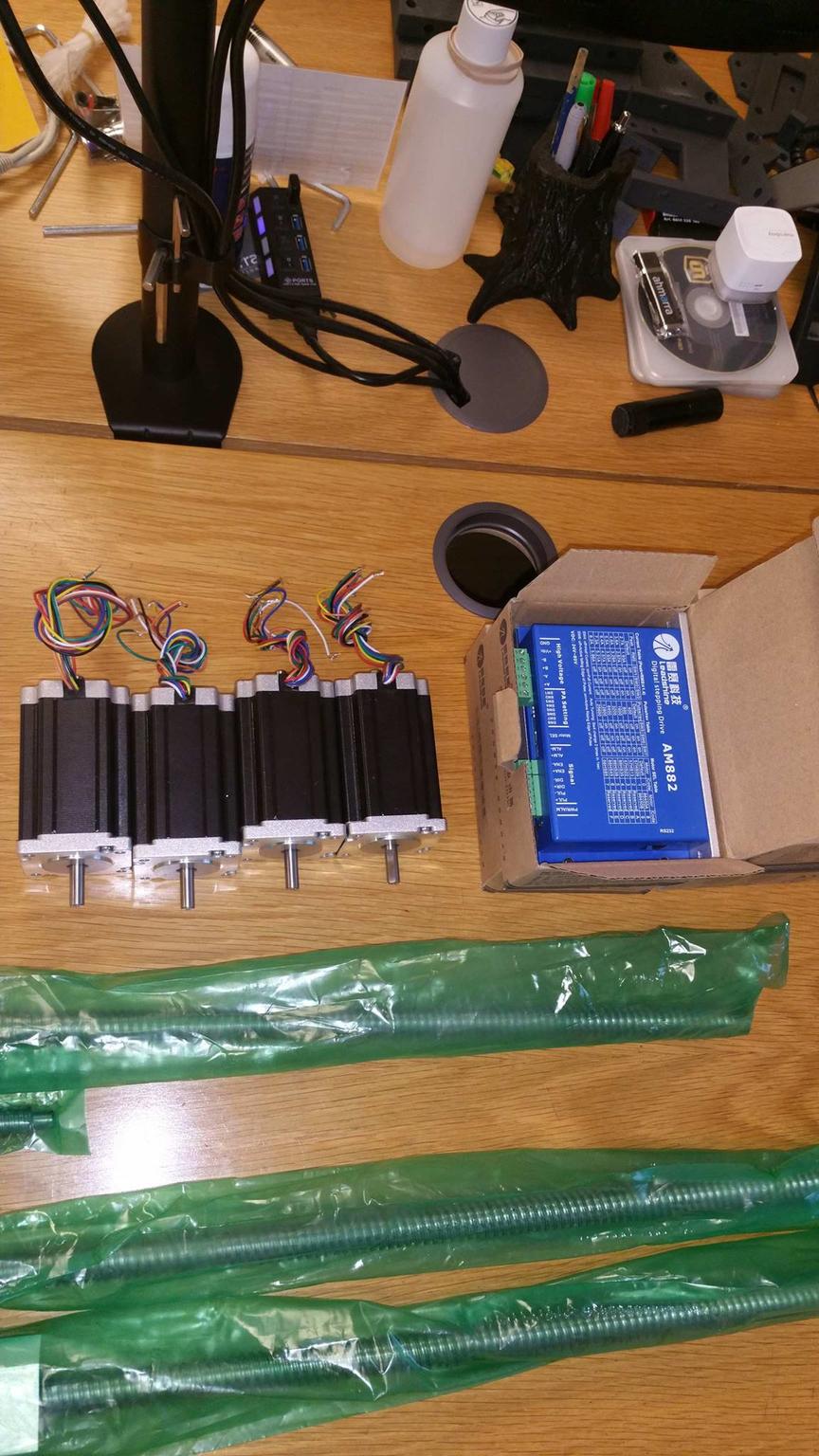

    In other news, my spindle kit, steppers, stepper drivers arrived. Just waiting on the PSU's, controller and some other little bits before i start mocking the machine up.

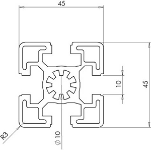

    My profiles look different on the internal core.
    Both my 4545 and 9045 have the same internal core
    http://www.aluminium-profile.co.uk/a...20.html#SID=29
    http://www.aluminium-profile.co.uk/a...KJN990300.html
    e2a, Ah I see you have 4040 extrusion
