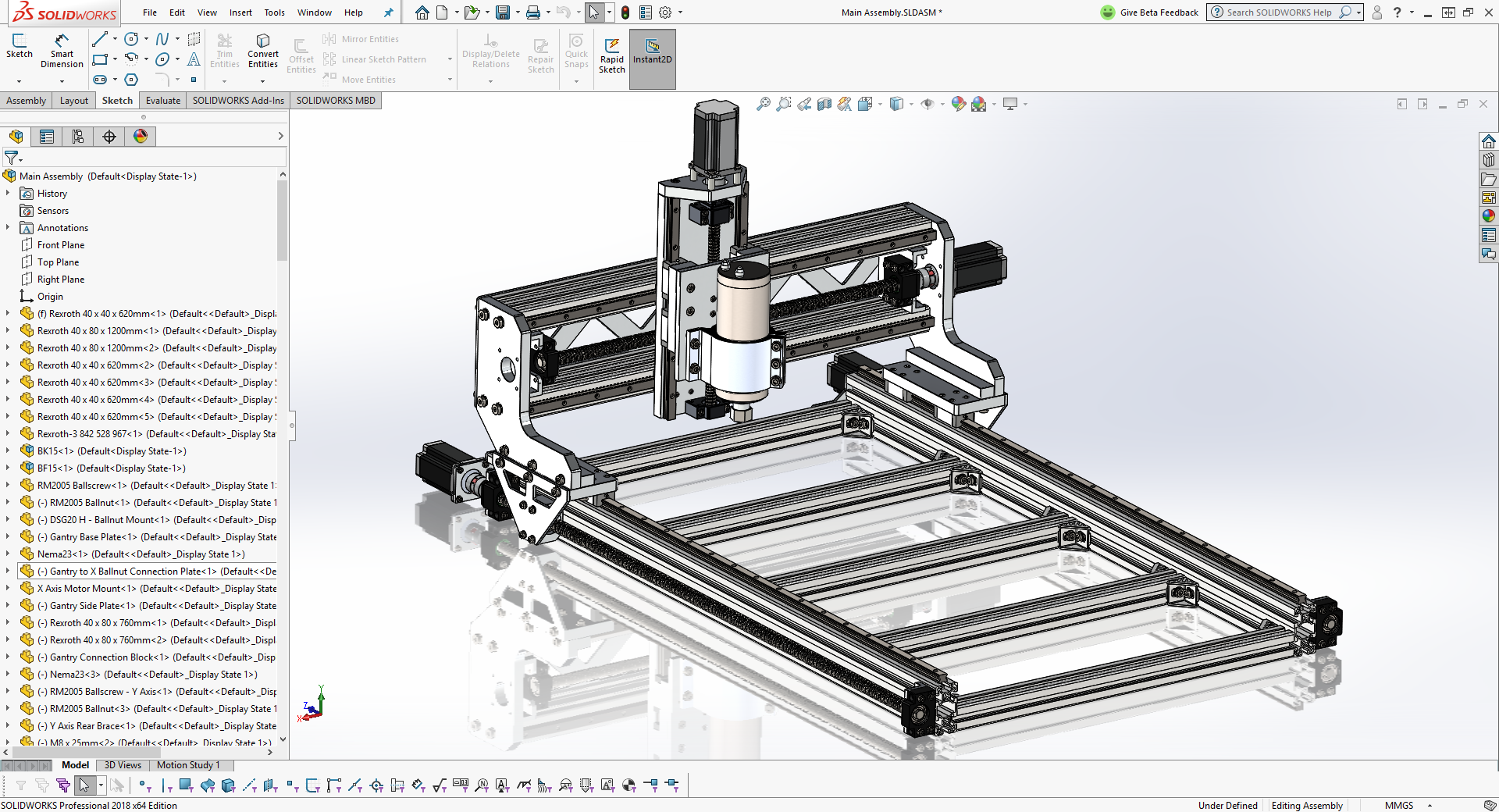

    Just signed up this forum, i am currently designing a small (Large Desktop?) sized CNC Router for our business, it will primarily be used to machine 1mm Intumescent Fire Sheet, but also for producing one off parts for some of our older machines (Aluminium, Steel etc?). We have two much larger CMS Routers already that we use for production of which i create C Based programs for. I have a pretty sophisticated knowledge of building 3D Printers but this will be my first router, i had found this design online and really like how robust it looked:
    https://jeremyyoungdesign.com/2016/0...inal-assembly/
    So the design is heavily based on that machine.
    So far it is looking to be built from the following:
    Frame - Genuine Rexroth Extrusions & Connectors.
    Gantry - 18mm Aluminium - Bespoke Plates, Would need to have these made (Pricey?!).
    Low Profile L1016 Linear Rails & Carriages from Automotion Components - On all Axis
    4NM Nema 23's on All Axis ( This Kit: https://www.cnc4you.co.uk/CNC-Kits/S...-4-Axis-Nema23 )
    Dual RM2010 Ballscrews on X Axis
    Single RM2010 Ballscrew on Y Axis
    Single RM1605 Ballscrew on Z Axis
    Appropriate Fixed & Floating Blocks on each Axis.
    Ebay / Chinese 2.2kw Water Cooled Spindle
    So that is the rough spec of the machine currently, the main things i am concerned about so far are:
    - Controllers - The motor & driver kit comes with a parralell breakout board, however i want the machine to be compatible with newer Laptops (Windows 10 x64), when building 3D Printers i tend to use Clone Smoothieboards, would these also be suitable for this CNC Build? They perform well and are cost effective, also have stepper signal breakouts.
    - Endstops - Mechanical endstops are common practise on 3D printers, i see many Router builds done using proximity sensors or hall effect sensors, are any recommended for maximum repeat-ability?
    - Resolution - Will the 10mm pitch and 5mm pitch provide me with a balanced resolution / speed combination, i was advised previously that 2005 screws on the X & Y might hold back achievable speeds - or that i might be disappointed with the feed rates they would achieve.
    - The build this is based on uses Aluminium for the majority of the Gantry and Z Axis plates, would steel also be acceptable? I was worried about making he gantry too heavy.
    - I was considering buying the ballscrews from china, if they arrived with runout evident, could they be straightened, or might they straighten out once fixed in position?
    - Might anyone recommend a company / individual who cold produce the bespoke plates.
    Any help / criticism / heads up on missed items would be greatly appreciated.

    Welcome to the forum Alex.
    Some comments: Kits of parts are never a good idea, I hope you have not purchased them yet.
    Nema 23 4nm are overkill I would use and have done several times nema 23 3.1nm from the same source now then that kit is using a 36v power supply you really need about 68v to get the best out of the motors so build your own (look up Joe's excellent vid https://www.youtube.com/watch?v=WISDqx-e23M ) go for AM882 drives from China as they have stall detection etc (you will need that if you are putting two motors on one axis)
    Linear rails and ball screws can be got from Fred at BST [email protected] China very reliable guy.
    Just email him for a quote and mention the forum. You may need to have the F length on the screw to be altered from standard 15mm say to 30mm to fit the pulleys Your screws are fine for what you want to cut.
    Spindle again China be careful with the vfd as there are two types that look the same to the untrained eye. So post a link here before you buy.
    proximity sensors are good and cheap about £3.50 china or ebay
    Finally keep all your questions in one place then people can see what you are doing and chime in
    Good luck with the build
    Edit go for 20mm rails all round 15mm are fine but much harder to deal with.
    Edit Just noticed the screws 20mm!! I would use 16mm all round but it depends on the length.

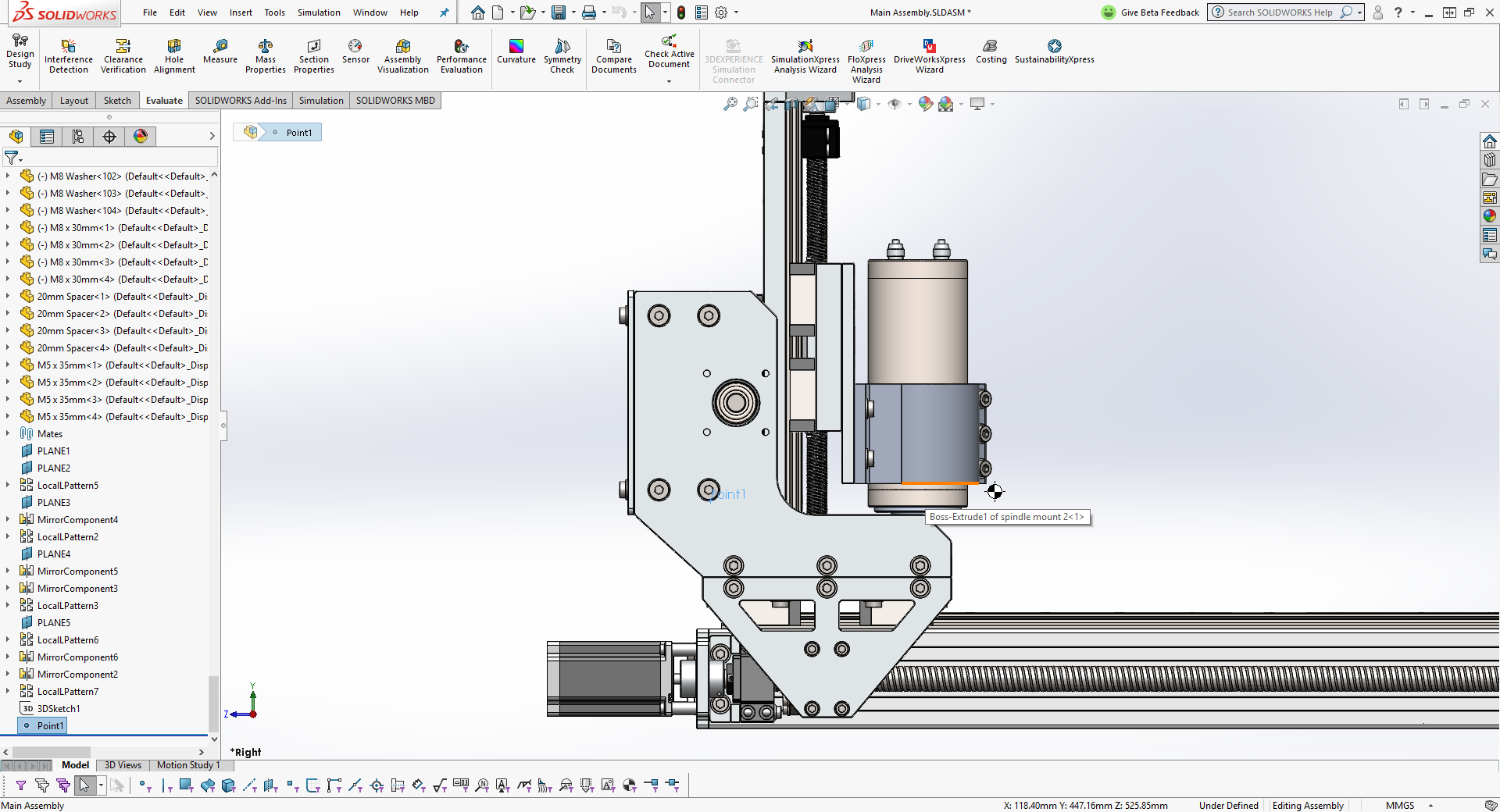

    Welcome Alex! I'd personally be rather worried about how the weight from the gantry is being applied to the X-axis bearing blocks at such an angle. I'm not sure if anyone else would share the same worry but It's certainly a great design! Now as someone who recently within the past two months purchased ball screws from china there is two things you need to know customs will sting you for import tax and the quality of the screws is fairly decent (20mm screws 5mm pitch).

    I'm not sure I understand what angle you refere to... If it's about the gantry weight distribution to the X axis glides assemblies, the answer is at a few SW clicks distance. Make sure you have set the actual material/ mass of the components then look at the center of gravity. It should be close to the center of the X axis bearing blocks assembly in the vertical plane perpendicular to the X axis.
    Yes i was referring to how far out from the blocks the weight is being applied.
    Ok, so the Axis is orientated as is to try and get the maximum workable area within that size of frame, i could have made it more central "looking" but in reality its not really central because on one end of the axis the spindle can reach past the machine, and on the other end you have a few hundred mm of area that you cannot reach, this is why i have tried to balance it and make the most of the space available. I'm nt sure of the weight of the spindle but this is obviously very important in order for Solidworks to calculate the centre of mass, i had read online that in general a 2.2Kw spindle will weigh in the region of 5Kg. So i set that as the mass of the spindle and run the evaluation, and it came out pretty well imo, more than acceptable to me, the linear rails and carriages im using are supposed to be high quality so im hoping that they will be fine:
    EDIT: Just realised that picture isn't so great, the Centre of Mass appears to be just in front of the left side carriage block, and it also shows a slight angular (right word?) pull, twisting towards the rear of the X Axis. Possibly i could move the right carriage block towards the middle some? This would seriously hurt my OCD of having them space equally.
    Thanks Again for all the replies i've already learnt alot so keep that criticism coming :D

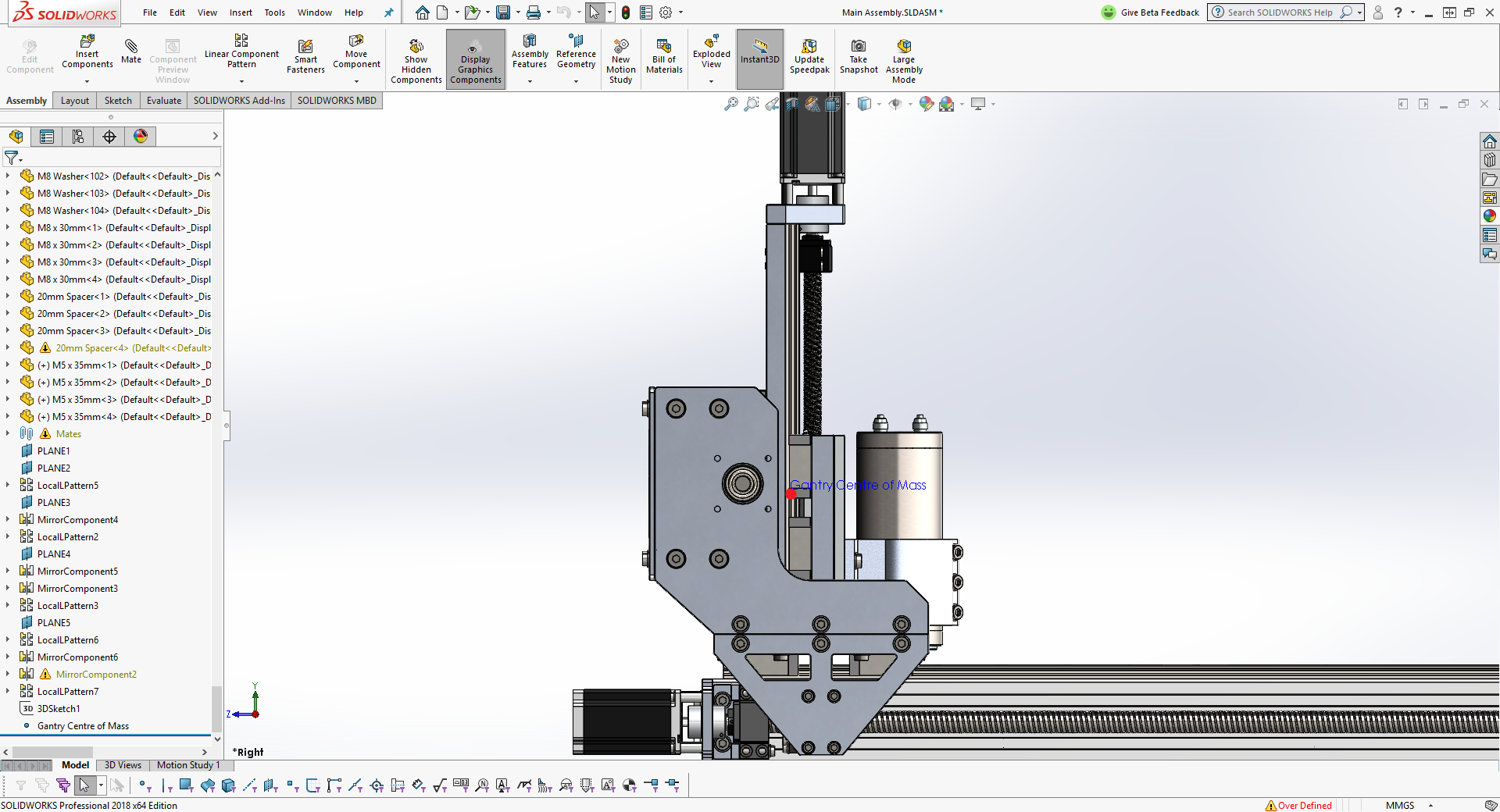

    Unconvinced with my result from the Centre of Mass evaluation i done, i got on the phone to Solidsolutions, who provide our solidworks license and also provide support, indeed i had done it incorrectly. Here is where the actual centre of mass is on the gantry. It's hard to see, but where it says "Point 1".
    Not sure how much of a problem this poses, are the carriages likely to be affected by this? Not how i might remedy this other than reducing the Gantry to a single 40x40 extrusion as opposed to 40x80 and then centralising over the Gantry Base Plates further. This in turn might affect how rigid the gantry is surely?
    Alex
