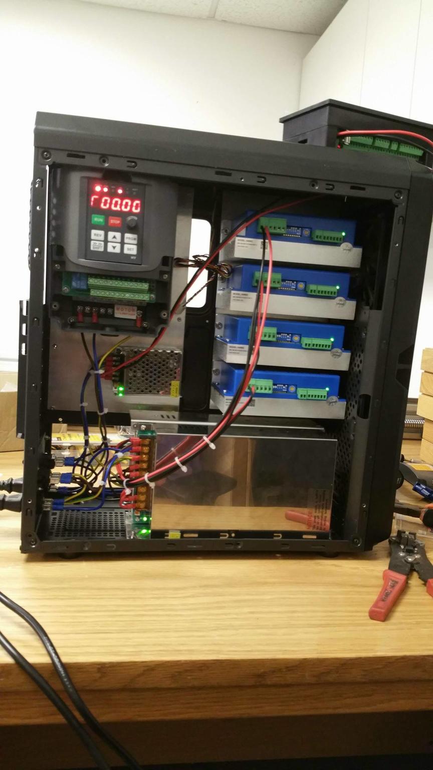

    Thanks for the replies guys, think i've got my head wrapped around it now, would it be bad practise to splice & solder the wires then heatshrink it all up afterwards?
    Alex
    Alex
    That's the way I always do it. Use screened 4 core and ground the screen to the star point in the control box.
    Thanks Clive, this is what i will also be doing then.

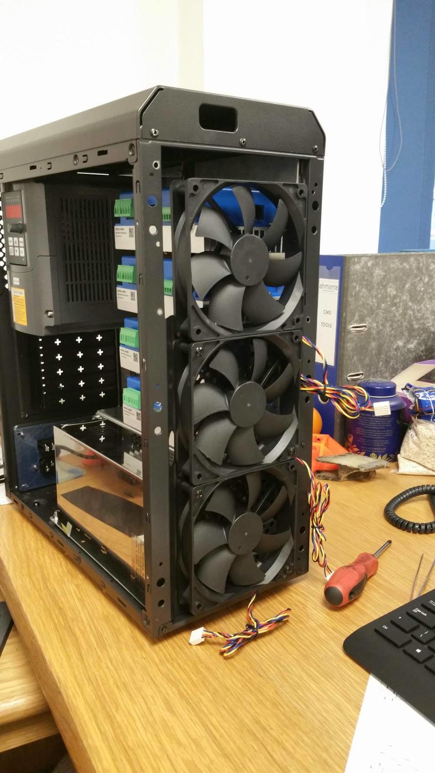

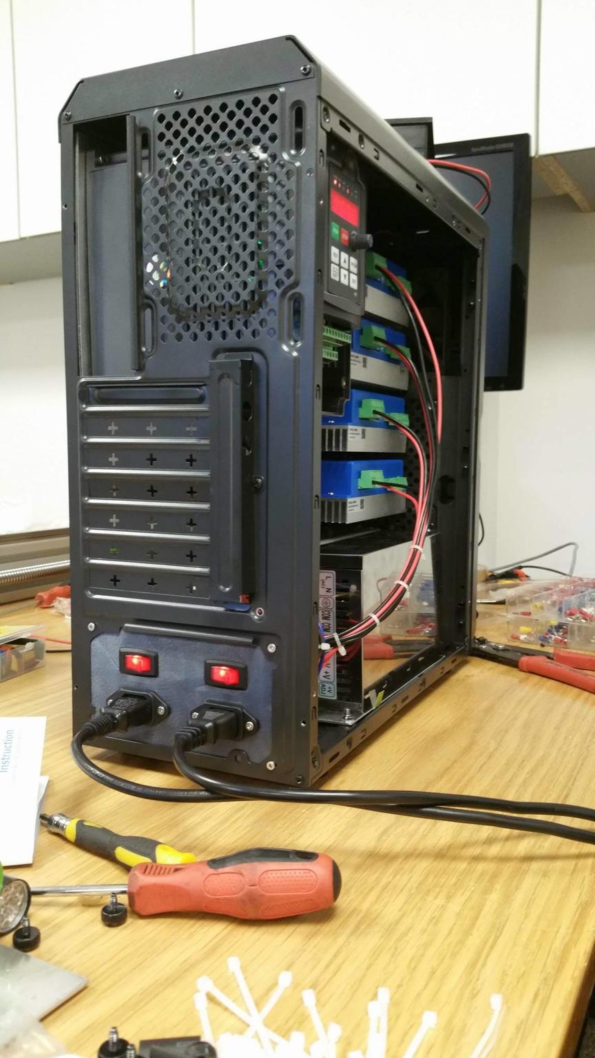

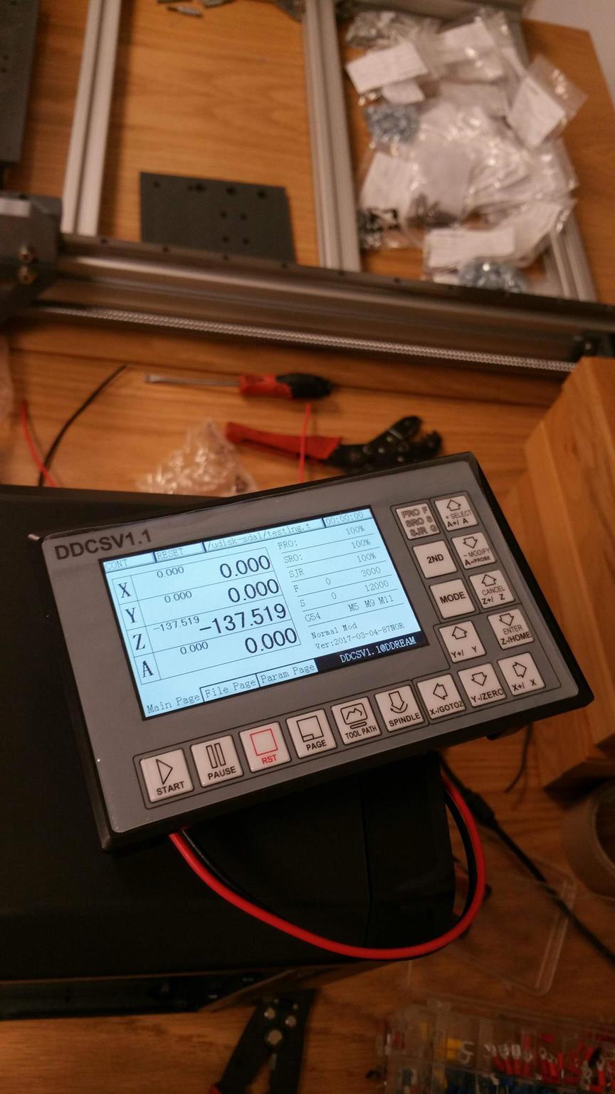

    Done some more on the electronics whilst i wait for some bolts to come, also need to machine some mock up parts tomorrow to finish the dry assembling, then hopefully should get some movement early next week. Was confused as hell earlier trying to figure out wiring the VFD using single phase, actually it was simplest thing ever!
    Need to decide if i want to mount the controller on top of the PC Case using some kind of Arm / Swivel attachment, then fix the PC Case to the Bench the machine will be sat on, or have the Controller as a portable unit. Not sure the machine is big enough to warrant a portable one.

    Alex I would be putting some insulation over the mains terminals in the box before it bites you.
  7. #77
    Yeah i got a load of Heatshrinking to do, just wanted to make sure everything was functional before i made it pretty & safe :D
